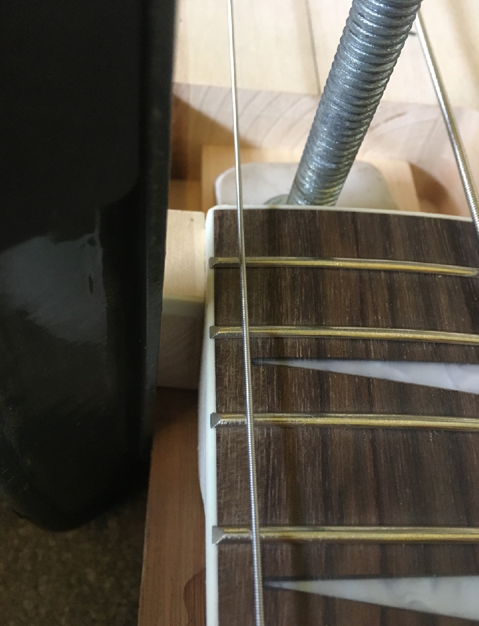

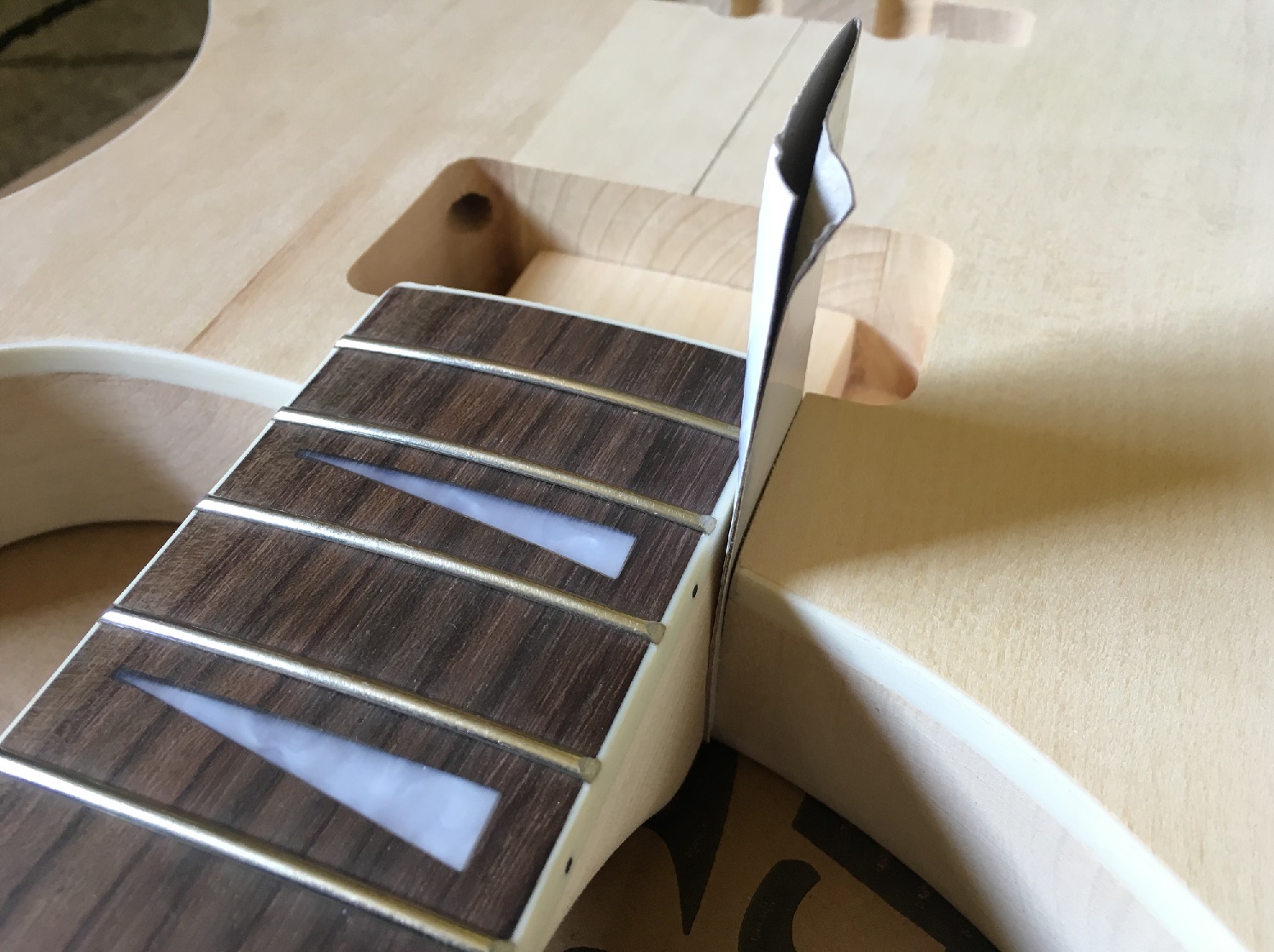

    I'm pretty sure the first thing I should do is the neck and bridge positioning, so I have drawn a centreline and found the scale length to position the bridge, but the neck has quite a bit of slop in the joint. This can be remedied by a folded piece of cardboard, but not sure what I should do.

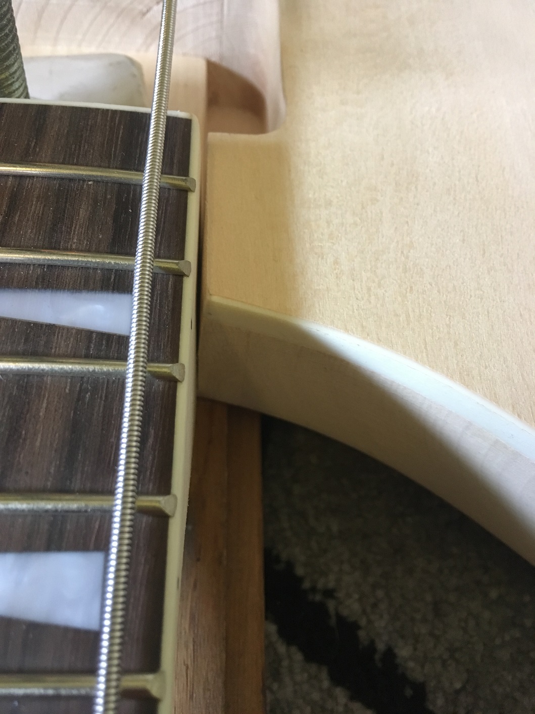

    Here are some more pictures of each side of the joint.

    Hi CS and welcome to the show!
    Its a common issue for bolt ons and set necks. You've done the tough bit by aligning your neck to the body.
    From the photos it looks like there is only a gap on the top side of the neck, and it appears to taper out into the bottom of the pocket? Is that correct?
    What i'd do is see in you can get some plain maple or light coloured veneer and layer that into the pocket sides to take up that gap. You then adjust your shim with sand paper until you get a good snug neck fit all the way up that top side of the pocket.
    How is your scale length with the neck in that position? On some of these kits the neck actually needs to go out a bit to get the scale length right as well, and that may have an influence on that gap.

    Thank you!
    Yes, the gap seems to only be on the top as you described, and the strings line up ok when butted up against the bottom.
    There aren't any holes for the bridge, I just clamped it down like the neck to put the strings on, so I don't think I will have to move the neck out as I can just move the bridge.
    The join does get tighter as I move the neck out, but I have to move it pretty much all the way out.
