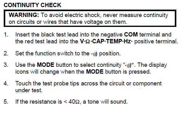

    McCreed, according to my DMM manual a continuity test can be performed, see first attachment. It cannot perform inductance tests but the 4070L advertises it does per the second attachment (note that it tests for H not L.) I agree that an oscilloscope and signal generator are optimum -- but out of the question for me really.
    Maybe the 4070L DMM does not give a fully accurate reading or like you say, won't achieve appropriate signal frequency. To be honest, I doubt I would get that advanced in my testing. I guess I'm looking for simple tests that I can perform to avoid problems before I install the electronics and also a means to learn more about guitar electronics theory.
