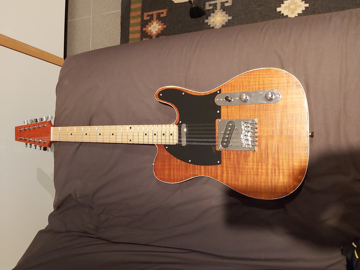

    Made a lot of progress over the past couple of weeks. Used a stain again (maple) and found the electrics on this one fairly simple with only the two pots. Had more success with this one compared to the Tele I built some years ago (I was less experienced!!). I wish Pit Bull would stop including their hopeless strings though I did use them just to get a handle on stringing a 12er. Just put some D-Addario's on today and it sounds sweet. Included a pic of the finished article. Thanks to those guys who answered my query about the octaves.Click image for larger version.
