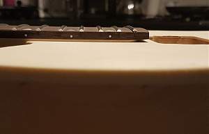

    Hi Guys,
    Some images to show progress:
    Headstock Carve:
    Neck height adjustment:

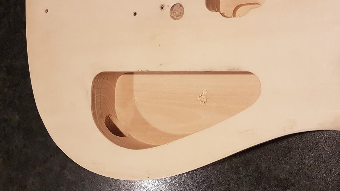

    Switch cavity route:

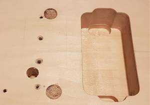

    Deeper pickup route, dowelled holes from TOM bridge:

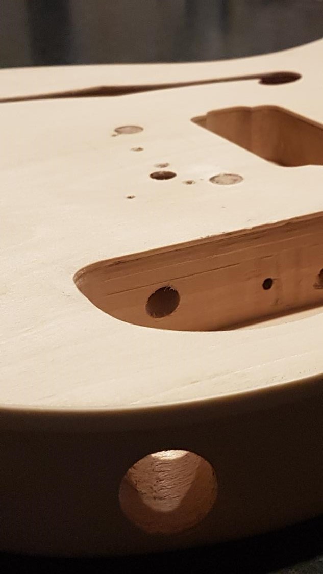

    New hole for ground wire to bridge (drilled via the jack cavity):
    Doing a really tidy job there Shambrick, looking good!
