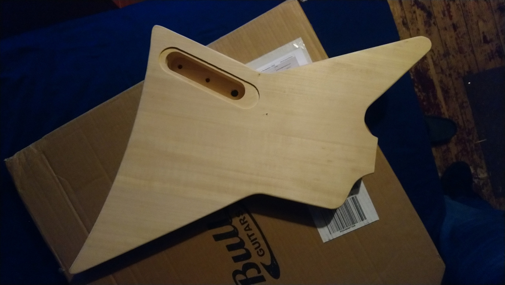

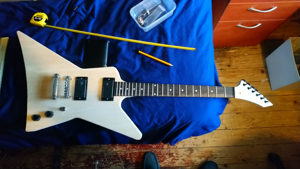

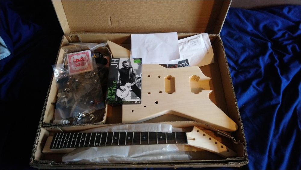

    Hullo,
    My Kit arrived last week and so far i've done a mock build, everything seems to fit fine and the neck seems to sit nicely. I've measured the scale length and checked that the strings sit where they're meant to. There's a few scuffs and one chip on the back by the neck recess but nothing that will stop play,
    I was planning on staining but after seeing how tight the grain is I think i'm going to paint it instead (I avoided a nicer grain wood as i didn't want it too heavy). I'll need to do some research on how to go about that as all of my prep plans centred on staining.
    Today the plan is to drill some extra control holes and route out some space to fit the extra pots for the new pickups, then if i gain enough momentum i'll start some sanding.
    I'll try and keep up to date with photos on here.

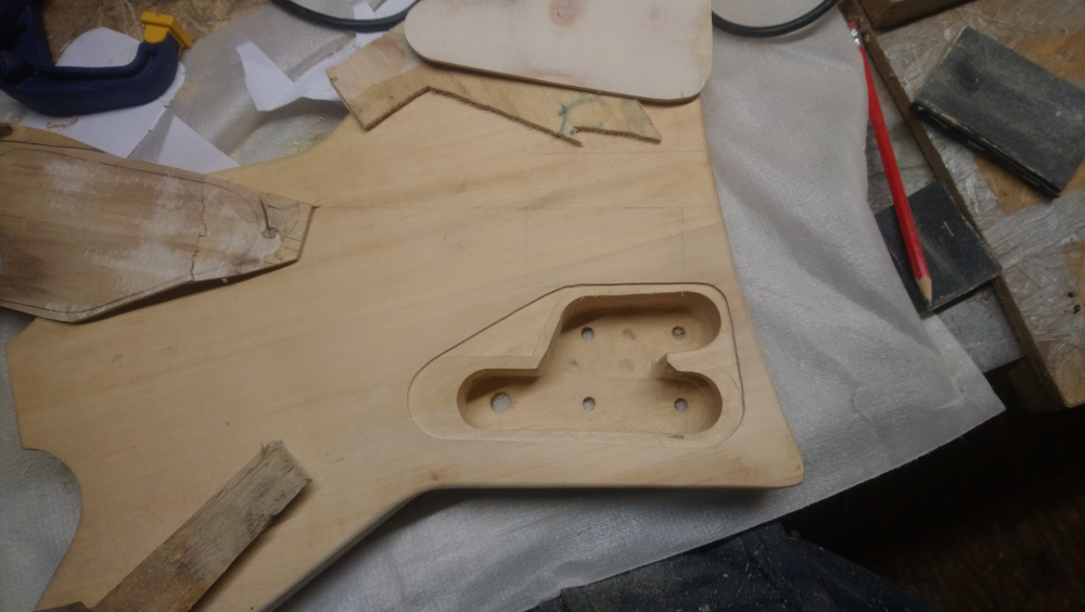

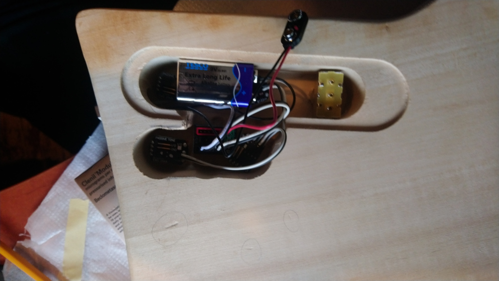

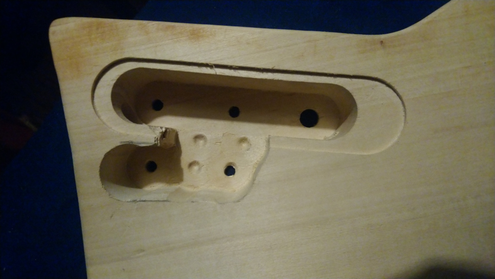

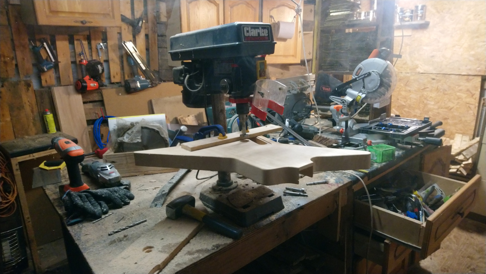

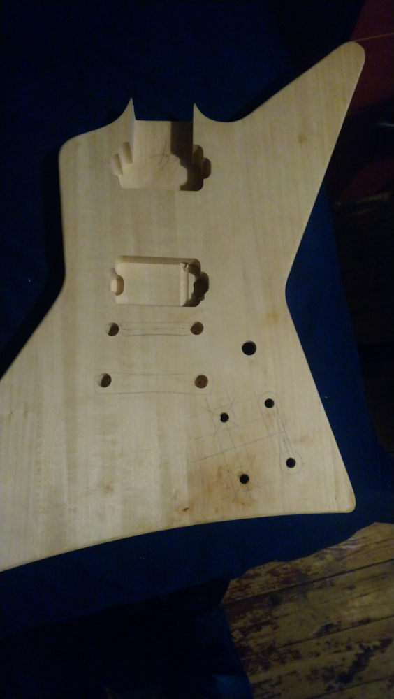

    Yesterday i found a bit of traction and decided to cut the holes for the new pots, I know it's very messy but it's the first time i've worked with wood in about 15 years so i'm very pleased w/ it so far. Today i'm going to clean up the pocket a little and see if i can cut a back plate out of some ply i've got (I thought wood would look nicer than plastic). I thought i'd need to cut an extra slot for the battery but it all fits inside, i'm going to just velcro the battery in place to stop it moving around.
    I've created a bit more work with regards to sanding as without realising i've dinged it up all over the place and rubbed rust patches off of the drill but i'll clean that up today too.
    I've got next week off work so i'm hoping i can start getting some paint on the thing, I'm trying not to rush it but i do like the idea of getting it finished before Christmas. I've got some tools on the way to level the frets, i haven't looked at it yet but i assume there will be some high spots.
    @simon Barden I think i'm going with a solid colour (Haven't decided on what yet but i'm leaning towards white w/ a decal). I haven't decided if i'm going to spray them separately or as one to get a smooth transition between the neck and body. I'm leaning towards together and smoothing it off. Thanks for the grit recommendations, i bought the sand paper but had no idea on where to start.

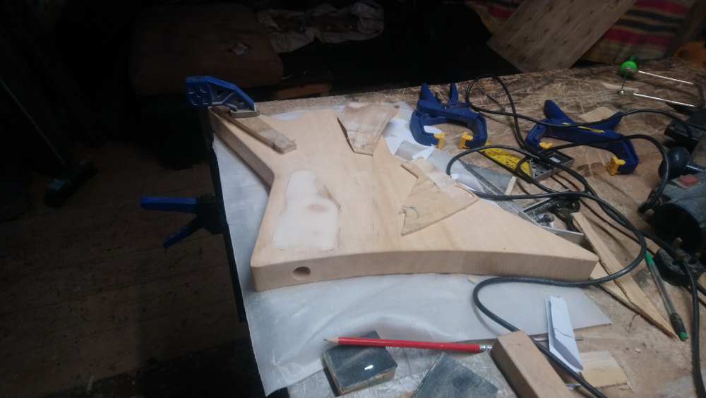

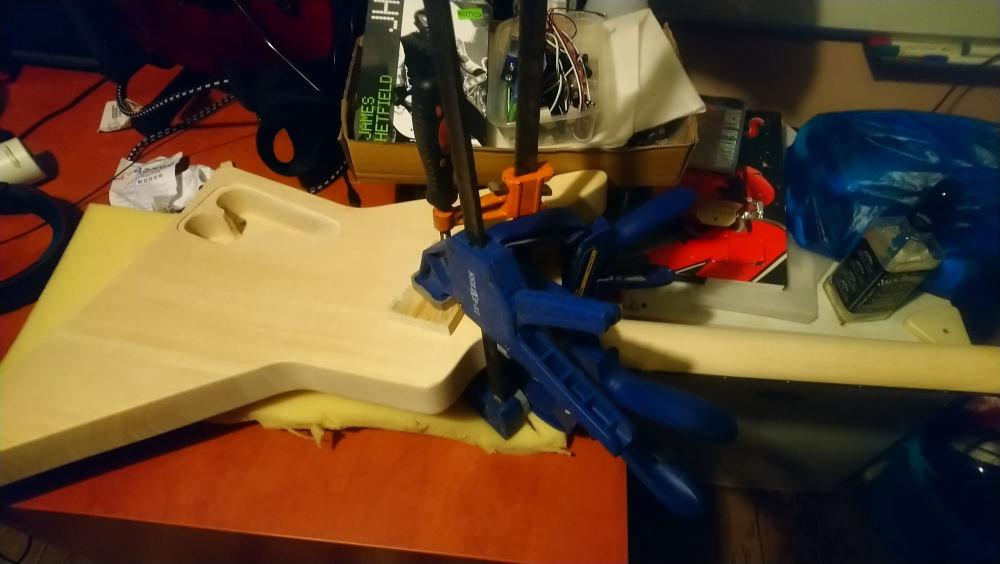

    Made some more progress on the build
    I've tidied up the routing and made the back plate, progress was slow as i broke the first two attempts in power tool related incidents. The neck and body have been sanded to 340 grit ready for painting but i decided to glue the neck on to make the joint more seamless so there is likely to be a lot more sanding before i can start painting (I can't work on it until the weekend now so i'm just going to leave it clamped until then).

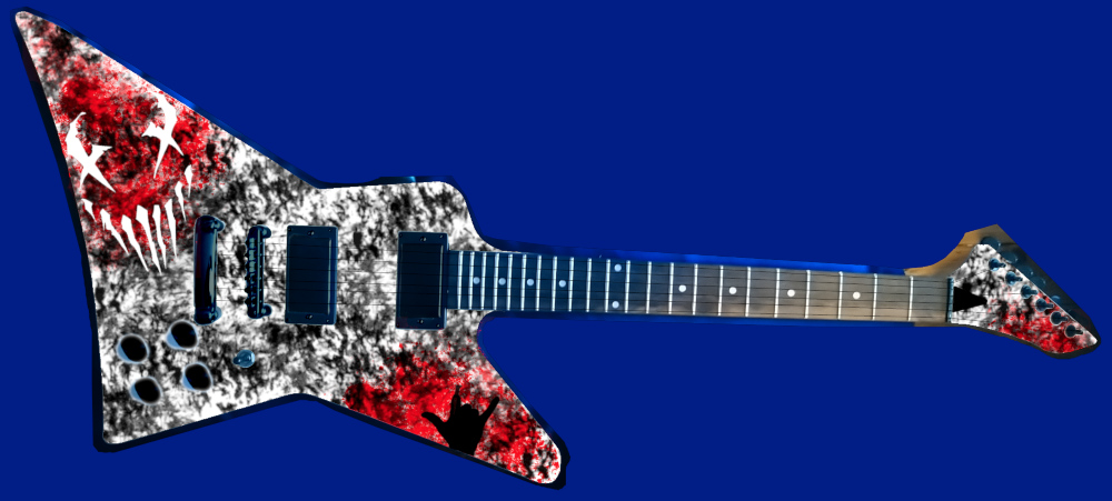

    Here's the design i'm going with, I've played a bit with test wood and pretty sure i can get this effect with spray cans, news paper and stencils. I'm going to paint the back of the neck too rather than leave it bare/glossed.
    The painting plan is several coats with light 400 grit sanding in between. I still need to look into how to get the gloss/polished look with the lacquer, i think it's something to do with polish and an electric buffer.

    You'll need to get a decent background white finish, get that finish as flat as you can by sanding back (and I mean really flat). Then add the other colours. After that you'll need to protect that with quite a few layers of clear lacquer - enough so you can sand that back flat and then go finer grits up to about P2000 and then you can polish it. But you need to put quite a few layers on as the pattern will leave the first finish a bit uneven, and you can't sand that flat as you'll remove the artwork. So to get a nice smooth finish, you need to build up enough lacquer thickness to both allow the surface to be sanded flat, and to still have enough thickness to protect the artwork.
