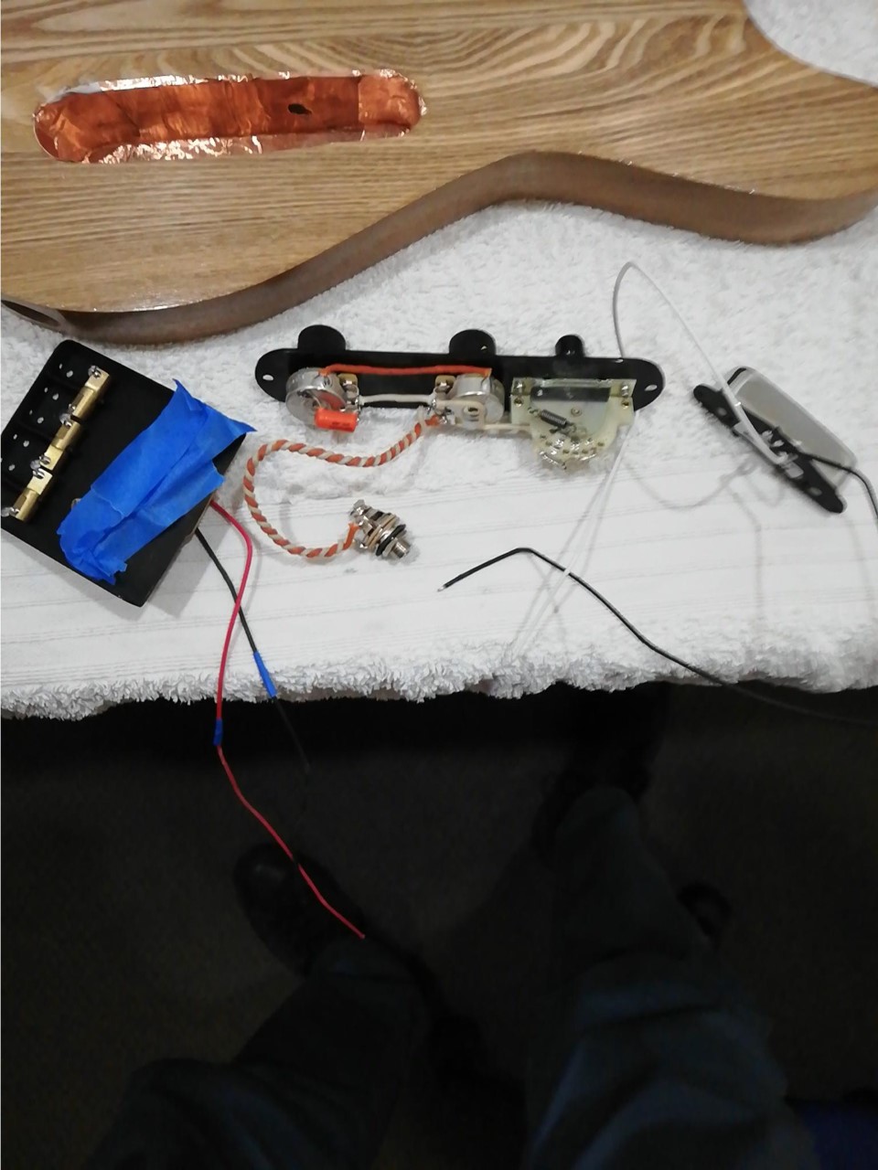

    i am putting together my first telecaster kit. i bought two entwistle pickups as upgrades and i bought an upgraded pre wired switchplate as you can see...i am unsure how to wire it as it differs from the switch given in the kit... can anyone give me some advice please??
    thanks for any help regards matt

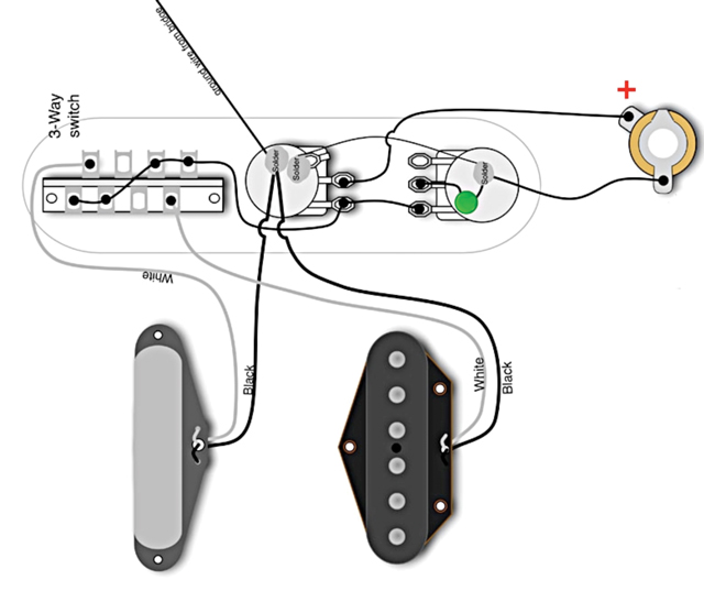

    Like this, but your Bridge + (hot) will be red instead of white:

    thanks for that mate
