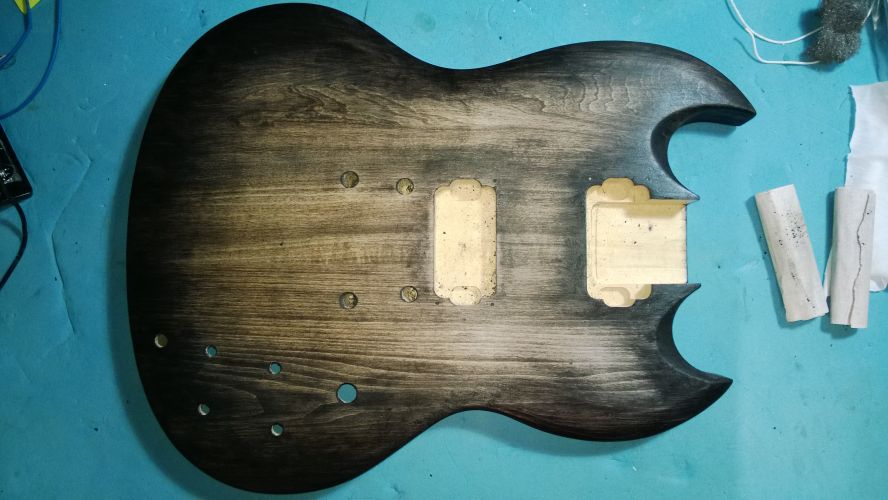

    You can do bursts with stains - there have been a couple on the forum. Depending on what you're looking for - simplest method can be - stain the top with lots on the edges, little in the middle, then lightly sand the middle. See below image.
    That's what I'm looking for! That looks awesome!
