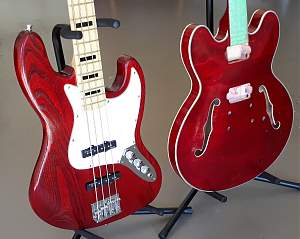

    Here is a shot of my last build that was done this way where I had to sand off the flame maple veneer. It was also finished with about 20 coats of Tru Oil and hope it provides you another angle to consider.
Name:	Front filtered light 3.jpg
    There are better shots but this one shows up dark and lighter shades of the grain. There is a link to this build in my signature if you want to check out more.
    J Bass is an Ash body where I used ebony Timber Mate as a filler to pop the grain. Easy to do when there is not a thin veneer as it requires a lot of robust sanding of the excess filler which would also strip off any veneer.
