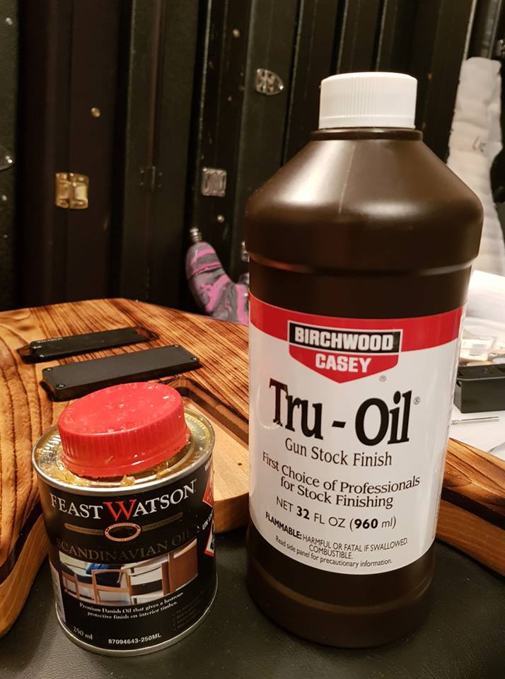

    Out of curiosity, what are you legends using to finish the back of the neck ? Not the fretboard / fingerboard, the back of the neck so its hardened and smooth and not just oiled wood. I use both Tru Oil on some necks and Scandinavian Oil on others. But not getting the hardened finish I am after. They work better on the bodies instead of the necks, in my experience anyway !

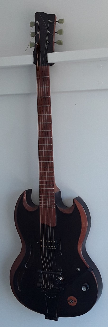

ID:	29761 the fretboerd on this has been sanded to 2000 grit and dingo waxed , it feels as nice as any i have just my skillz on the neck are a bit to be desire, but i wonder could you do a whole guitar sanded to 2000 grit or more and just ad some wax to polish, mmm might be worth a try
