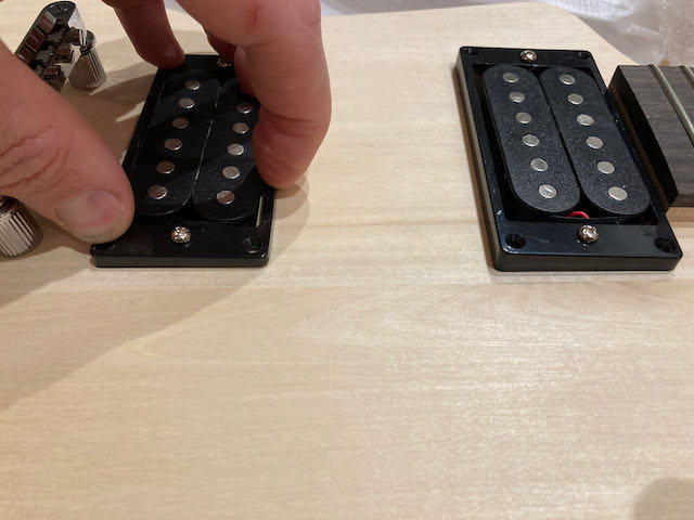

    1) which pickup goes where? Does the wiring colour (red and yellow) have any relevance? The red one has a thicker mount/bezel than the yellow one, so we are guessing that goes nearer the bridge?

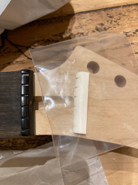

    3) We ordered the optional bone nut, but there is already a pre-glued black nut in place on the neck. How do we remove this nut and put in the new one?

    1. correct, the thicker mount pickup is the bridge - so opposite to how you put them in for the photo

    RudyRudy, the already-installed nuts are notoriously cheap, so the purchase of the bone nut was a good choice. I have done only one nut replacement, so there may be other and better ways to remove the old, but I used a razor blade to gently work in front of and at the base of the nut until I was able to wiggle it loose. Then clean up the old glue before attaching the new one. Good Luck. Hope that helps.

    As for pickups, shortest wire = bridge.

    The nut can be gently tapped out but as someone has already suggested, using a very fine blade to break the glue seal could help prevent tearing out, particularly end of the fretboard.

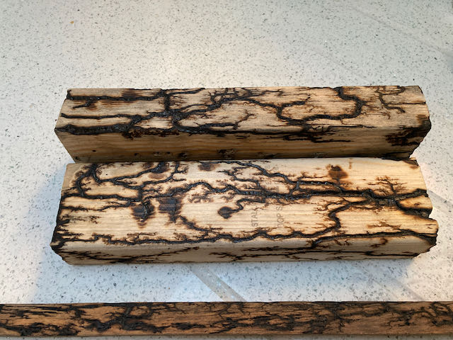

    Been very very very slow progress - too much other stuff has taken priority. P{bus must admit to feeling a bit nervous of attacking it and screwing things up.
    What I have been doing is some experiments with fractal burning, which have concluded with what probably some of you were trying to tell me in the first place - not a great idea. Still it was fun - and we learned a lot!
    In the first pic I tried some bog standard softwood (pine) and the fractal patterns were pretty cool and well ... fractal
    In the second pic the upper piece is a block of beech which I had lying around - again the fractal burn "found" the grain and did some cool stuff.
    The lower piece is a basswood laminate I made up to simulate the construction of the guitar. All my fears were confirmed:
    a) basswood has such an indistinct grain that the burn has no decision to make and if your not careful just goes A-B via shortest route, which often involves a plasma-like surface burn (spectacular at the time but ultimately crap looking)
    b) it has a high tendency to follow the glue lines and if you're not careful, will burn the laminate apart
    So - abandon that idea
    Now thinking a solid nitro finish in a kind of aubergine or black cherry colour. Anybody done that and can recommend any paint colour names?
    Thanks in advance
