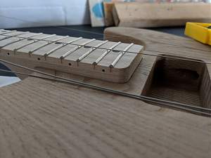

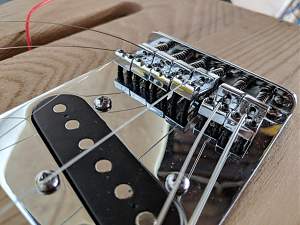

    Photos with the D string installed:

ID:	29586 I have the saddle as tall it can go.
ID:	29587 But it is still too close to the fretboard.
    I'm keen on the aftermarket bridge so it looks like I will have to deal with the issue at the neck pocket or heel.
    I've measured the depth of the pocket and it is around 18.80 +/- .20 mm. Is that the expected depth? If so, I will adjust the neck heel as I feel that is the safest path.
    Thoughts?
