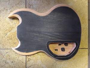

    The initial dyeing.

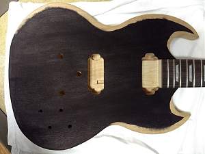

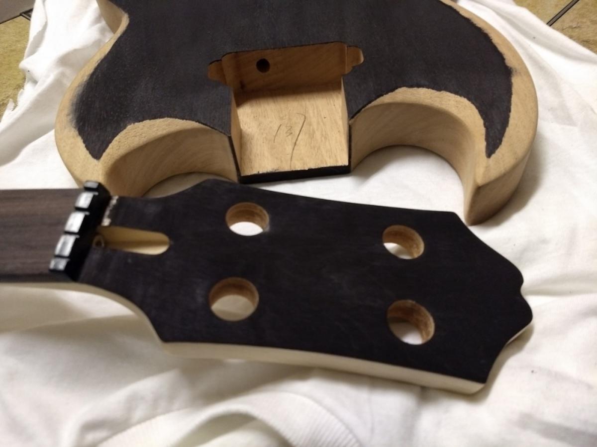

    dyeing the front of the neck pocket was a mistake but easily sanded off

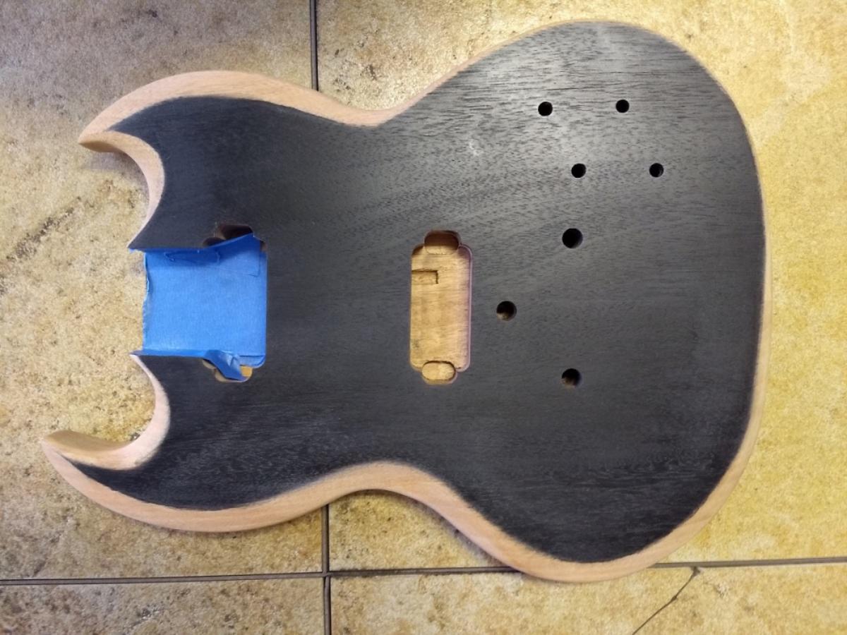

    After sanding with 120, 220, and 320 I started applying spray on satin varnish. Using a rub on oil would of just smeared the dye everywehere.

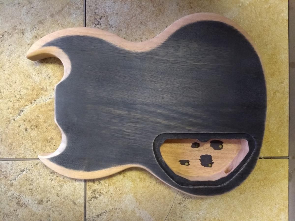

    After 4 coats of varnish I decided I could do a better job of cleaning up the edges of the dye. Particularly in the upper hook area which is at the bottom left of the image (does this have a name?). So I stopped spraying and will do more sanding.

    The back.

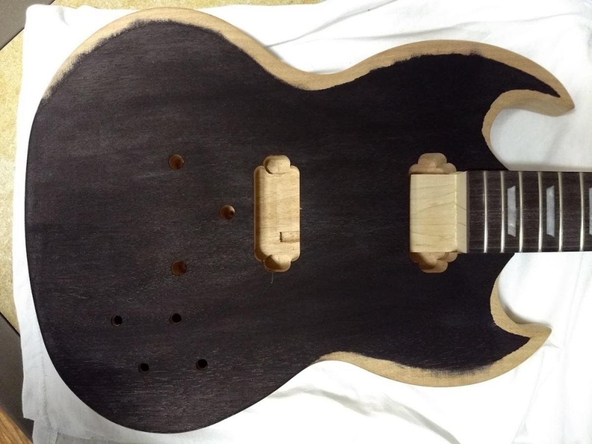

    So I cleaned up the edges and started varnishing again. Unfortunately after the 5th coat the varnish started turning white!
    Luckily the hardware store is close so I bought a lot more sandpaper. While I was sanding off all the old varnish and dye I decided I liked the look of the having the edges stained and the rest of the body bright.
    So after sanding off all the old dye and varnish I stained the edges with ebony min-wax stain. I've since applied about 6 coats of Danish Oil and sanded it down to 2000 grit. I'm still not 100% satisfied with the stain on the edges but it's getting closer. I've also ordered some mahogany laminate so the headstock will match the body.
    fun-fun-fun!
    The natural top and black sides look pretty good really!
    That milkyness in the varnish is mostly likely due to either too much humidity when applying or too cold a temperature. Given you are in the states I'm going with too cold. If you notice it happening while the finish is still wet a gentle application with a hair dryer can get it out.
