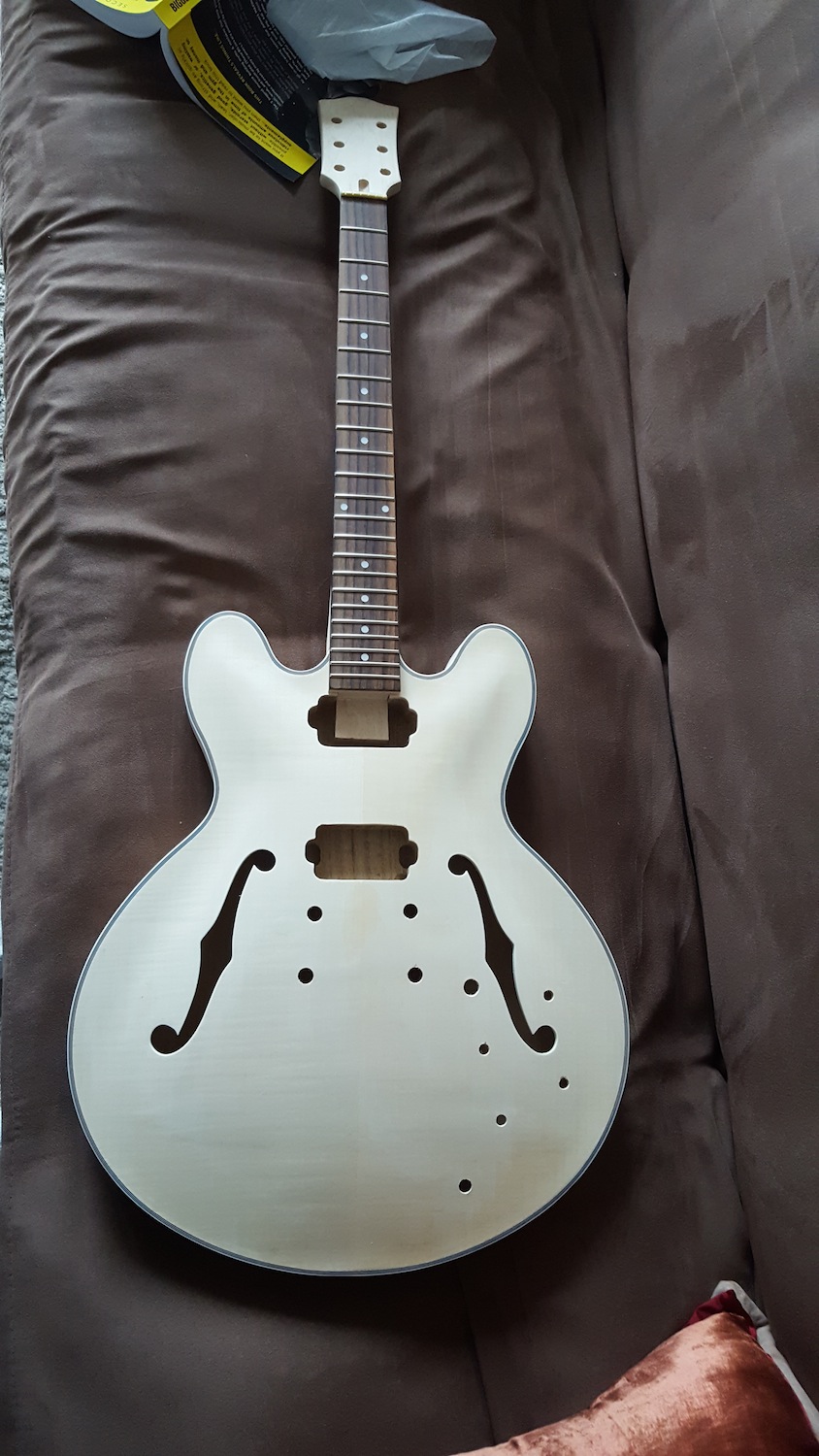

    Well it's been a long time since I've posted here, but a new page in life has begun and I also have 3 new kits to build. This ES-1G, a ES-12G and a MK-1. Lots of build diaries coming up.
    This one however is for the ES-1G. It is going to be a present for my father who has wanted a ES-335 type guitar for a while. Since it is a present I have chosen to upgrade the tuners to the grover mini locking tuners and have changed the pickups to the Tonerider AC-2's. The plan is to finish it with a tobacco sunburst'ish finish with Wudtone, as my dad really likes the tobacco sunburst style. Having never used Wudtone before, it will be interesting to see how the finish comes out.

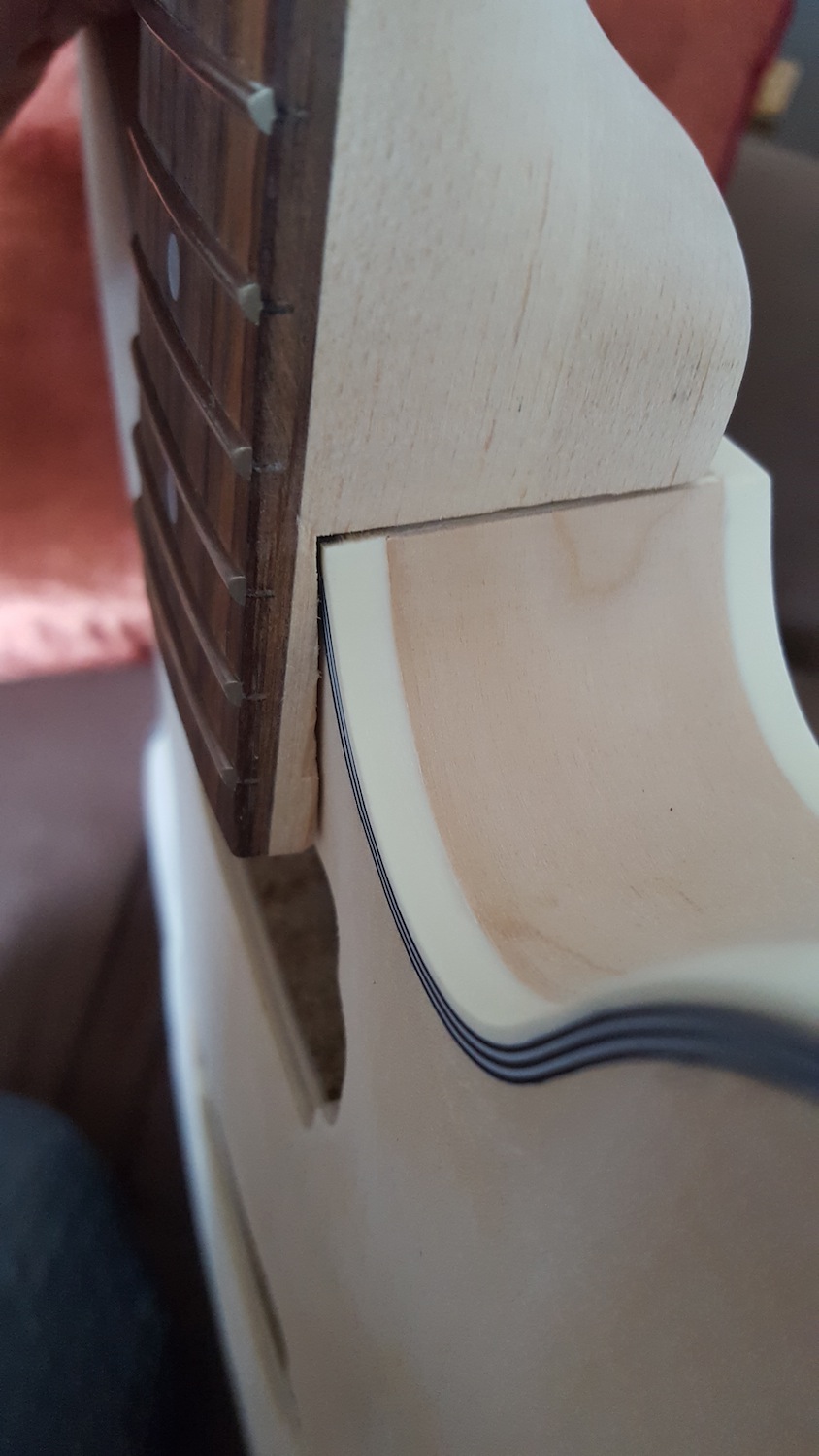

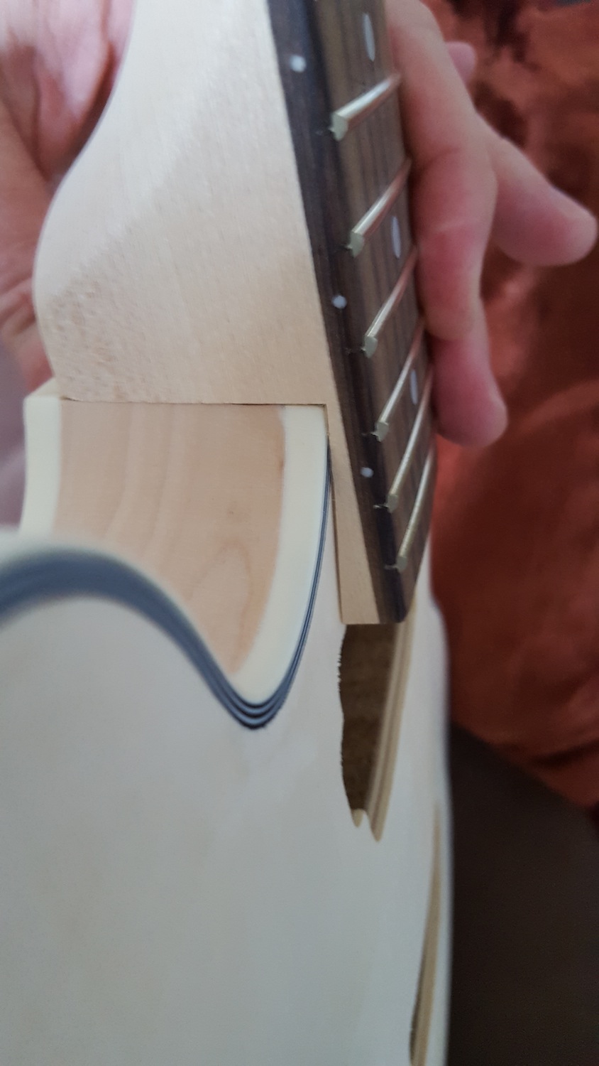

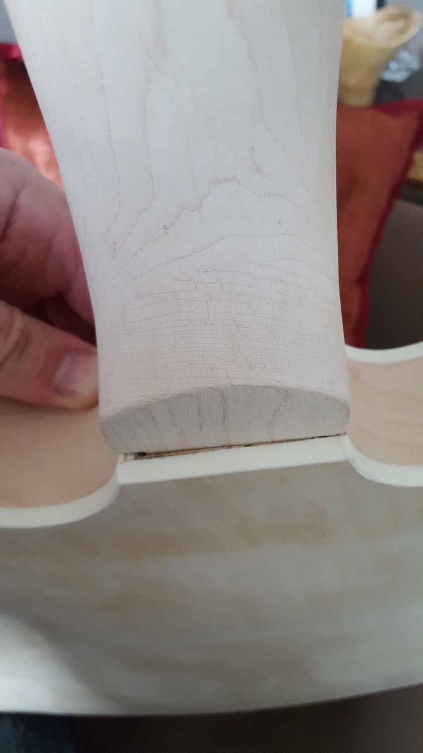

    My only concern is the neck joint. It is a tight fit but not a very clean fit. On one side it looks like it doesn't seat all the way but the other side seems to be not to bad. Looking from the bottom it also looks like the bottom of the neck pocket isn't level. Not to sure how to fix this, perhaps some careful sanding?

    Hi Brian. Have you had the kit a while? If it's only just arrived, the wood may settle down after travelling. It did a lot on my ES-3 (though it did travel many thousand miles) and took about a week.
    Before it sorted itself out, I was wondering how best to try and determine which bit needed sanding to get everything fitting well, but I never really came up with a plan that I found satisfactory. Have you tried clamping the neck (as if glueing it) to see if it improves under pressure? If it can be forced together, then maybe leave it under pressure for a few days to see if it will stay that way. If it can be forced together, it should hold when glued, though it's obviously better if it fits nicely in the first place.
    Otherwise maybe try fitting a small set-square around the neck heel to see if that has been cut straight, or measure the depths, front and back, of the body neck pocket to see if one side is slightly higher than the other (plus measure the corresponding neck cutaway depths to see if they match.
    I had thought on mine of maybe trying to get hold of some thin carbon/copying paper, slipping that into the joins and seeing if it marked where things touched and didn't mark where they didn't, but I never had to do that in the end.
    Well I fixed the neck fit. After a close look at the neck I realised it needed a light sanding on the sides. After a minute or so of sanding with 120 grit it slid in like a charm. I clamped the neck down and then put the bridge and saddle on and put the two e strings on and everything seemed to fit nicely. Now starting the sanding on the body.
