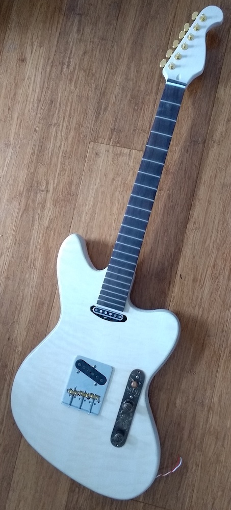

    Thanks guys. Some initial pics ...
    Trial build
Name:	01 Trial fit.jpg

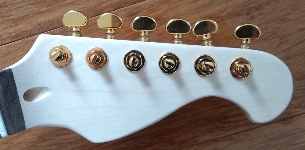

    Hawk headstock
Name:	02 Hawk Headstock.jpg

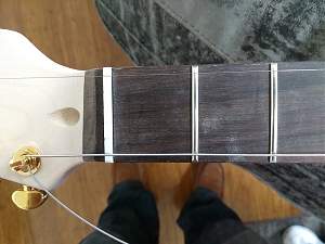

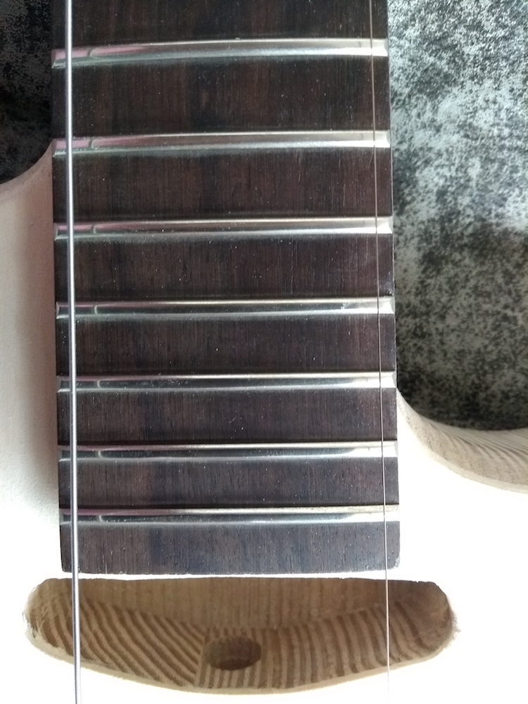

    String test - looks OK to me, strings equidistant from neck edges
Name:	04 String test Nut.jpg
ID:	28627Click image for larger version.
Name:	05 tsring test Body.jpg

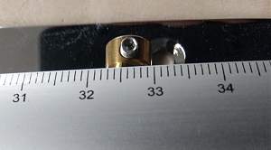

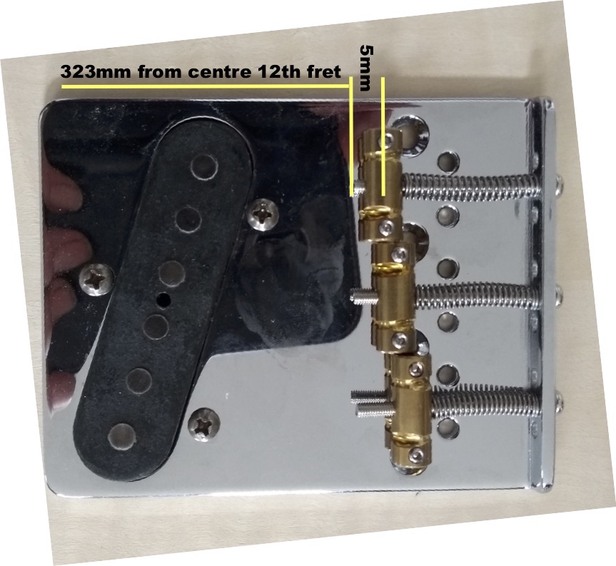

    Now the question before I start hacking into my bodywork. Scale length of 25.5" = 646mm give or take. My bridge is a 3rd party piece which is longer than the stock supplied bridge. In my trial fit, with the bridge pickup in the cavity, this is what I get ...
Name:	06 Scale length.jpg
    My understanding (from watching the great scale length video in the FAQs) is that I probably need to route the cavity so I can bring the bridge forward towards the neck by about those 5mm - ie so the high E string can sit in its saddle at the scale length point and I can adjust the other strings back as needed for intonation.
    Yes? No?

    Quote Originally Posted by chrisp View Post
    Yes? No?
    Yes, that's what I would be doing.
    cheers, Mark.

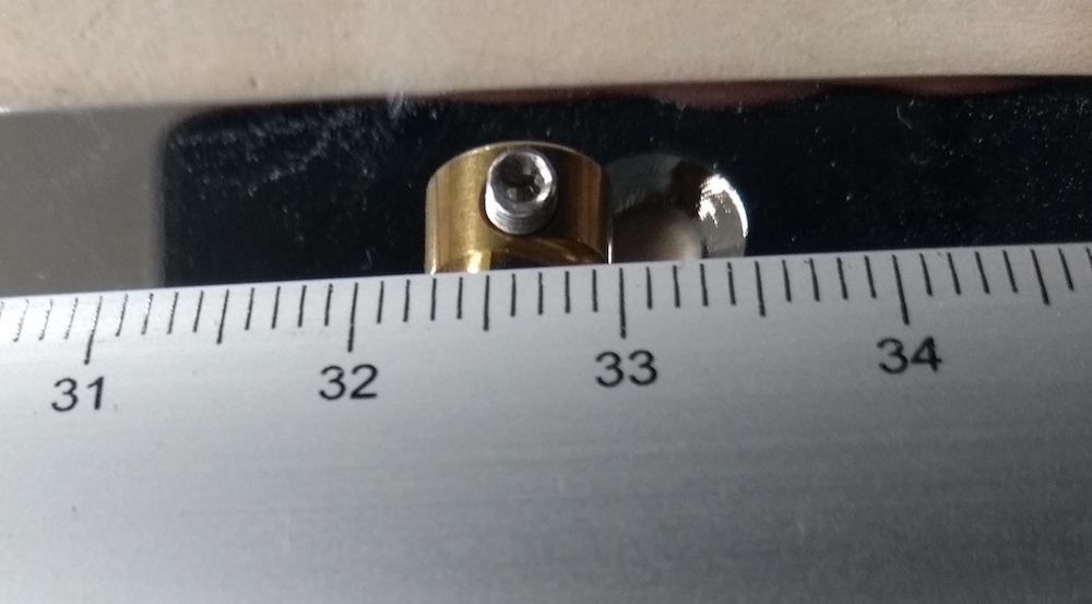

    Quote Originally Posted by Pit Bull Construction Manual
    If you are using an aftermarket [telecaster] bridge pickup and possibly even the factory one you may find that the cavity is too far back and needs to be opened up for it to fit. If you have a router, it's a small job to open the cavity up a bit
    Should have read that! Anyway, this looks a lot better
Name:	07 Scale length 2.jpg
    Appreciate the thumbs up John. I did this with a router and circular rasp from a basic strat headstock that had been cut at the factory. Given my time again I would get a paddle and do something similar but with a bevel on that lower curve around to the hawk's beak. One for the next build, perhaps.
