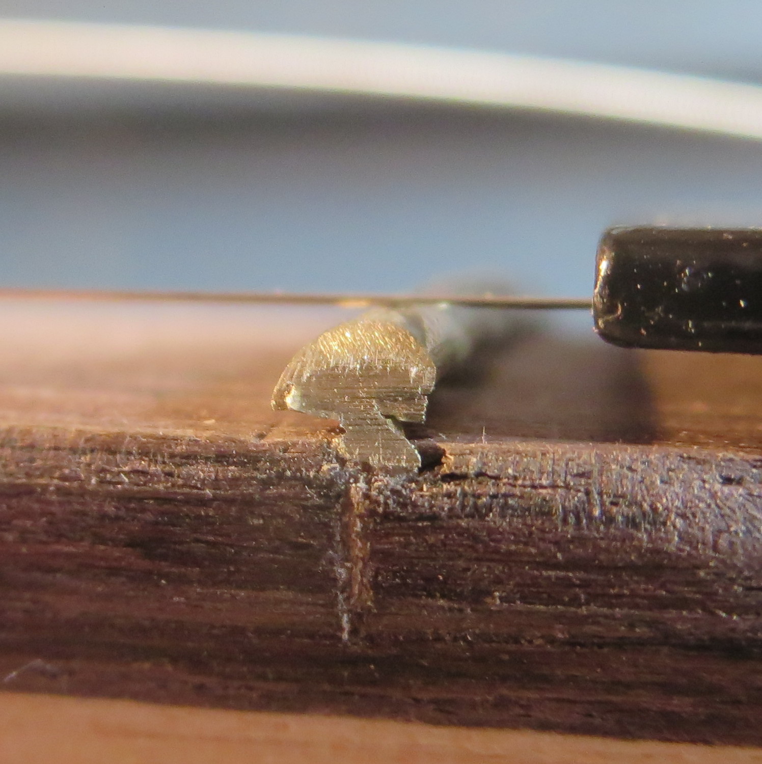

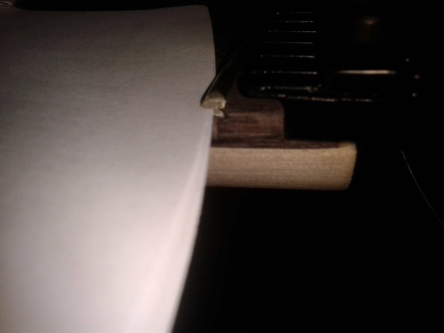

    The zero or null fret of my headless KH-1 neck does not seem to be inserted properly in the neck. Please look at the picture. I can fit five sheets of paper (from the string envelopes) between the fret and the fretboard. The fret seems to be inserted at an angle and is hovering above the fretboard.
    Please advise.

    No, it should be the same height as the other frets. It's supposed to act like any other fret does. Can you take a couple of other photos, say one showing the top of the fretboard angled sown a bit, and a similar one without the paper in the way? It looks a bit like the nut slot hasn't been cut deep enough from the current picture, though that's not particularly sharp or detailed so it's hard to be sure.
    It may require a new neck, but a couple more photos would help confirm that.

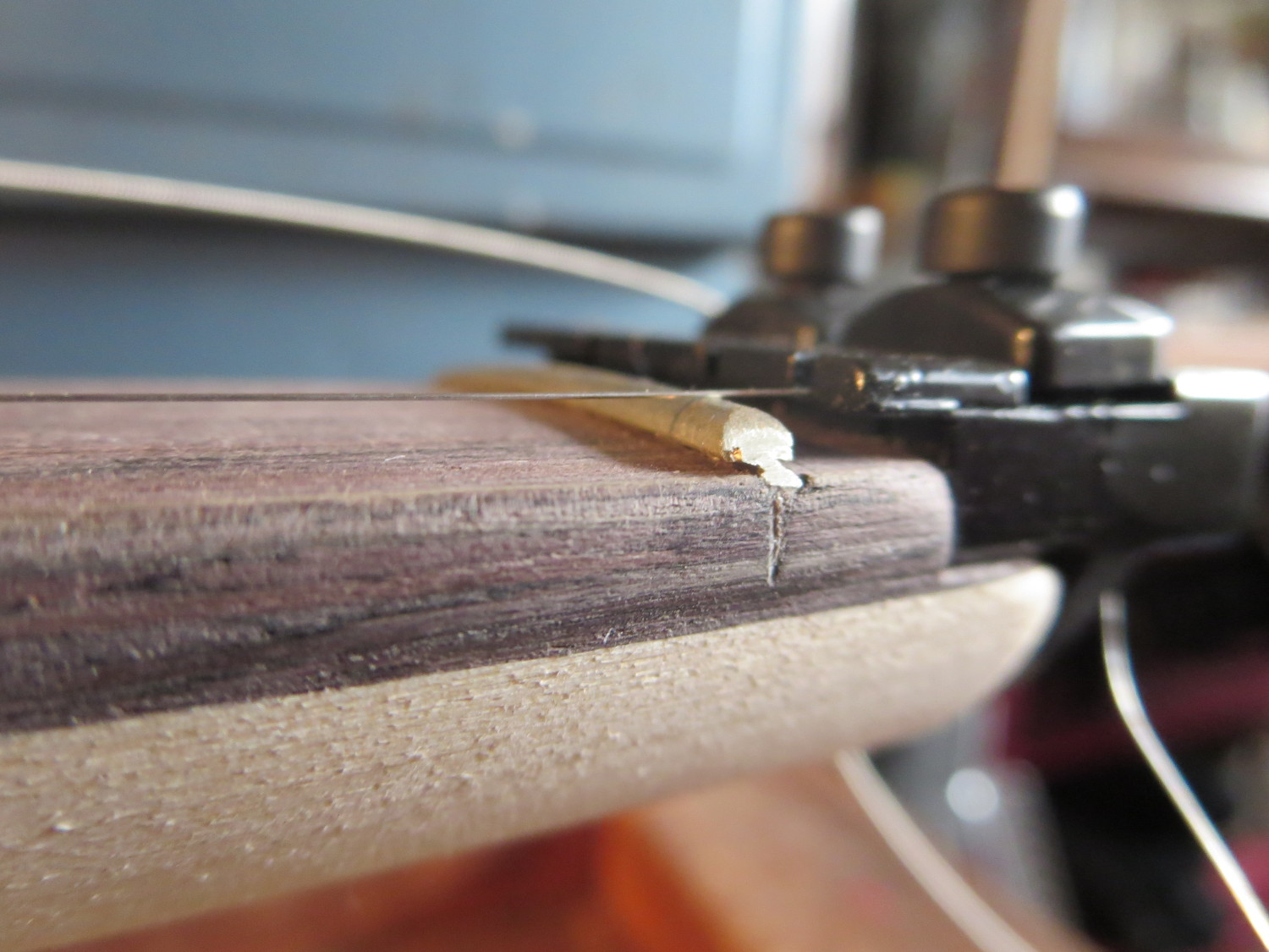

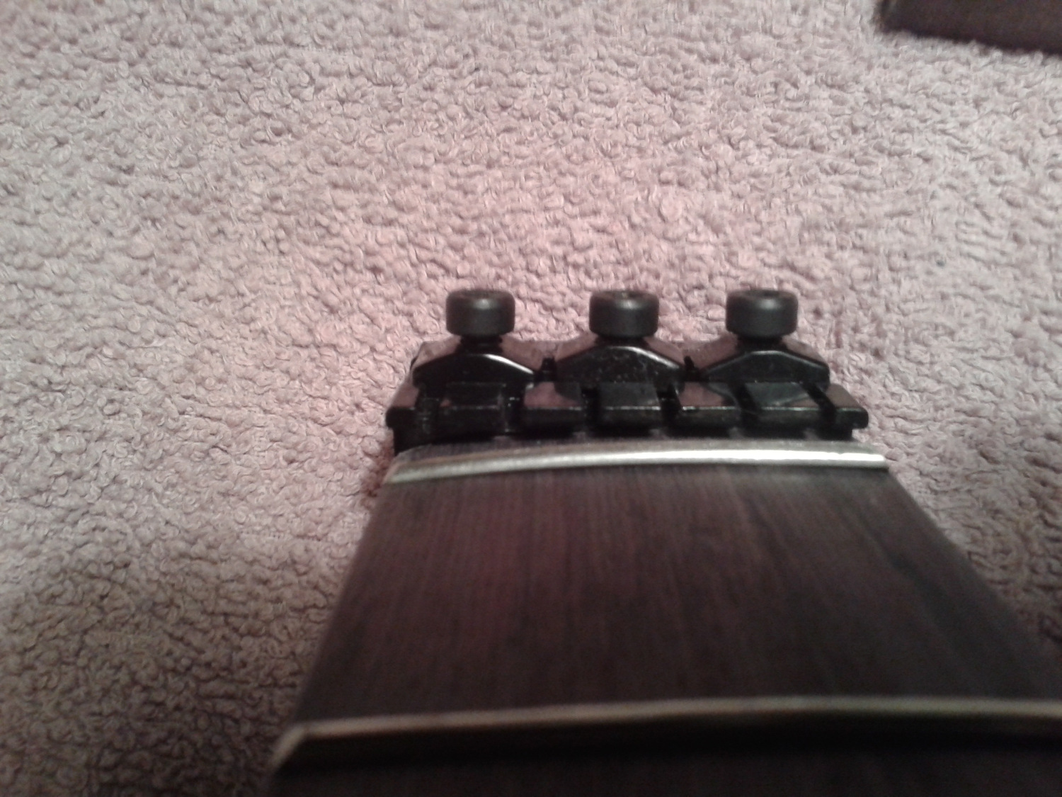

    I checked the current state of height with a fretrocker: and at the low E side it is level with the other frets; at the high E side it's definitely higher than the other frets. I don't think tapping will do any good because it is not properly slotted into the fretboard.
    Hope these pictures are better.
    Please let me know if more information is required
    cheers

    Those are great. Definitely looks like a poorly cut slot and the fret tang has bent under pressure. Unless you are experienced in replacing frets and want to re-cut the slot and fret it yourself, then you definitely require a replacement neck. The headstock assembly also looks to be sitting a bit high. I'd expect some slight downward angle on the string behind the fret as well, to stop it buzzing like a sitar.
    Thanks for the help...
    The neck has been replaced.
