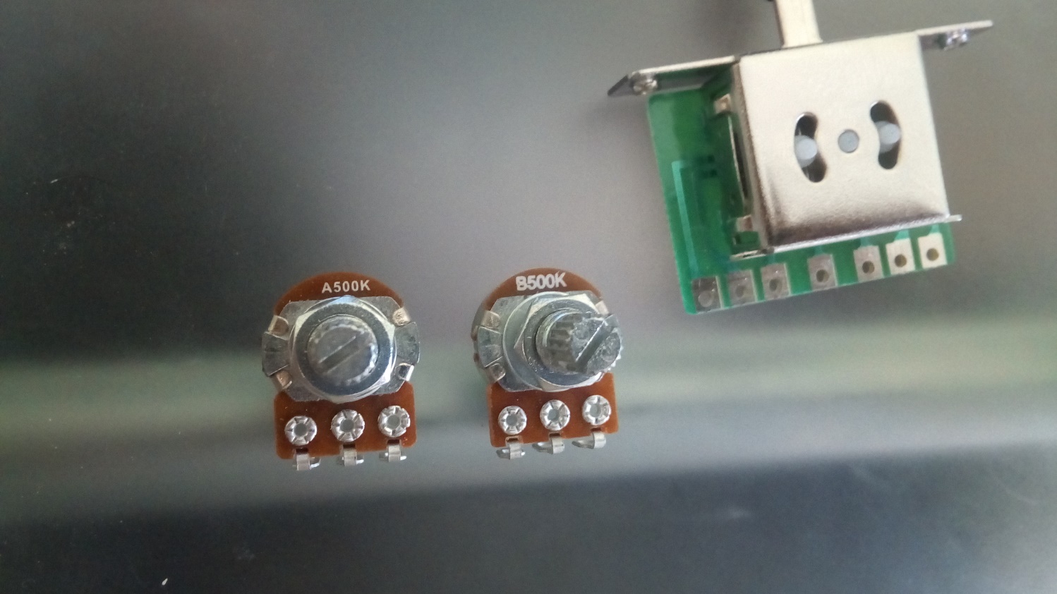

    Firstly can anyone tell me if there is a difference between the 2 pots I have for volume and tone.
    One of them says A500K and the other B500K. Not sure which one to use for which.
    ** A for volume B for tone generally speaking. The A is a linear taper, the B a logarithmic, you can use either for either with different results, but A Volume B tone is the normal way to do things.

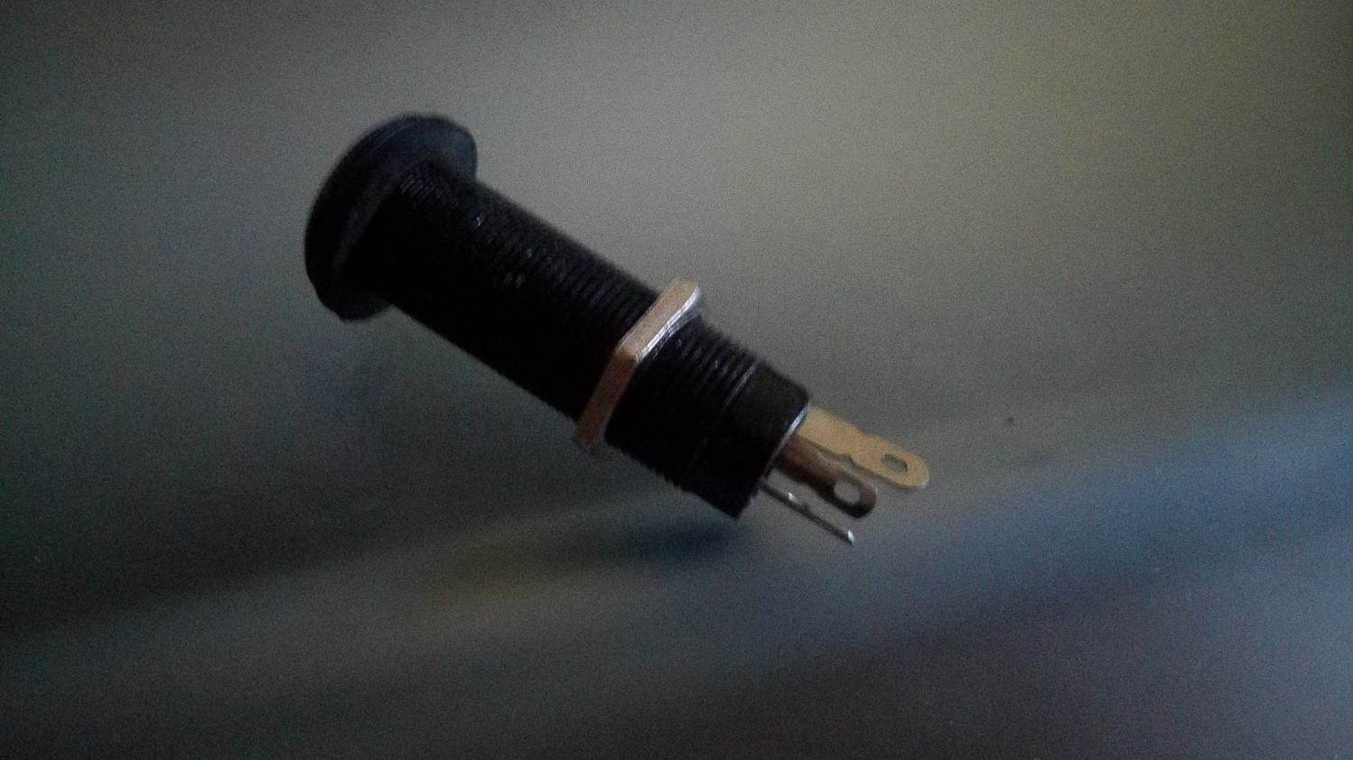

    Finally, I have an output jack for stereo but I'm wiring for mono so which terminal don't I use?
    ** can we see a pic? I did this in one of my guitars, but the jack might be different

    Here is the jack.Click image for larger version.

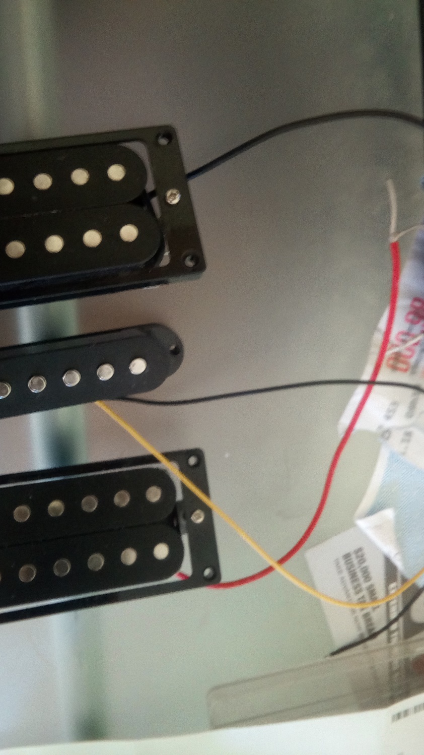

    The second humbucker has a black cable but with the first being red I"ll fit that by the bridge.
    Cheers.
    usually the neck humbuckers wires are longer too
    Hmm, the jack is a bit of a tricky one. The large outer tang should be the earth. You may have to do some testing with it plugged into an amp to determine which of the inner ones is correct.

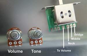

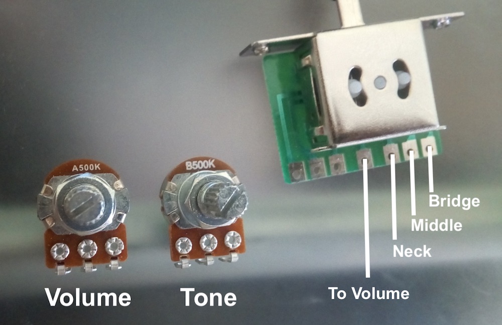

    In the PBG IB-1 wiring diagram it uses an 8 lug switch with the centre two 'common' lugs linked with a wire loop. Your switch is a 7 lug version with only a single common, so you don't need the wire loop and just have to connect that single centre lug to the volume pot.

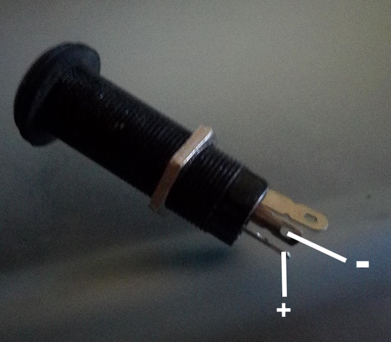

    The stereo barrel jack that come with the kits can be tricky to wire as they can vary from time to time, and don't necessarily match the Switchcraft style lug layout. A multimeter is the best way to test which lugs are hot and ground (+/-), or just trial and error when you connect it. Usually these lugs are the ones to use (but it can vary between batches):
    Regarding the humbuckers, if you have a multimeter the higher resistance pickup is usually the bridge pup. Otherwise, as already stated, the neck pickup usually has the longer wire. Again, things vary between batches, so wire colours aren't always the same be specific pickup positions.
