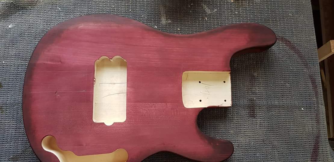

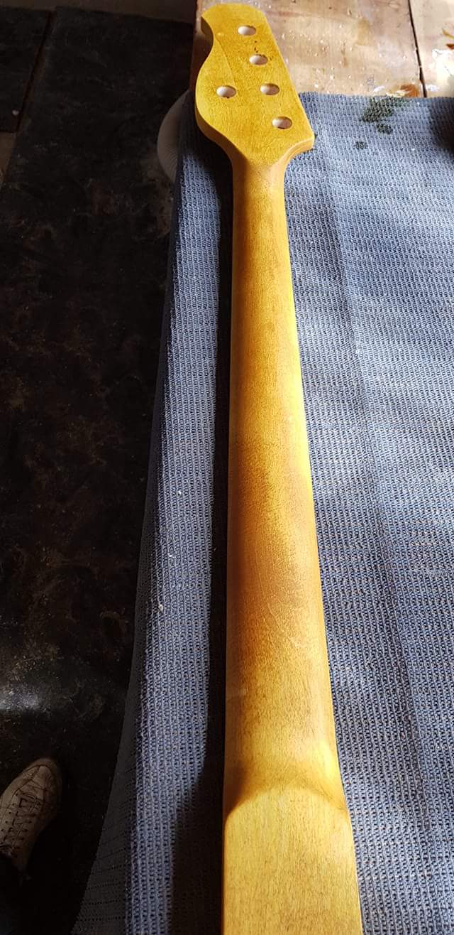

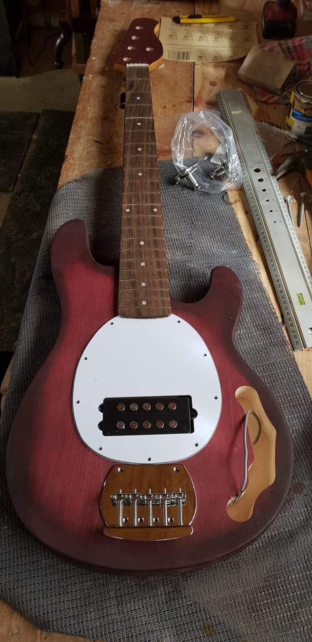

    Progress shots!
ID:	28099   Click image for larger version.
ID:	28100   Click image for larger version.

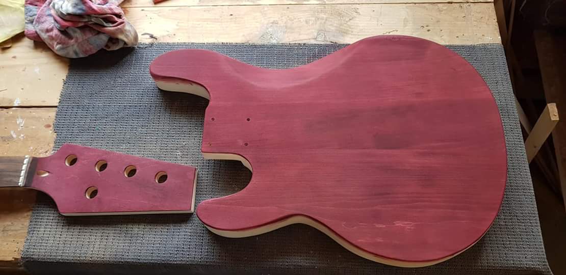

    And a couple more...
ID:	28102   Click image for larger version.

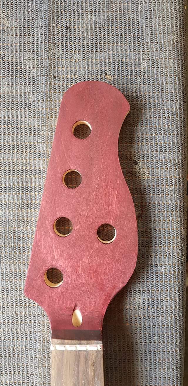

    Today's progress. Finding it difficult not to meddle with the finish.
