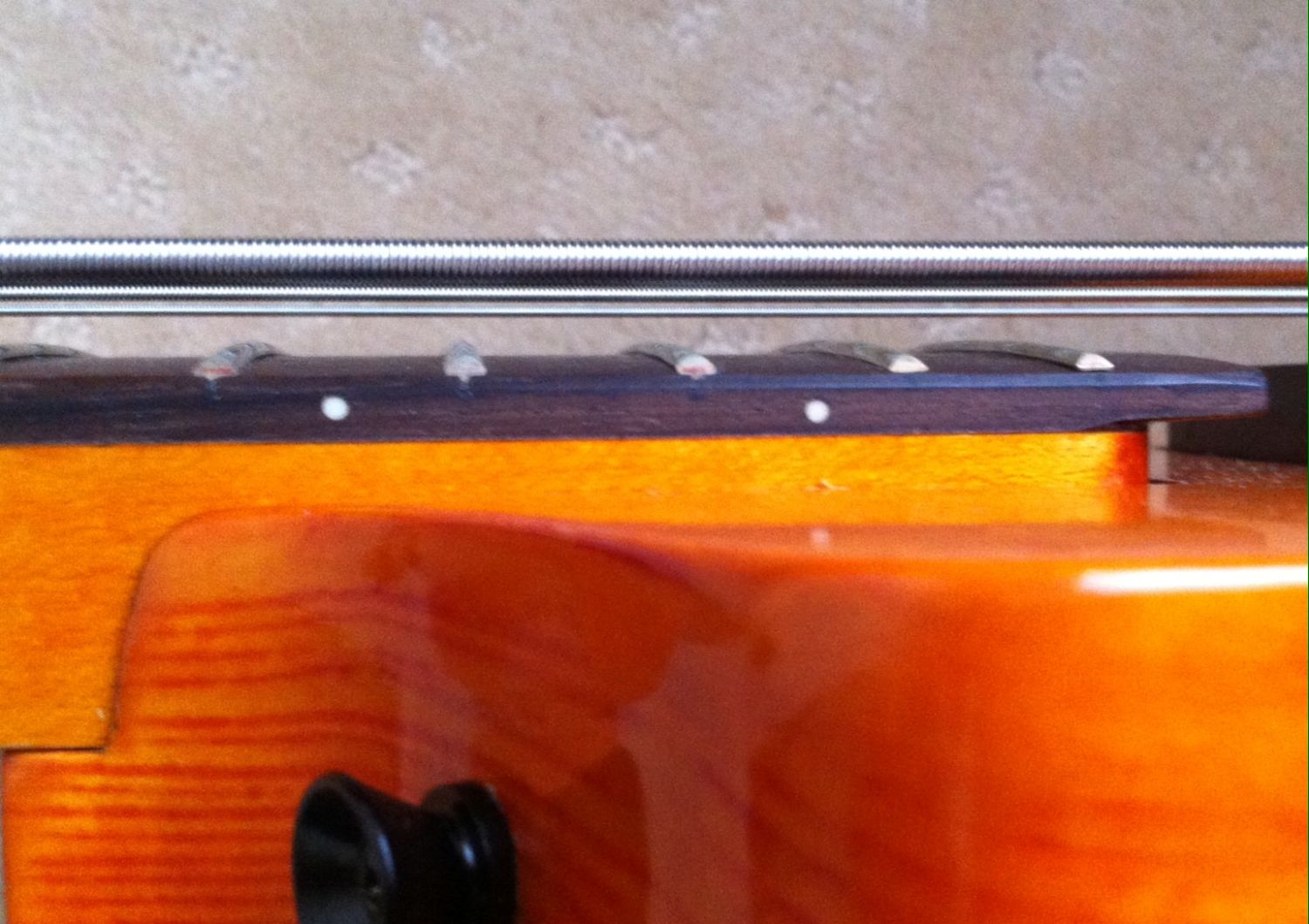

    This is how high the fret board looks at present....does this look familiar?
Name:	Action at the body.jpg
    If the lower saddled bridge and a bit of truss rod tweaking don't drop the string height I may need to fit a shim. Dropping height down in the neck pocket may only make the high action worse just for the sake of trying make it look more normal?

    Cheers Wazkelly, it looks just like that, I didn't realise that was normal. I might shim out under fret board then.
    Best to wait until final assembly to see if it requires a shim as I would reckon not all builds are shaped and cut to the ssne tolerances due to lack of any CNC machines in the Chinese factory where these kits come from.
    Cheers, Waz

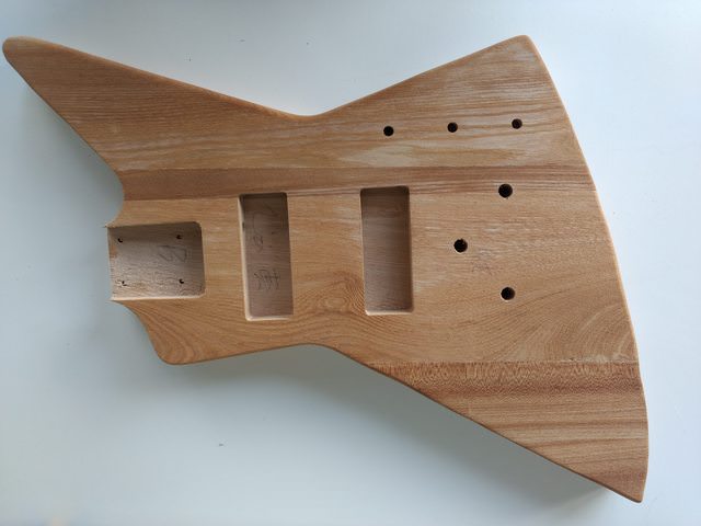

    hopefully this works. As you can see from the pic the rear of the body has some 'lumpyness' to it, it seems to be just on the edges and I assume this is normal and it will sand out?
