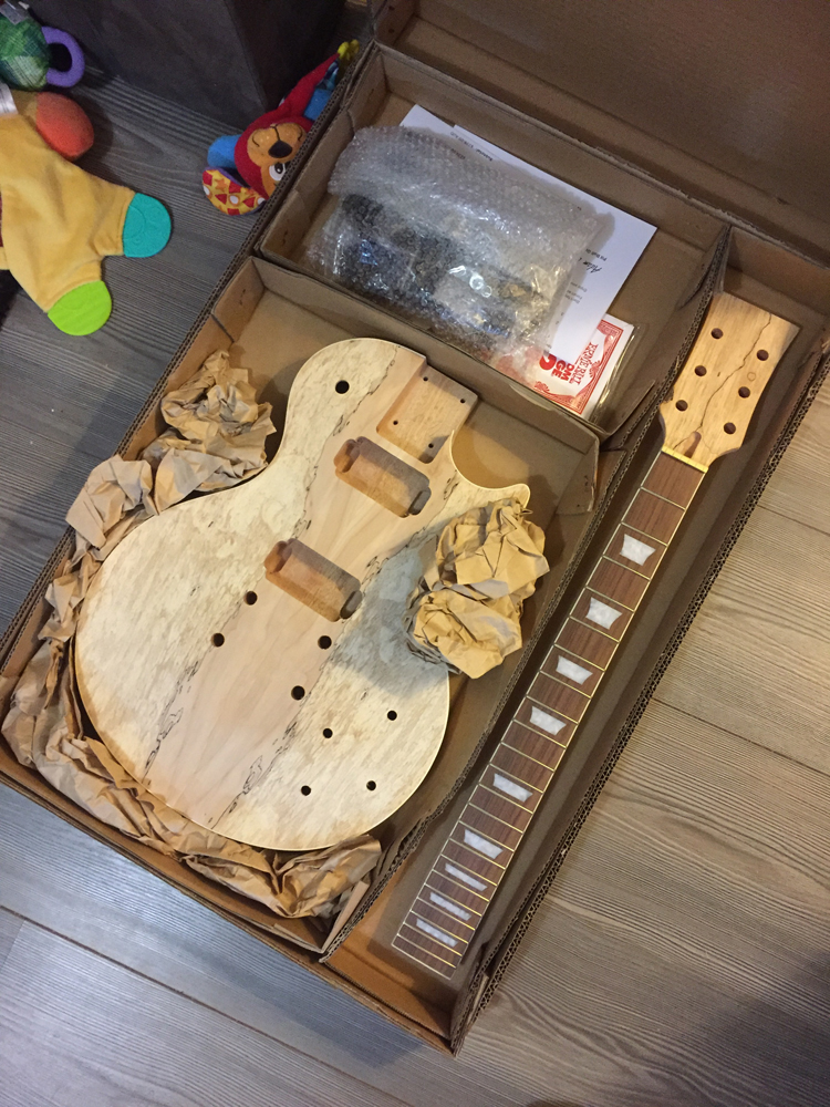

    Hey guys,
    Got my LP-1S kit last week. It's going to be slow going, but thought I should start a build diary so I don't forget.
    After test fitting everything I've mostly just been thinking about how I'd like it to come out. Decided on a headstock shape, and managed to transfer that on today (though no chance to cut it yet).
    Shall try to remember to update as I go!

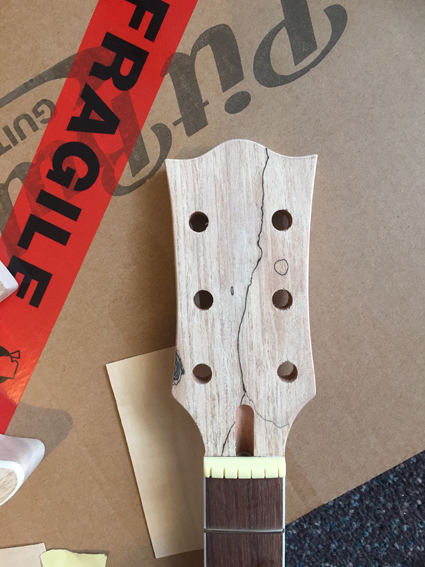

    Managed to get some work in on kit over the weekend.
    Finally cut the headstock, and then sanded down to the line. First pic is a progress shot as I scraped and sanded down to the line, and the second is of the jig I made in my studio so I could keep my scraping angle straight. I don't seem to have a photo of the headstock finished, so will take one later.
    Then, once the headstock was done, lots of sanding! Pretty sure I've taken off all the glue and machining scratches, but will look again in a day or two when I have fresh eyes.

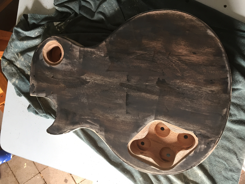

    Started grain filling the back and sides with some ebony Timbermate. It's the first time I've used it, and I think I had the mix a bit thick the first time (see pic). The second coat I did I made the mix a little thinner, and it went on and sanded off much more easily. I also realised I should probably have masked out the cavities, so have done that now.
Name:	pore filling small.jpg

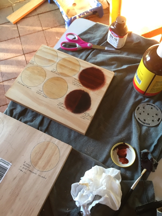

    Also started doing some little stain + finish tests on some scrap timber I had lying around. Unfortunately the only scrap I have is pine, so not ideal, but at least it gives me an idea.
Name:	stain test small.jpg
    Planning on using tru oil for the finish, as I've used it twice before and really love the way it feels. One of the tests I made (in fact, the one that looks most promising so far) was to see if the Colortone stain will go over shellac. I used shellac as a seal coat on the mandolin in my avatar pic, and it gave a really nice glassy effect to the stain (though that stain was oil based). I don't remember who suggested the shellac to me now, and the internet seems pretty divided on the use of shellac to seal wood, but as it looked so good last time I tried I figured it couldn't hurt to test and see if it works with the Colortone.

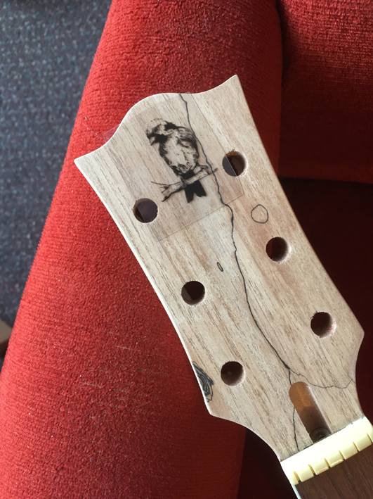

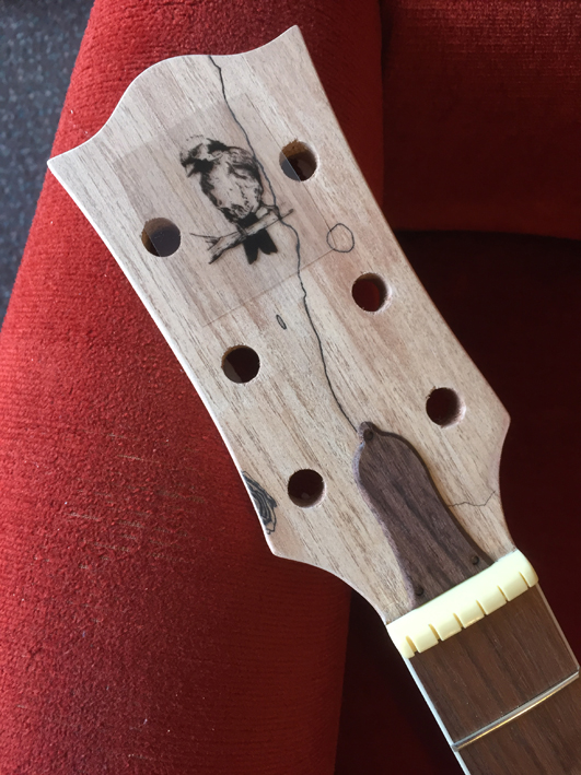

    Printed out a logo test on some acetate to see how it looks and to check the scale. It came out super blurry, as it seems my printer doesn't like printing on plastic. Apart from the blurriness, what do you guys think of the logo/placement/scale? I'm thinking maybe it could be a little smaller?
Name:	hs logo small.jpg
ID:	19062Click image for larger version.
Name:	hs logo 2 small.jpg

    Mentor Zandit75's Avatar
    May 2016
    Penguin, Tasmania
    1,617
    Looking good John.
    I like the first location better for your logo. Once the tuners are in place, it will look like the branch is locked between them.
    Acoustics:
    Electrics:
    Builds in Progress:
    Jan 2017
    British Columbia, Canada
    239
    I agree with Zandit, first position is more aesthetically pleasing. The size seems good to me.
    Mentor Kick's Avatar
    Feb 2017
    Amsterdam, The Netherlands
    823
    Yep, same for me
