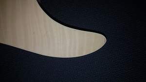

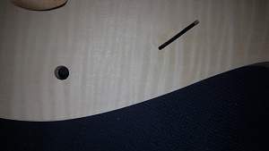

    I've attached 2 pictures, it's very hard to see but at the picture of the horn you can see the normal binding thickness and the other one the thin binding is visible. In the pictures, the binding looks wider than it really is unfortunately but it is regarding the area directly underneath the switch up untill the tone knob hole.

    I can see what you are saying with the binding at the lower bout, it really does look off, and that would annoy the hell out of me.
    The great part is that the veneer (from what we can see) looks absolutely wonderful!
    I would think that a strip off of existing binding, carefully (VERY carefully) deepening that binding rebate manually, and re applying to get an even binding band is the best way to proceed.
