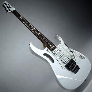

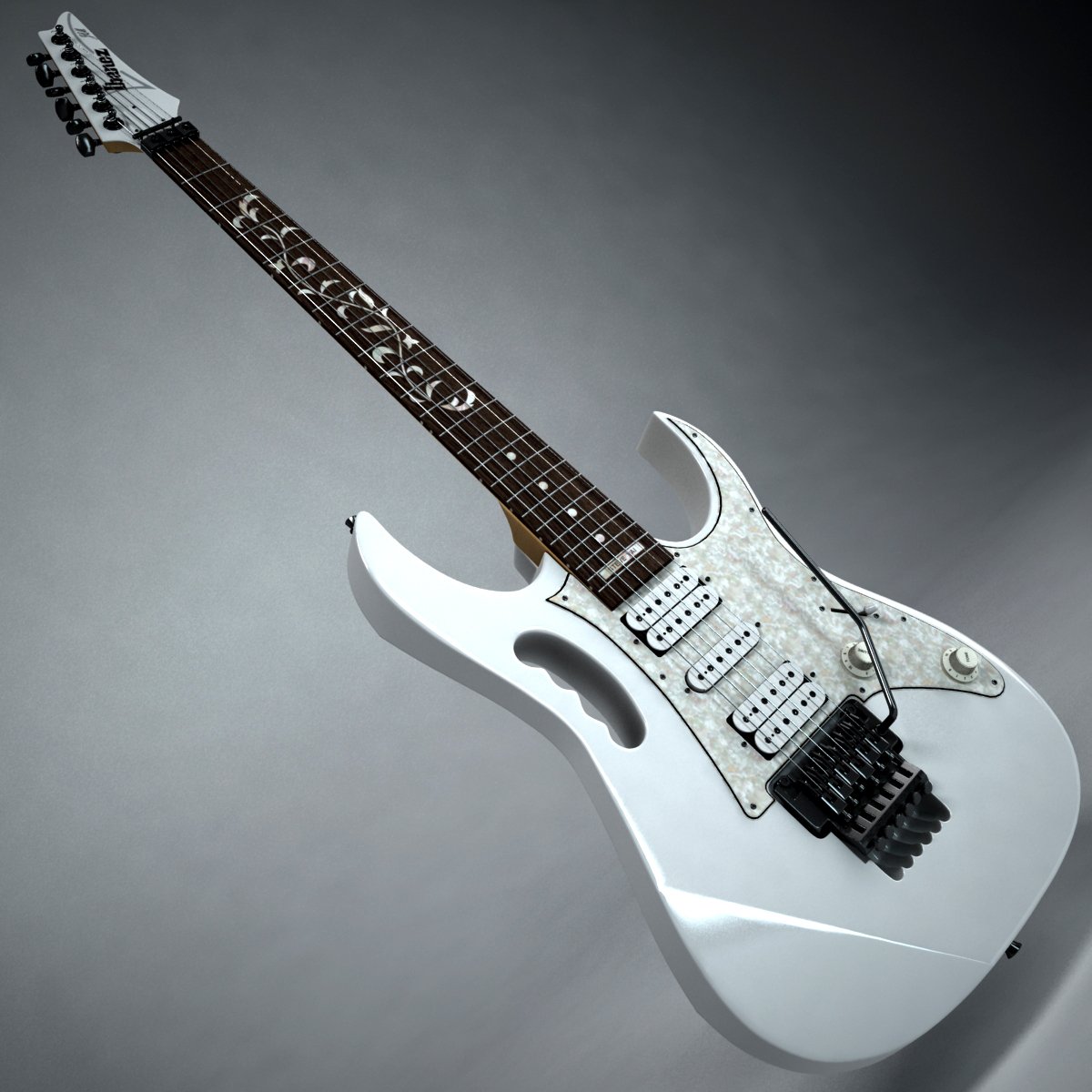

    But now i'm confused on what sealer, base coat, colour coat and clear finish products to use. What i do know is what i want it to look like, see pic below. This is how i want mine to look but not sure what products to use to get there.
Name:	ibanez jem - Project 1.jpg
    Do i use something like the Dupli-Color range or something else, and what filler / sealer do i use prior to a base coat?
    Any help would be really appreciated!

    I definitely want to keep it Solid White with that nice polished top as i have the pearl scratch plate (if i didn't have a scratch plate i would have thought about a pearl finish).
