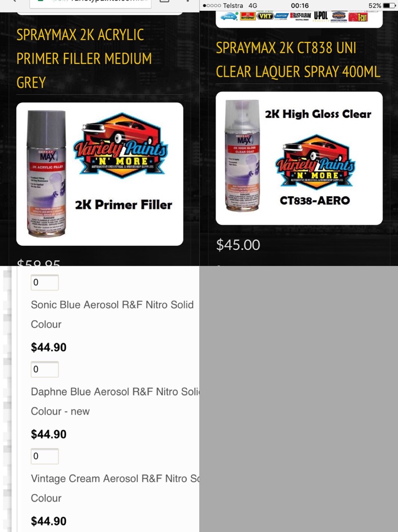

    Has anyone used spray max 2k before? I have heard good things so I think I may go with them for primer filler and lawyer. Rothko and frost for colour coat.
