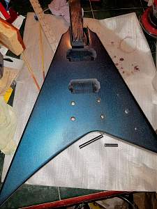

    Fun with painting. I got the primer sanded smooth and ready to spray on Sunday, only to discover that the masking tape that I used in the neck pocket had flopped over onto the body, so I had a triangle of bare wood and had to prime again. I couldn't quite get that spot even with the rest of the primer coat, but it's small and under the neck pocket, so hopefully not very noticeable when the guitar is put together.
    The paint that I ordered appeared to be a blue-green color shift, but when it arrived, I discovered that it was blue-purple. You can see flashes of green, gold or red in it in the right light. I was very disappointed when I started spraying. You could hardly see anything over the black base coat (required for the paint to work), but I kept spraying on coats. In the end, I'm not unhappy with it, though not completely satisfied either. It's a tough paint to spray, a little too close or a little too far away, and it comes out all wrong. There are still a few rough spots, which are particularly apparent in the flash photo below that I'm going to try to touch up before I spray the clear coat. I still wonder if maybe I shouldn't have sprayed a black with a little gloss over the primer before I put the paint on, but I'm curious what the clear coat will bring out. (Please ignore the messiness of my work bench. I've got several projects going at the same time, and they're all crammed in a small space.)

    Member Spychocyco's Avatar
    Sep 2017
    Louisiana, USA
    84
    Trying to fix some problem areas in the paint on the JK-1, and royally messed it up. Was near the end of the paint can and had a big glob shoot out at once along the bottom horn. I tried to wipe it quickly, but you can imagine how that worked out. Looks like I need some sandpaper and another can of paint. Going to have to sand it back a little and do a few more coats. I wasn't really satisfied with it anyway, but dang this paint is not cheap. On the bright side, I may have enough left with the new can to do the back of the MM1, and I should have the technique down by then.
    Nothing really going to plan with either guitar at this point. I haven't been able to get the purple that I want for the MM1 top, even though I followed the exact formula with Keda dyes that I saw a guy use online to get it. I've modified several times from there, testing on a piece of veneer and can't get much change. It's more of a dark plum color than the royal purple I envisioned. I think I should have chosen simpler finishes for the first time.
    Its all a learning curve, especially on first builds, so don't beat yourself up too much. I thought finish was going to be pretty straightforward, but still managed to stuff up the first go at it. Flip or chameleon paint is notoriously difficult to get right. Light coats in multiple directions is the go, waiting a couple of minutes between passes. It also really needs to be out in the sun to get the full colour change effect.
    I'm not up on the dyes, but it might change once you start getting some clear on and the different wood tones show through.

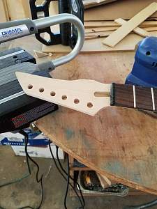

    More adventures over the weekend. The paint job on the JK-1 is pretty much a disaster. I sanded back to get the blob off, got another can of paint and gave it a few more coats. Had it looking decent until the spray can started throwing out some sort of gray, dusty spray. Not sure exactly what happened. I was shaking the can frequently to keep it mixed, but the paint is so difficult to see going on that I did a couple of passes before I realized what was going on. The stuff was dry and hard almost instantly, so more sanding back, got the paint can working right again, and hit it lightly, afraid to do more. It's OK, but very splotchy. Should have left the first run alone instead of trying to touch it up. I've decided I'm going to clearcoat and see what happens. It may stand as a monument to my utter failure as a painter.
    Also cut the headstock for the JK-1. Botched that up, too, as you can see, but I think I can smooth down that hump and make it look decent. I hope I can make it play well because that may be it's only saving grace.
