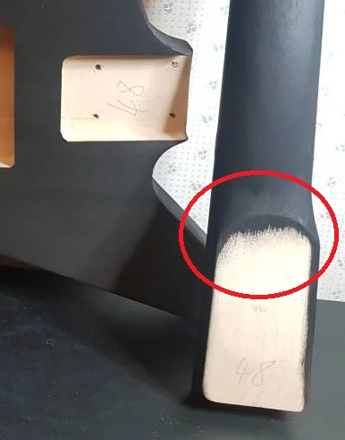

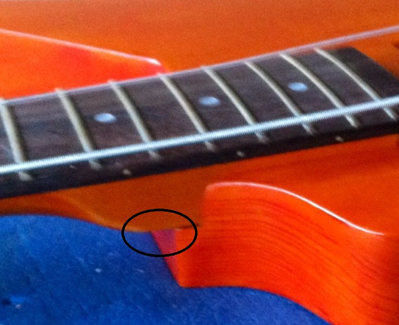

    Just a quick heads up - there will probably be a bit of the heel hanging over the body - worth putting the neck in the body and making sure - otherwise you may end up with a little blonde patch - see below (pinched from Wazkelly's EX-5 build - http://www.buildyourownguitar.com.au...ead.php?t=4257).
ID:	29485   Click image for larger version.

    Actually I noticed that mistake yesterday and it fixes now.
