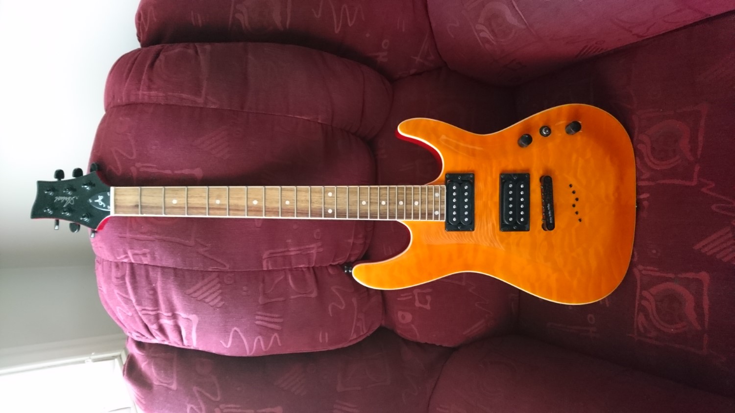

    A good while back I asked around to see if somewhere had a cheap, dual-humbucker guitar that I could grab and have a bit of a much around with. Couple of guys here suggested Artist Guitars, and now I've finally gone and bought one. Arrived yesterday, but I was busy almost all day so didn't have much of a chance to play around with it past first impressions. But I will say, first impressions were pretty good.

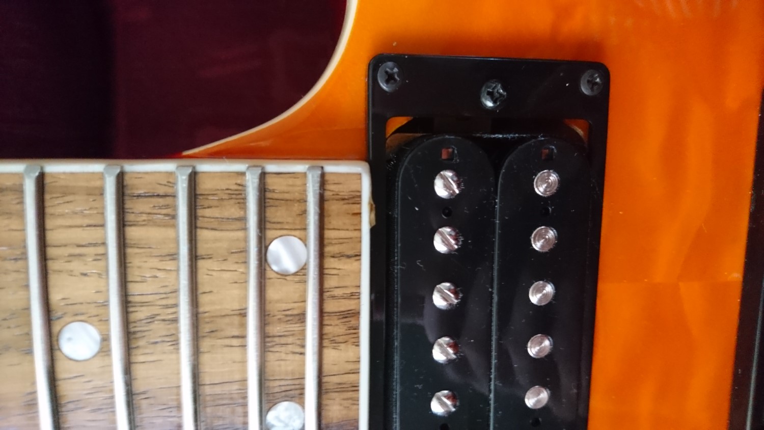

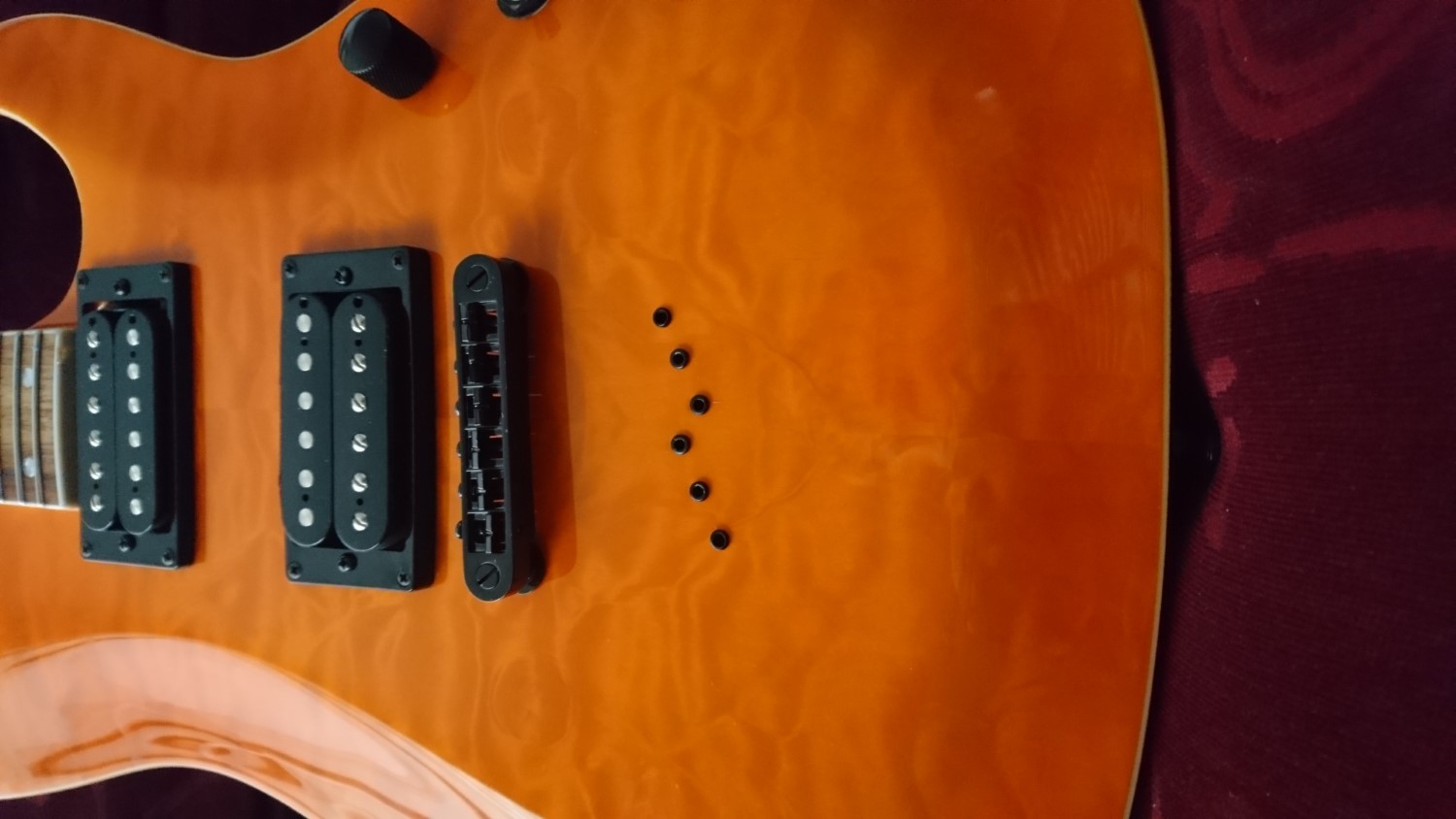

    The colour is very nice, in my opinion, and it's a very nicely figured veneer on top. I was half expecting it to be photo-Quilt, but it's definitely real maple.

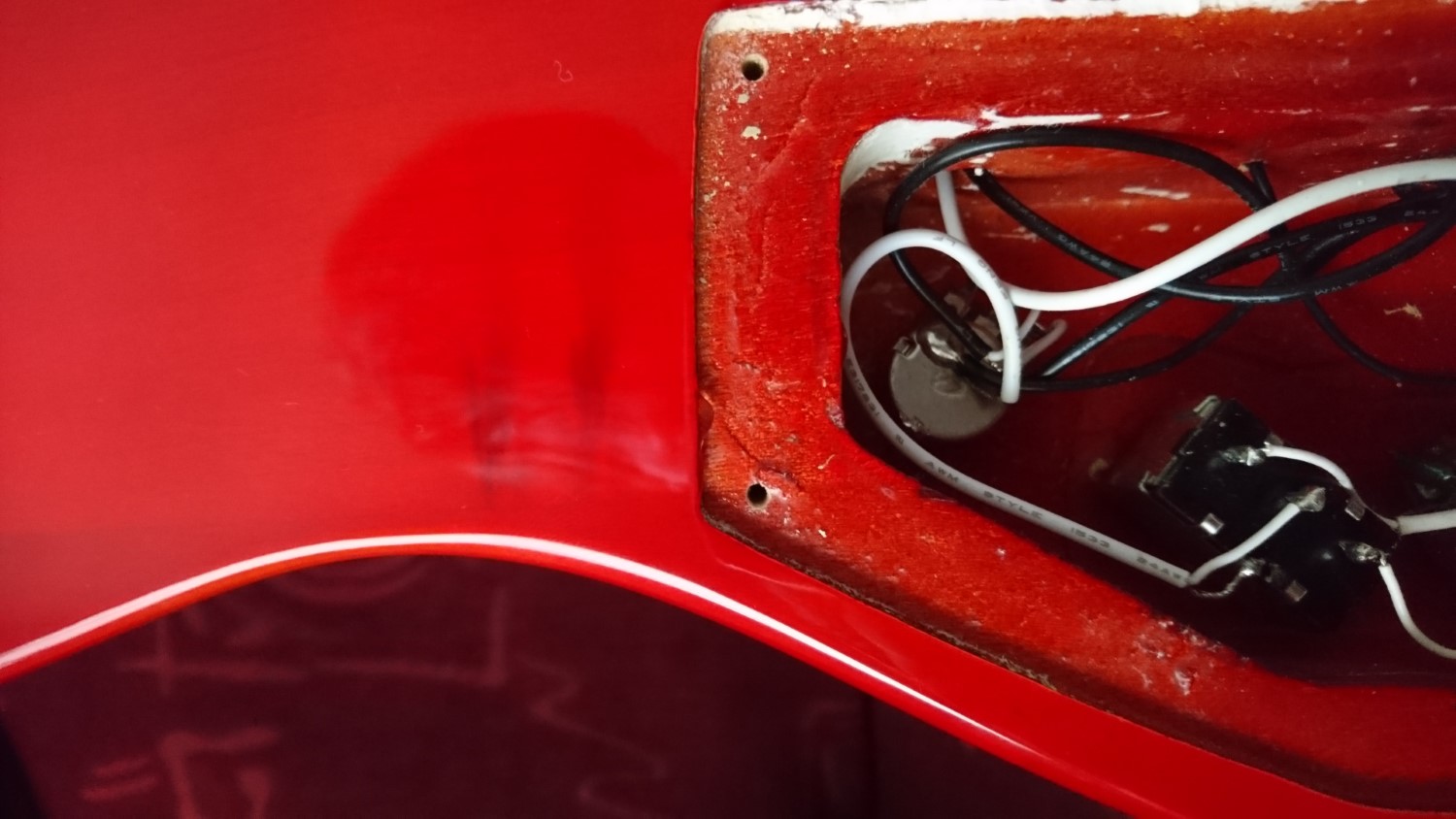

    There was two runs of clear-coat, one on the end of the fretboard and one on the inside of the electrics cavity

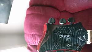

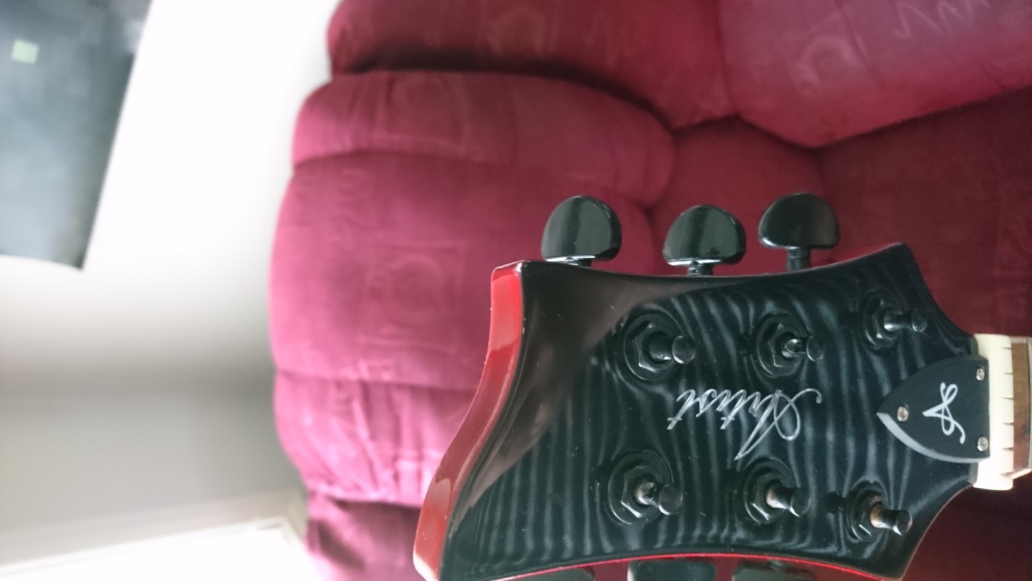

    And a small chip in the paint on the headstock.
