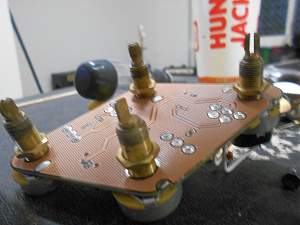

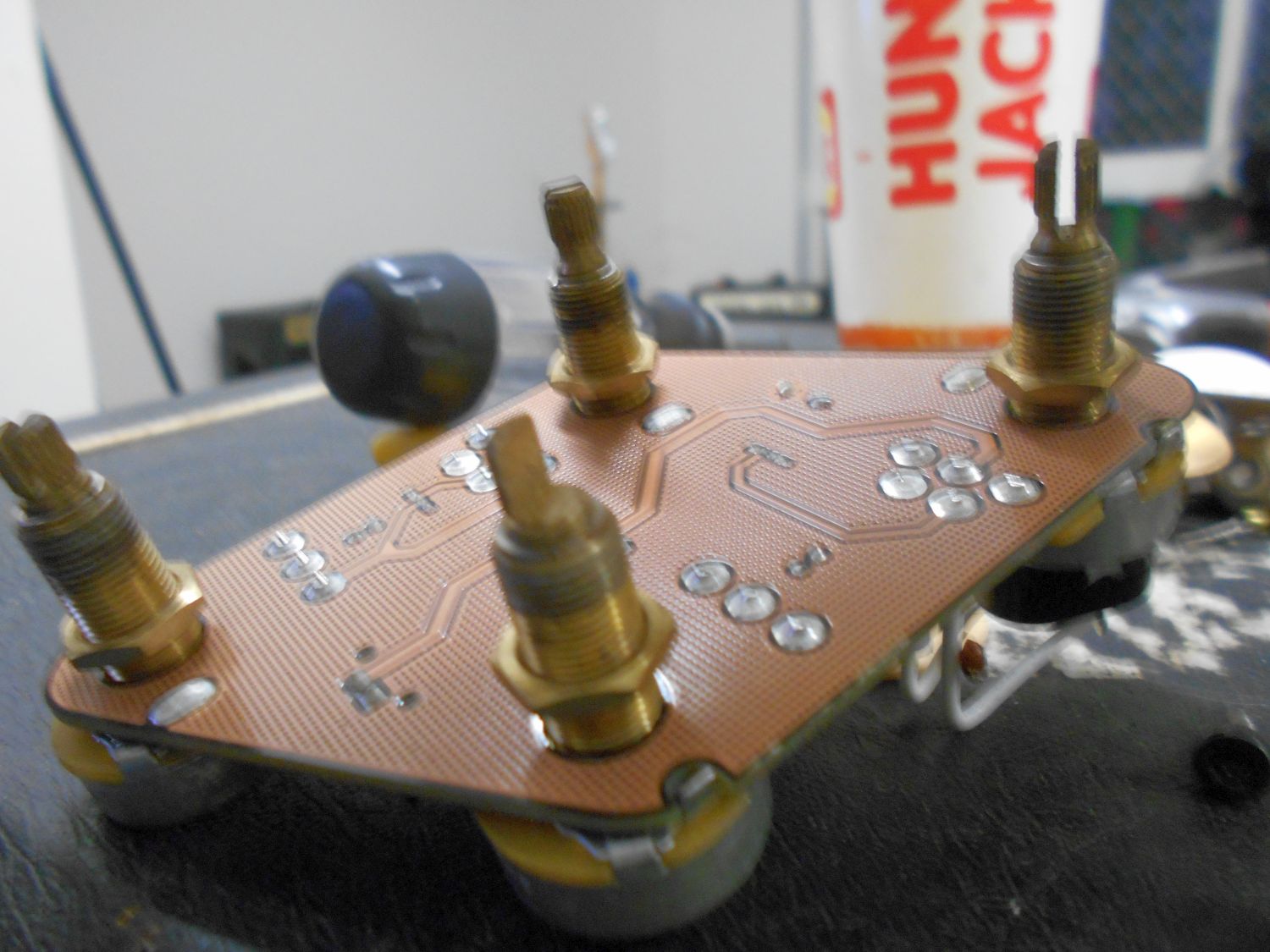

    Here's a pic of the broken tone control pot, notice how one half of the splines has broken off from the shaft?, I've managed to find some replacement pots on the Realtone Music website and have ordered them:
Name:	Broken Tone Pot_resized.jpg

    The four new replacement pots turned up in the post earlier this afternoon so I've been working on getting them installed and soldered to the circuit-board in the LP Studio, the CTS pots I ordered proved to be practically a drop-in fit, they all feel really nice and smooth in operation with no grittyness, anyway, just gave the LP Studio a quick play test and all the electronics worked perfectly first time, so I'm happy now, the knobs fit perfectly on the pot shafts too.
    Looking at it on the outside you can't even tell that the pots have been replaced, I'll post a pic of the guitar soon.
