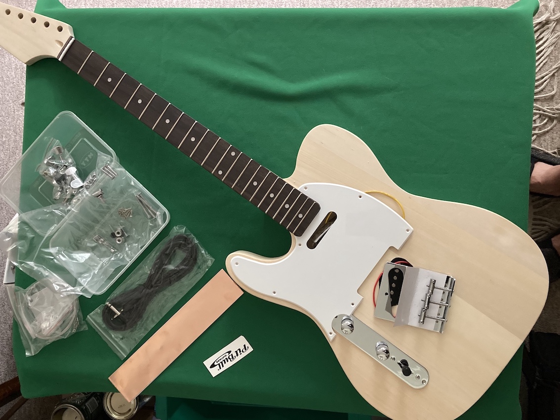

    Out of the box it looks really good, the body is free from any major marks and everything just about fits, with the neck and body fitting well together. I haven't opted for any extras as I thought I would get it built first and then do some upgrades at a later date.

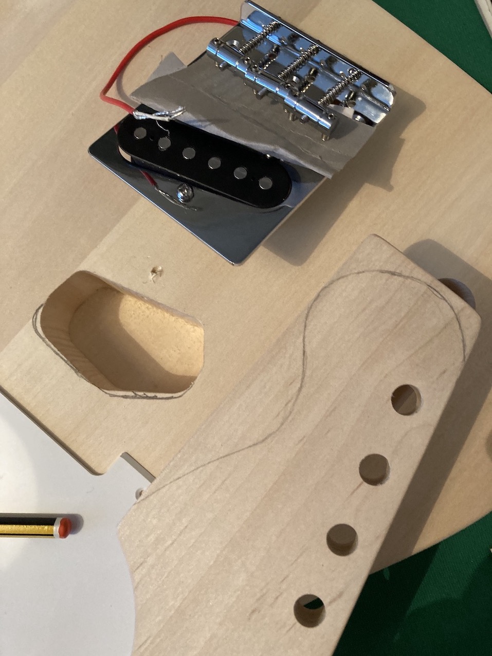

    First job was to get and read the instruction guide and I have since been watching numerous how-to videos on Youtube. I have pencilled on a possible enlargement needed for the bridge pickup routing and a headstock shape but have not taken a tool to it just yet.
    One question I am puzzling over, as a complete novice, is whether this is meant to be a 'toploader' or 'through the body' as the bridge seems to have 2 lots of 6 appropriately placed holes where the strings could be threaded just to the back of bridge or down through the body, I don't see any attachments to create a secure through-the-body hole, but I may be mistaken. I certainly don't want the strings to rip out the bridge when they are tightened. (I do own a Takamine Acoustic and an Epiphone Les Paul but they are obviously fitted with different style bridges).
    I'd appreciate any pointers on this.

    The Pit Bull Tele kits have traditionally come with top-loading bridges. The exact hardware supplied changes from time to time depending on the factory and they seem to now be using a bridge that can both be top- and rear-loaded. So the kit itself is supplied as a top-loader (as it's missing any pre-drilled through-holes or rear string ferrules) but for a small outlay you can buy some ferrules and drill the holes yourself if you want rear loading.
    The factory not drilling holes makes it easier for a builder to use their bridge of choice, as there are normally dimension differences between modern- and vintage-style bridges (with some designed on metric and some on imperial measurements). Of course that makes it a little bit harder for a builder who's happy to use the kit bridge but would like rear-loading.
    Yes, those bridge pickup routs usually benefit from a small amount of enlargement. A sanding drum on a Dremel works well for that if you aren't handy with a router.
    Keep the saddles in the position shown when measuring scale length for bridge position. The 'set the saddles mid-way' advice you may have seen isn't right, and can lead to not having enough room to move the saddles back for intonation. If you've had a Tele or know about them, then you will be aware that there should be a 2-3mm gap between the pickguard and the front of the bridge plate, they don't butt right up.
    Hope your build goes well, post pictures and don't be afraid to ask questions. We're here to help.

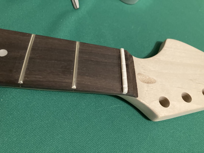

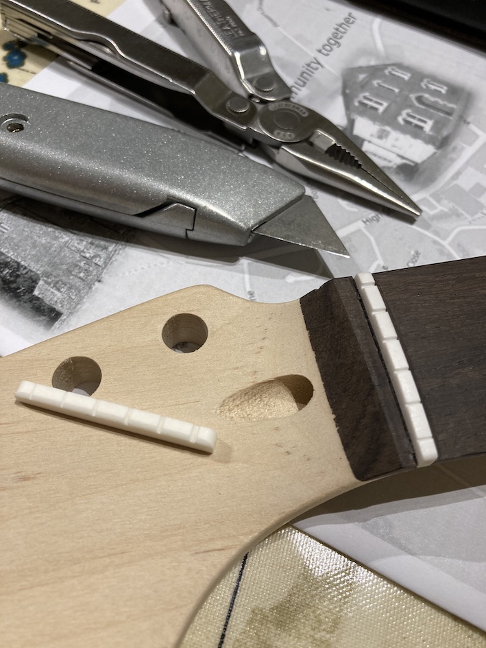

    This week I've managed to level the frets and swap in a bone nut for the plastic one, the bone one I ordered was 'right handed' so I've added a bit of bevel on the fretboard side to blend it in.
    I loved the transformation that the wire wool brought to the frets after re-profiling.

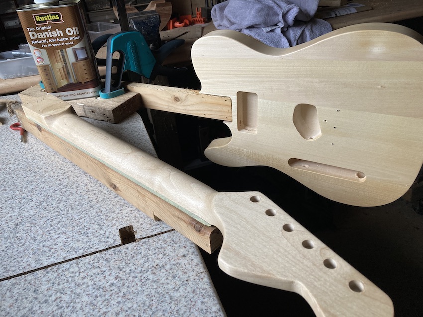

    I've now begun adding the finish. I've gone for something simple and straightforward this time, just multiple layers of Danish Oil that I had left over from a recent furniture restoration.
    I warmed the workshop, wood and oil for the first couple of coats and it seems to be going on fine, looking especially good on the maple neck.
    I'm happy with the body look, I decided the different grains probably look better than if I'd tried to stain it all over.

    Having a look at your fret photo, there appears to be a small rough area on the first fret, though it may just be a reflection.
    Unless you remove all the cross-fret marks from levelling, you'll get very scratch feeling frets. When checking my fret polishing, I take an offcut of a top E string, hold it between my thumb and first finger and run it along the top of each fret. If it catches at all (which you can easily feel), then your strings are going to do the same. There have been several times when I've finished the polishing, done the test and still found that the string end catches. Then it's back to the P240 and rubbing along the length of the fret until those deep nicks have disappeared and running up through finer grits until they can be polished. The current kit guide skips out the coarser grit part and moves straight on to the polishing (making some assumptions that few inexperienced people will make), but wire wool alone will not remove the deeper cross-fret marks.
    I use P240 as my primary scratch remover grit, rubbing each fret the same number of times with it to help keep the heights equal, and then stepping up through a few strokes each of P400, P800 and then through my micromesh grits selection. I always go up to the final 12000 grit micromesh, but 4000 is really fine enough. The rest is just to make the frets look shinier. For a final polish, if I've still got the fretboard taped up, I use a metal polish, normally Autosol, though Brasso works just as well (if a bit messier in liquid form).
