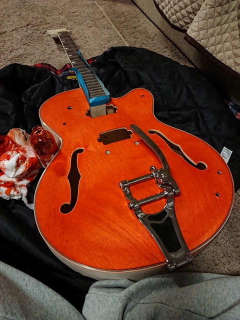

    hopefully this works....
    first pic shows how it looked after staining

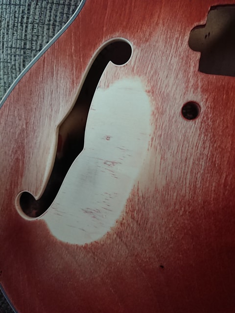

    other pics show the mishap and what ive done so far to relic or age it/save it haha
    im going to clear coat and again rub through in the areas
    worst case scenario i will have to paint a solid colour

    more pics let me know what you all think thanks

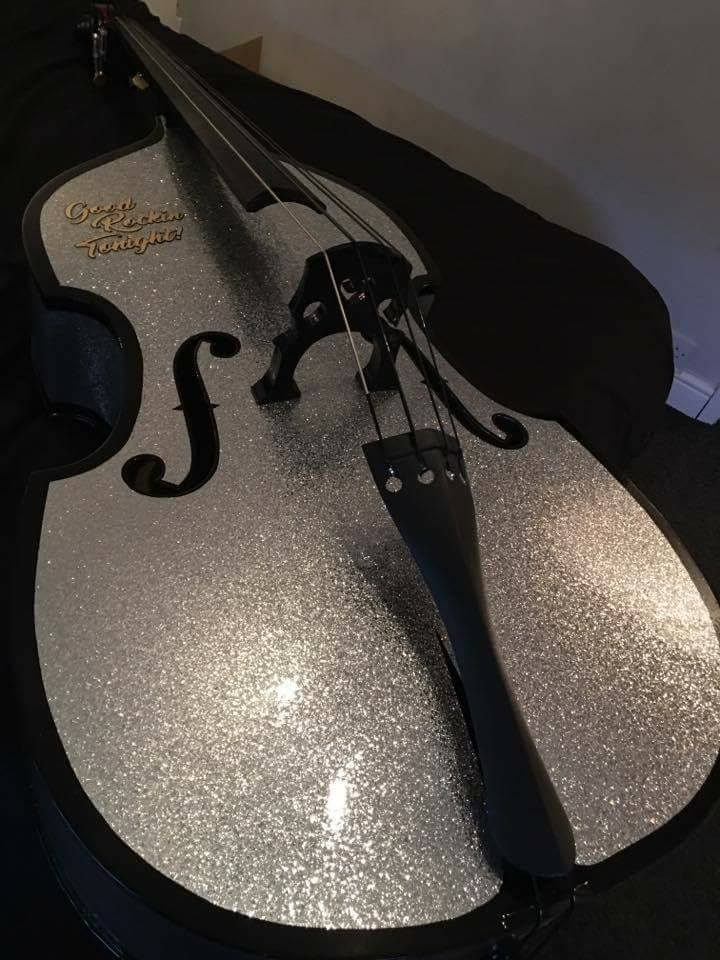

    im hoping clear coat will make the orange pop like the first pic when wet, may even metalflake it like i did to my old bass

    It doesn't look that bad in the pictures, but it's really about how you feel about it. It's never going to look perfect. Another coat of orange stain might help cover it up but I do think it's going to be quite noticeable.
    Yes, clearcoat should make the finish pop.
    But if you can make the effort to do a metalflake like you did on the bass, then I think you could make it look spectacular.
    You'll need to seal the wood, then sand it flat again, but that's not a complicated or long process.
    the paintwork is not a problem ive been a custom painter body repairer for years, just wanted to try something different out of my norm, i think ill clear it first and see how it looks, then go from there
