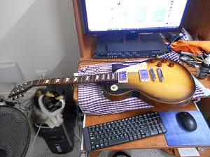

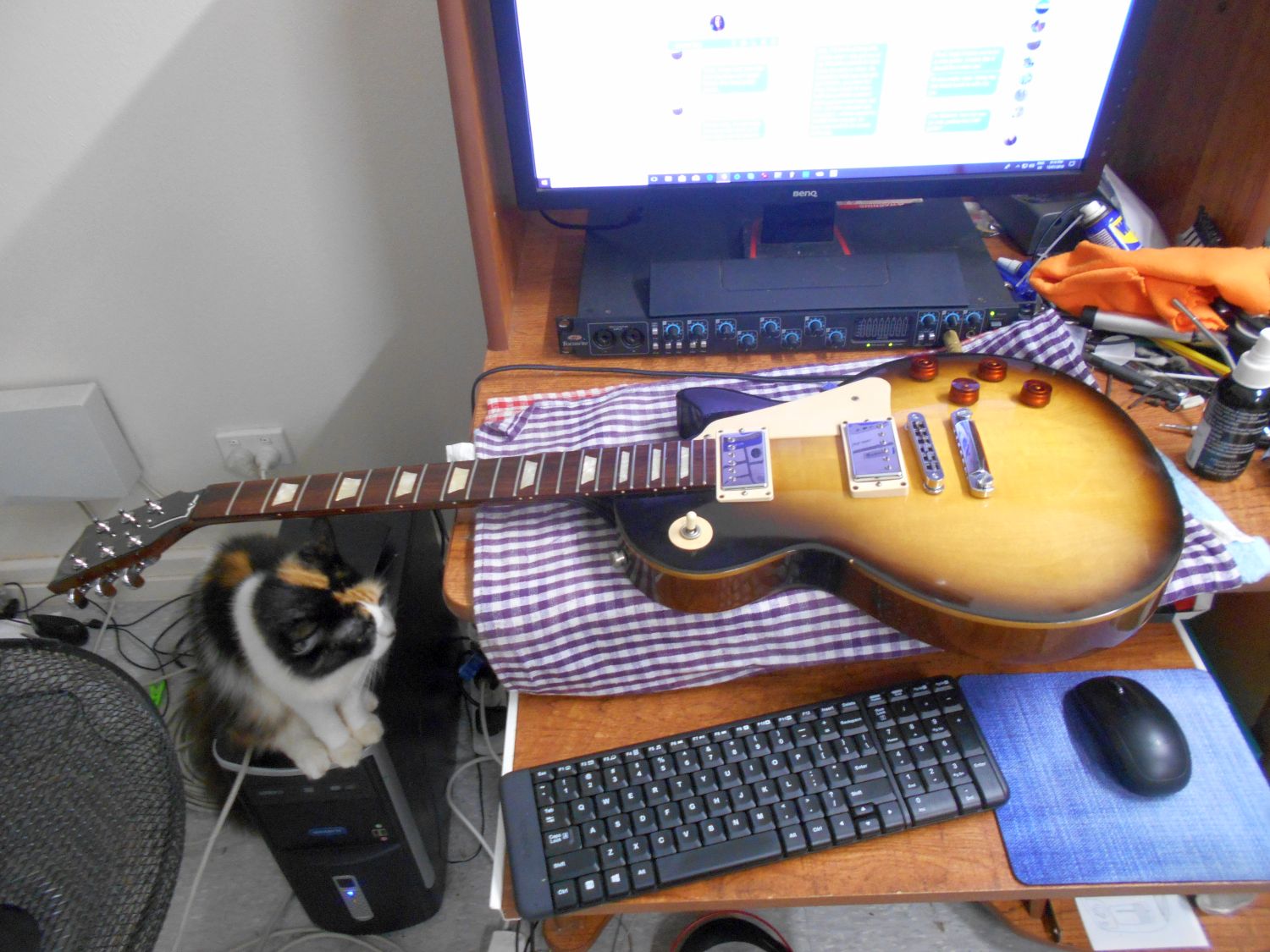

    Yeah, I share the same sentiments, I'm thinking that the reason why the LP Studio sounded so great through the Marshal was due to the pickups installed in it, they are genuine Gibson pickups, their 480 and 490T (think that's what they are) PAF Humbuckers with the chrome shields on them.
    Here's a pic of the LP Studio guitar sitting on top of the wooden computer desk in my loungeroom, you can see my cat Holly sitting on my computer case, telling me that I'm doing it all wrong...she's my biggest critic....lol:
