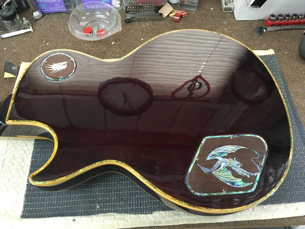

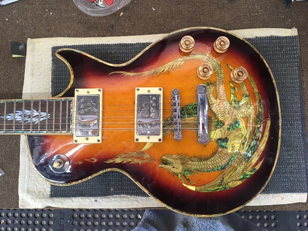

    I had this guitar come in for a set-up. It's quite interesting. A no-name LP copy 12-string apparently from Korea.
    The story the customer told me is some dude in Korea buys no-name-MIK guitars and does custom inlay work on them and then re-sells them.
    I have no idea how old it is, but it has not been looked after and whoever cut the nut should have the files taken away!
    Whilst the inlay work is interesting some of it rough as guts. However since I have never done any inlay, who am I to judge. It still looks pretty cool and definitely a one-off.
Name:	Dragon LP fnt.jpg
    It was an absolute dog to play (not helped by the most horribly corroded strings you'd have ever seen). Stupid high action, stupid high nut, over-relieved neck. Pretty basic stuff to fix but no one had taken the time to address any of it.

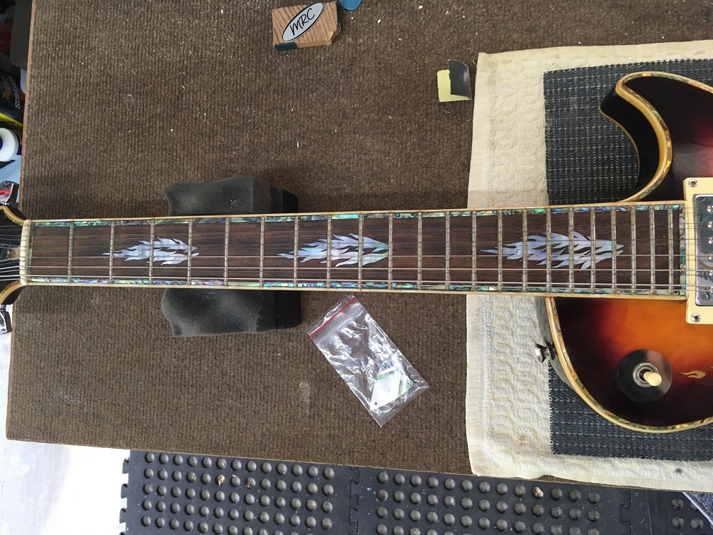

    Frets were actually in pretty good nick apart from badly tarnished and two high ones.

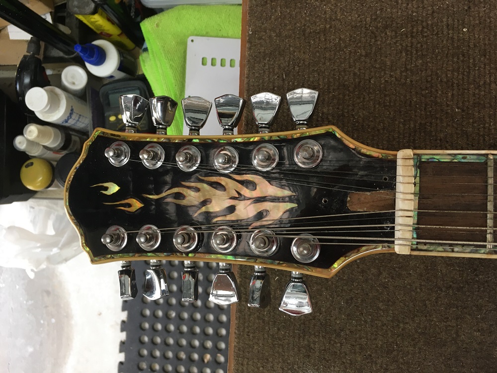

    The owner didn't want to spend much on it so wouldn't spring for me to cut a new nut, so I had rework the existing one as best as I could. Fortunately most of the string slots were too high, so lowering was doable. However the spacing appeared to have been done by eye (and not a good eye) and I think with only one size file! Pretty shocking.
    Tuning is a real PITA due the spacing of those as well. Hard to tune one without bumping another... errrrggghhh!
Name:	Dragon LP hdstk.jpg

Name:	Dragon LP back.JPG
Name:	Dragon LP fret.jpg
