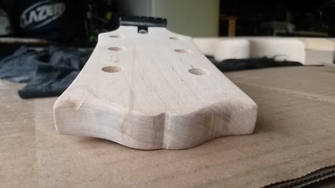

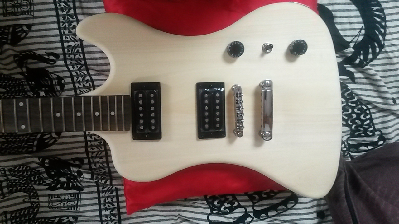

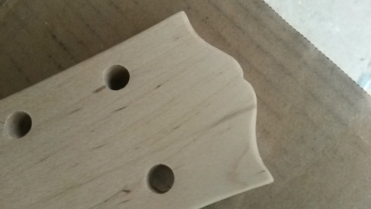

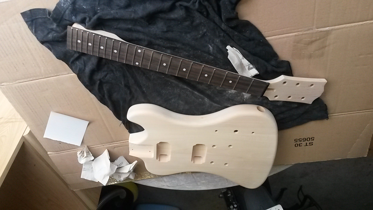

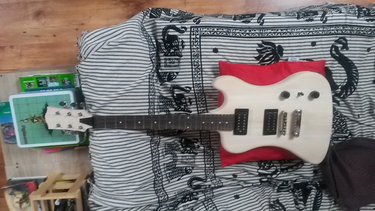

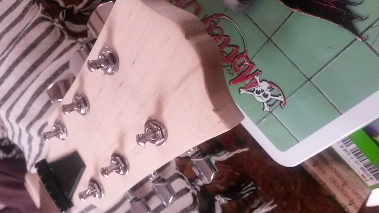

    I first did a mock build; The first thing I noticed when I opened the box, was a minor scratch on the Headstock, still big enough for me.
    The rest of the build was pretty much OK, just the holes to fix the neck that aren't really square, and I had to take off a bolt to fix the switch.
    The next day I started to sand the guitar, and it turns out that I almost fix the scratch on the headstock. you can still see it a little, but not feel it when your touching. That makes me pretty confident.

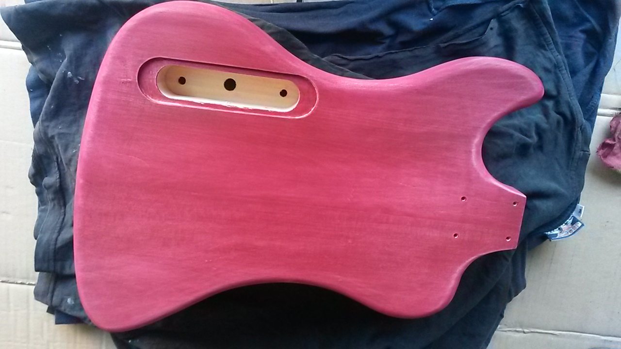

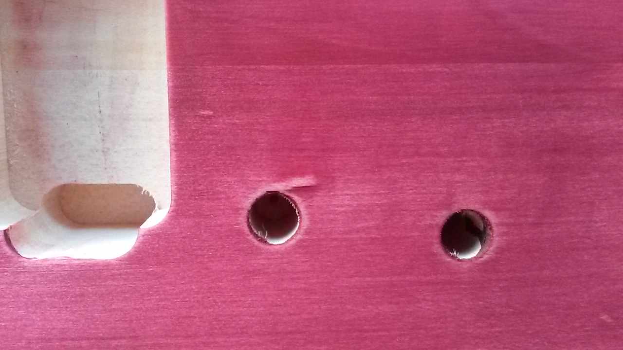

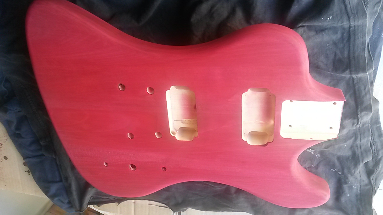

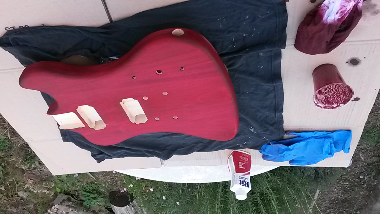

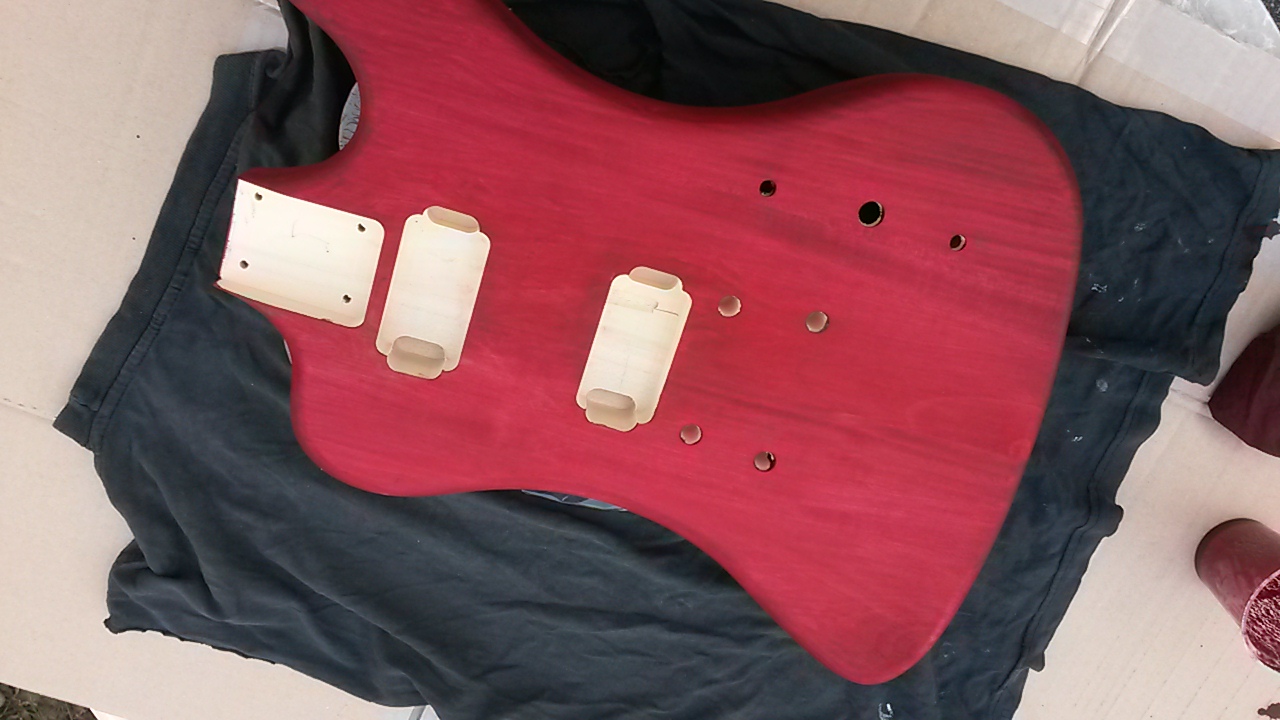

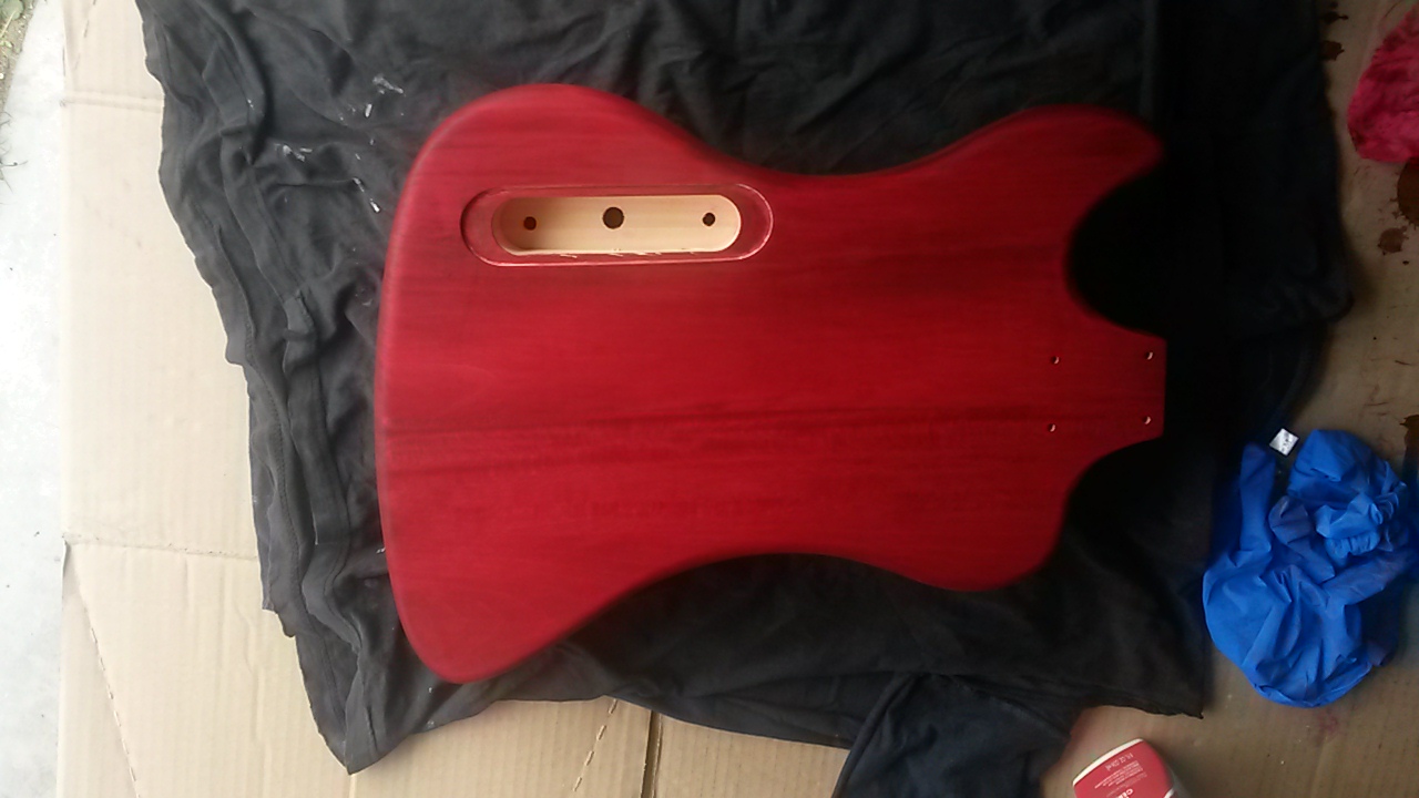

    Couple days after, I started with the dye. I mixed it with warm water and apply on both sides, starting with the front, let dry for about 1 hour, and did the back the same way.
    Next day, I sand using 400 sanding paper, apply another dye layer on the front, and let dry an entire day.
    Today I did the second dye layer on the back, and I can't wait for tomorrow to see if I need to sand a little , or some more, and apply the red dye one more time.
    Picture of the mock build :

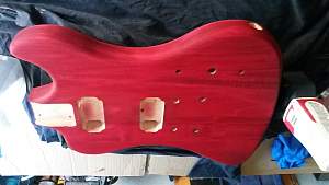

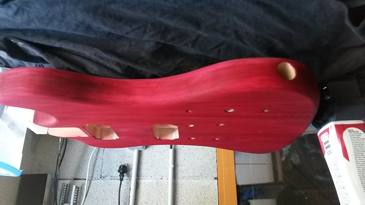

    Applying Rit Dye

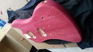

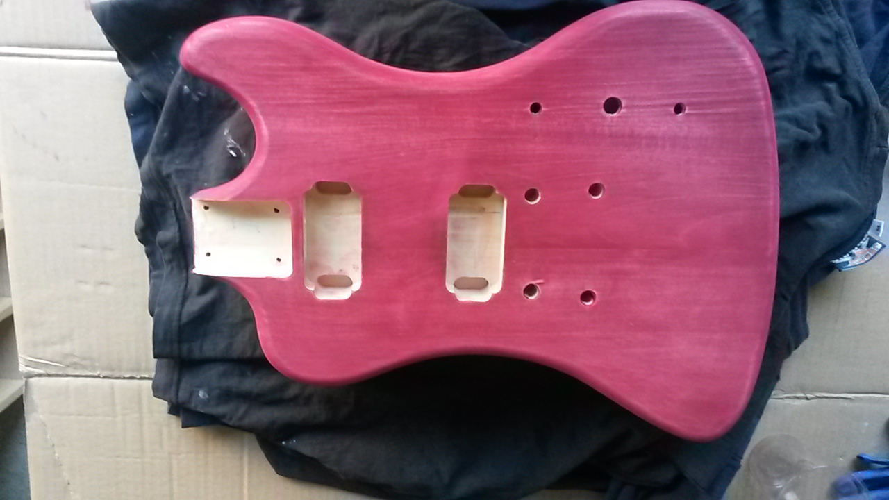

    Then sand once again

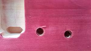

    A strange little thing happened:

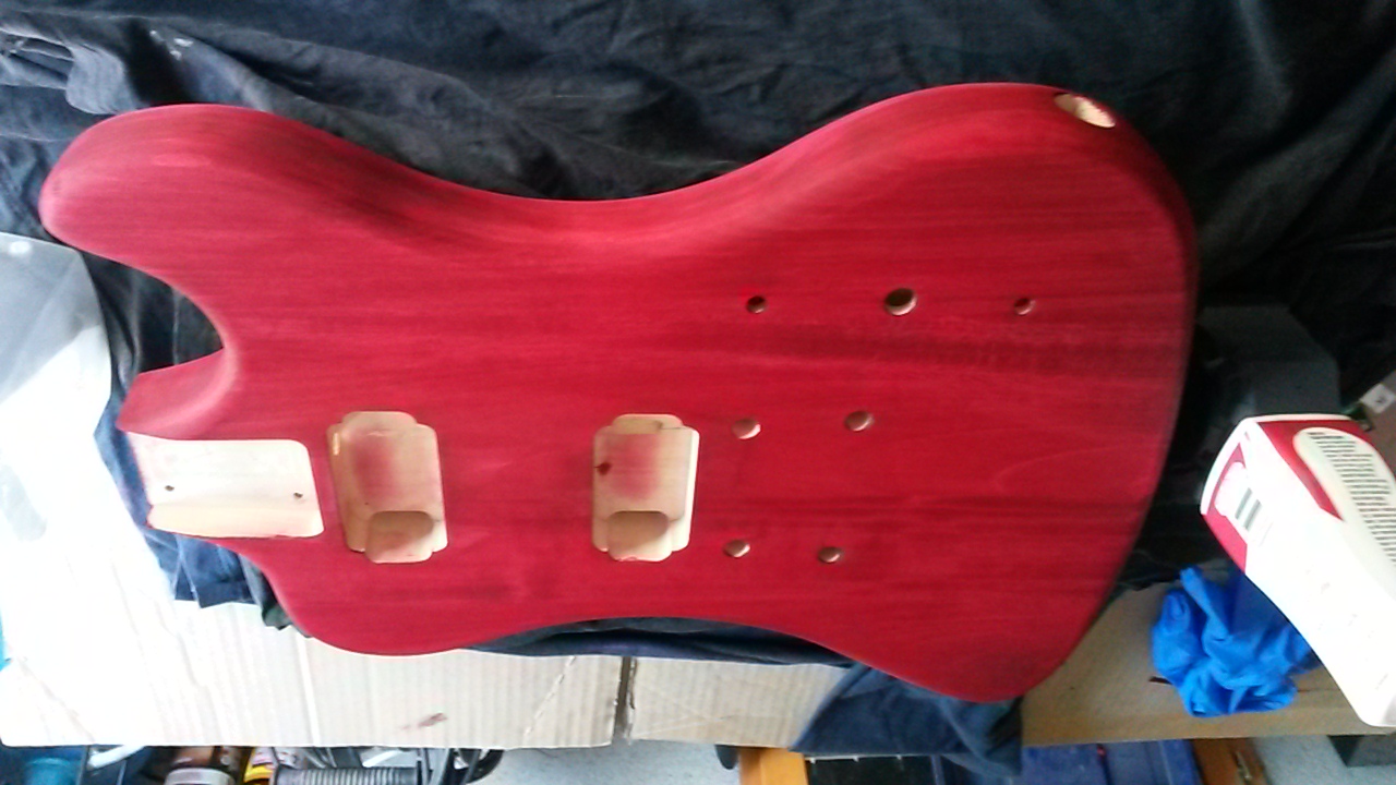

    Back

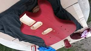

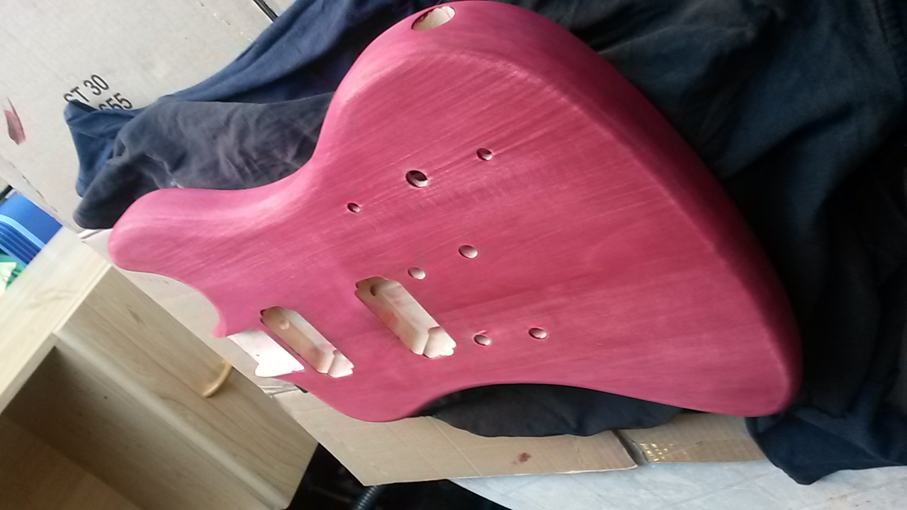

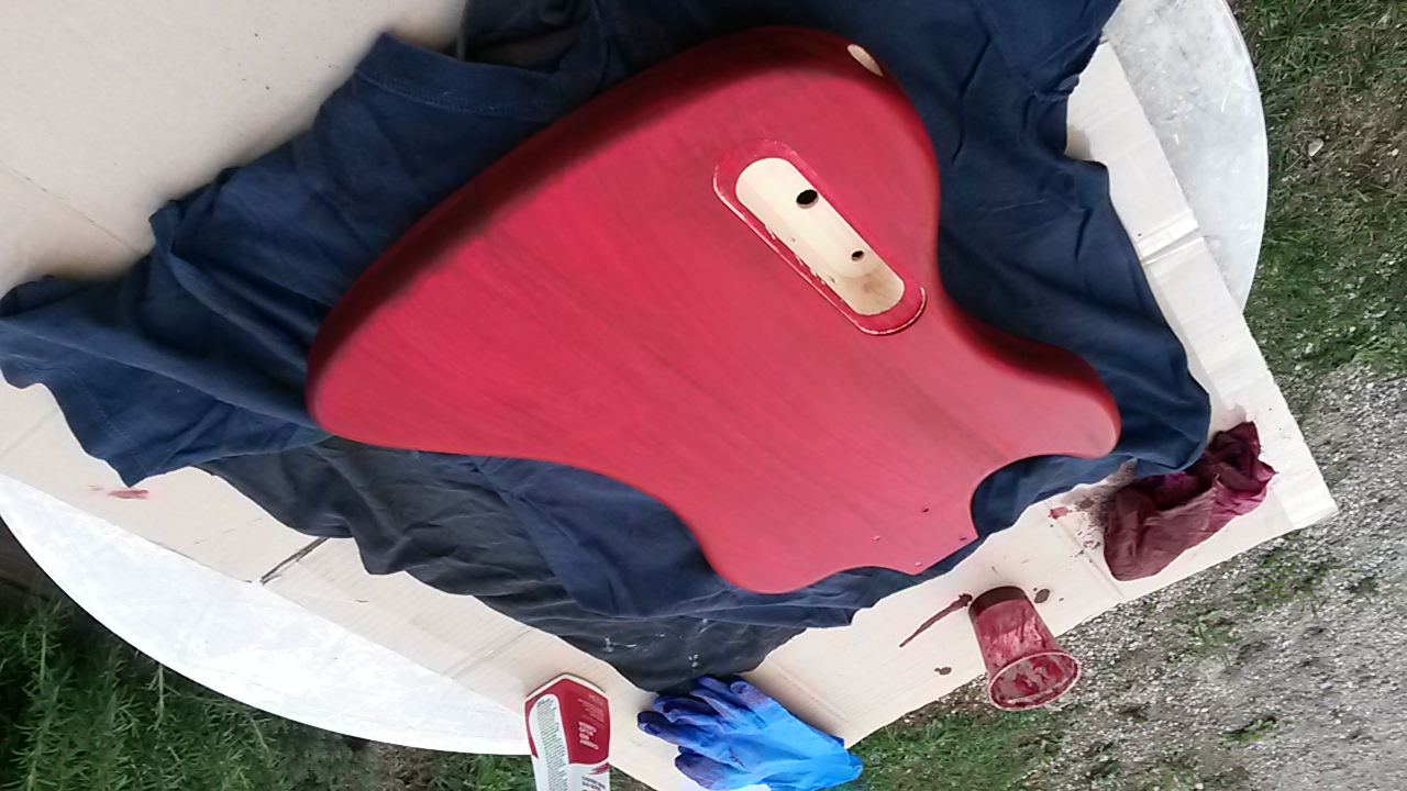

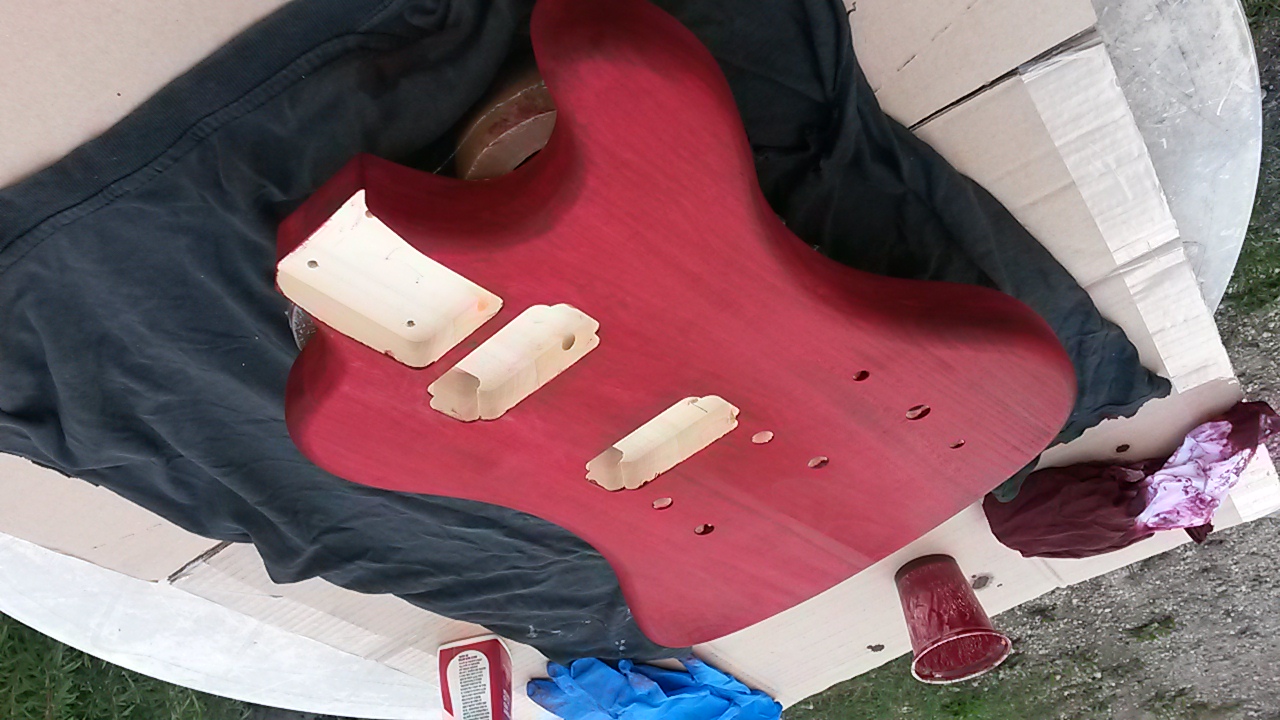

    Second layer on front :

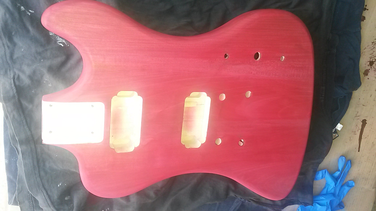

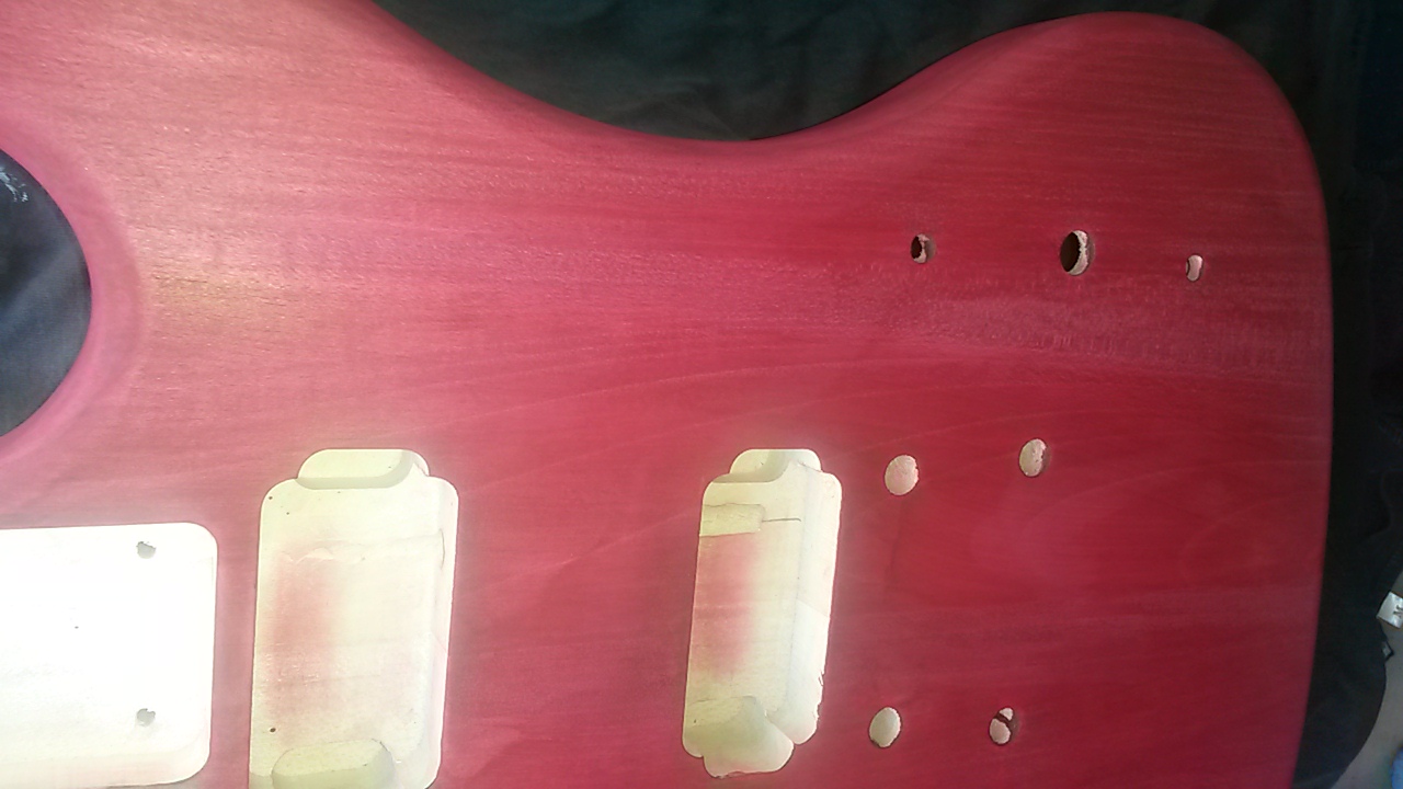

    next day when it's dry :
    I think I need to sand a little

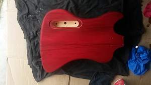

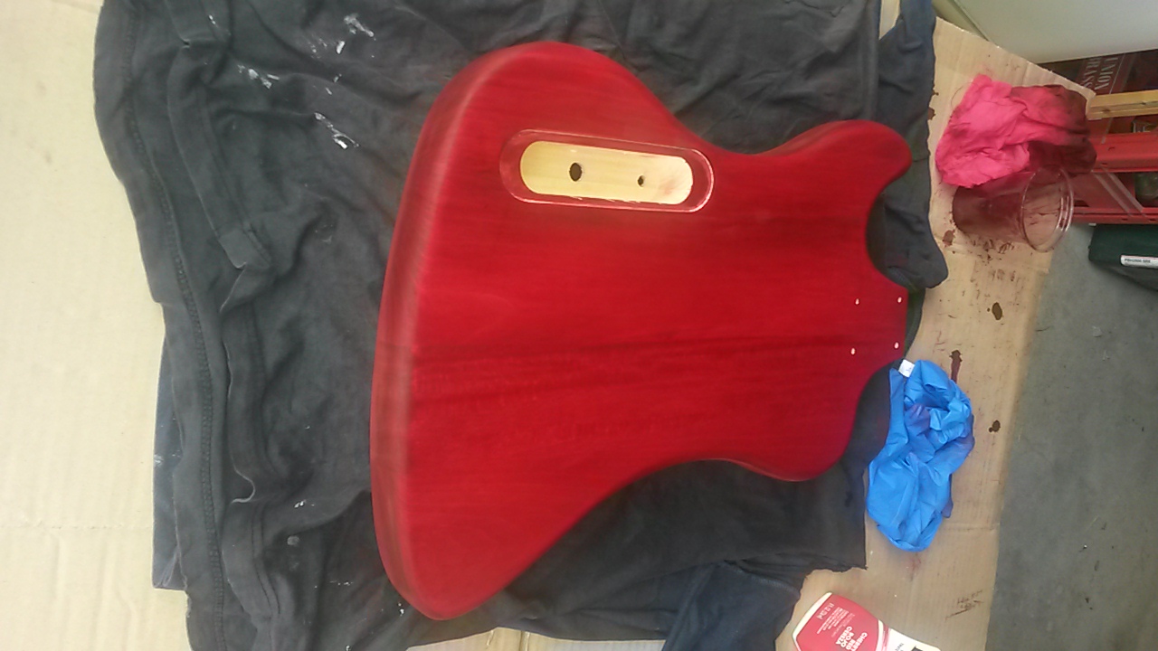

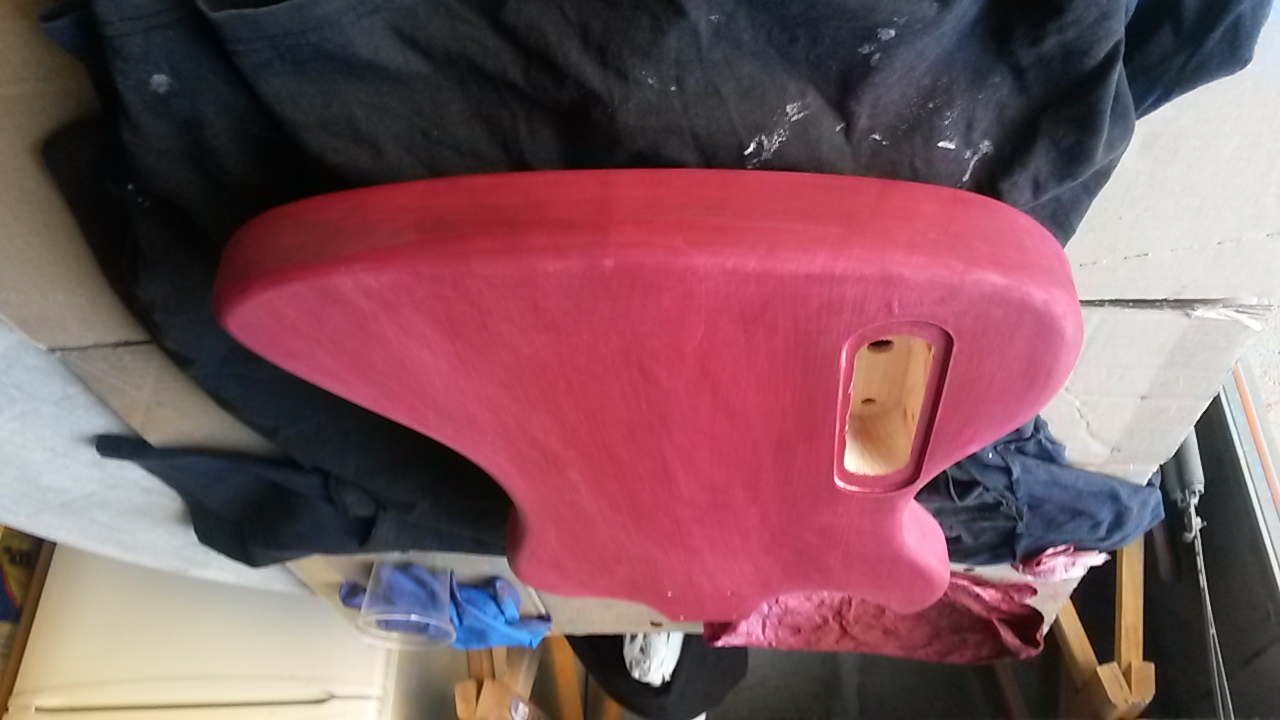

    And second layer in the back :

    I presume that it's a water-based dye that you are using? Water makes the wood grain swell up so any loose wood fibres start to stick up and the surface will always need some sanding down afterwards. If you've got a small scratch in the surface - like you have near the post hole, then the expanding wood grain will push the ends up and make it more obvious.
    Otherwise if you've read some of the other build diaries here, you'll know that a wood surface doesn't like to be sanded with too fine a grit sandpaper otherwise there can be issues getting the dye to take evenly.
    I would just keep applying the dye until you are happy with the colour.
