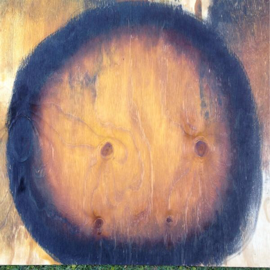

    Practice staining a burst and testing my IT skills to see how I go resizing and uploading photos.
