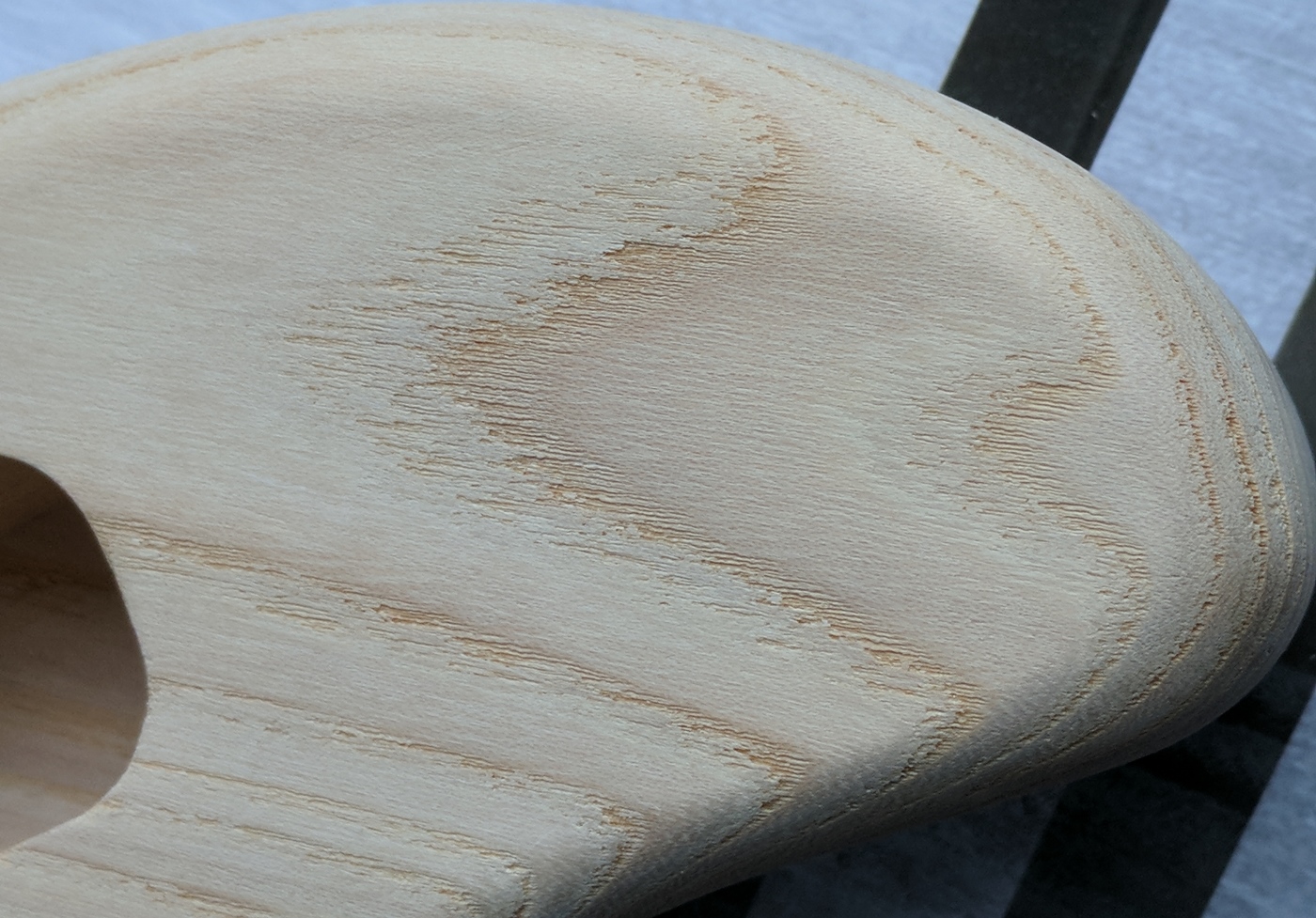

    Just wondering if DT finish will act as a filler or binding agent for any sanding residue that collects in grain lines.
    I air blasted my Ash body after final sanding (with 400 grade) to find that previously filled grain lines were no longer filled.

    If I re-sand and rub with DT will the base coat (or other coats) bind any captured dust into the grain micro-crevices ?
    Hi Raven,
    ash grain really has to be grain filled as its such a coarse grain. Get some Timbermate and mix a slurry with water and apply. I wouldn't think the DT will bind much of the fine sawdust so best air blast the body when you are ready to stain
    Timbermate is definitely the way to go with regards to grain filling, as Wokkaboy says, make a slurry that's about the consistency of a milkshake from some Timbermate paste, then cover the whole body with it and give it time to dry, after that sand it off down to bare wood and then it should be ready for applying the Dingotone finish, and make sure you give each coat of Dingotone plenty of time to dry before applying the next coat.
    Dingo Tone has quite a watery viscosity and therefore zero grain fill properties.
    Timber Mate is an easy grain filler to work with and can also help to pop the grain too.

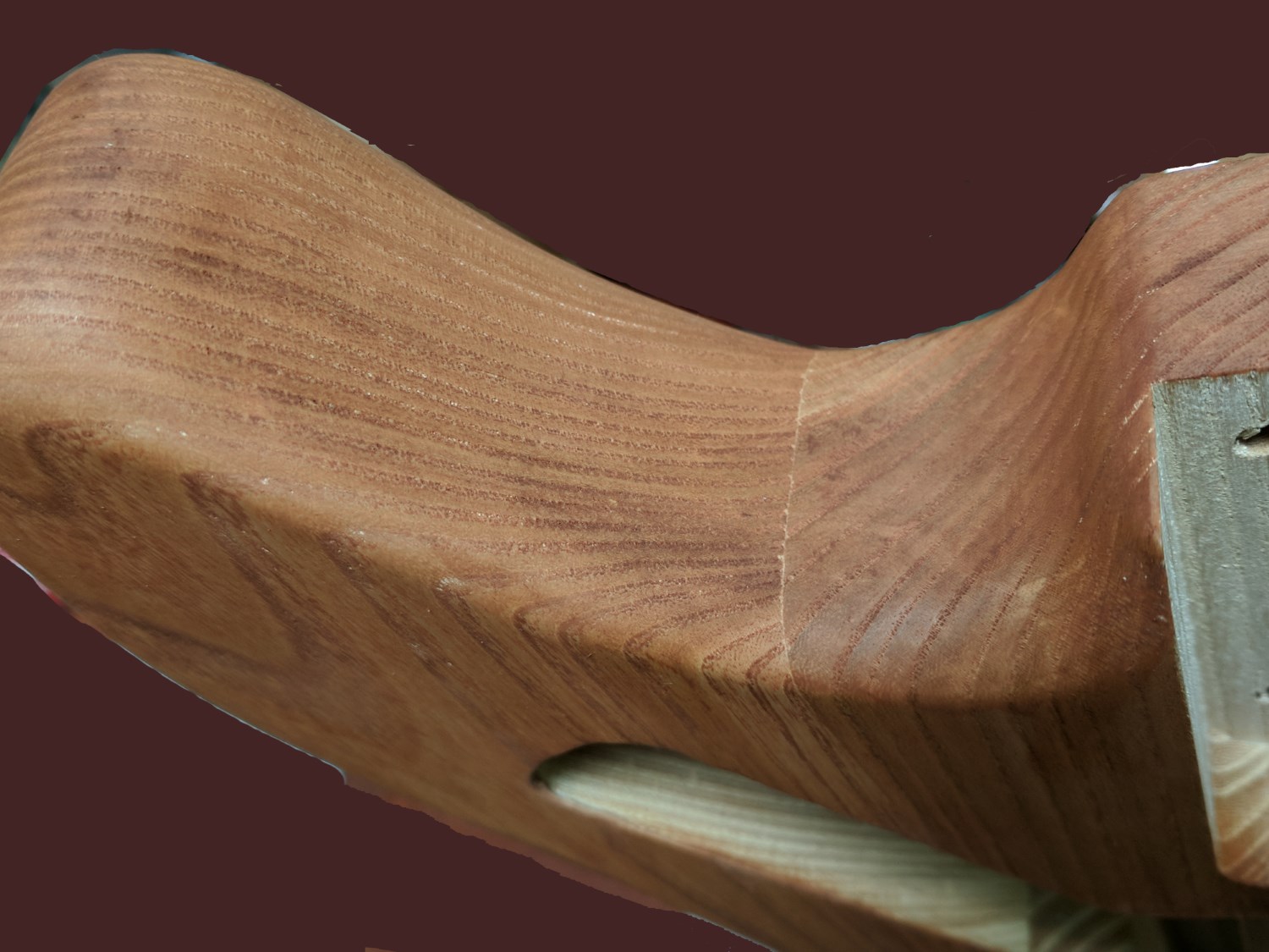

    I put on a base coat of Nullarbor Ochre onto my JMA-1 body and having given it about 3 days to dry have found that it did not hide the seam/glue lines or other glue residue marks on the body. My prime question is about whether enhancer or top coats will add any hiding power.
Name:	Glue seam_1-1.jpg
    Other question is if I were to apply another base coat how much darker would it become? Would re-sanding first be the way to go to improve consistency and remove what might be filler blotches or other imperfections ?

    Unfortunately those glue lines are quite common and hard to disguise.

    The glue line will show unless you attack it a bit more with some sand paper then re-stain.
