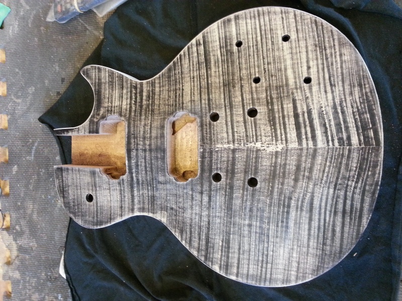

    Hi TYS, ask any questions you have here and we can help you out. Would be nice to see a pic of the kit and I'm keen to see the flame maple veneer to see if it's worth staining black first to pop the flames.
    Here's an example of a LP-1M kit I did before staining
    Wokks did you do that by soaking the black up with a dry rag or sanding and what stain did you use?
    Hey Andy I covered the whole veneer in black stain and carefully sanded it back to achieve that result with a sanding block and probably 240 to 320 grit paper. That was about 3 years ago that build. I used FW proof tint black which is darker than Japan black - lucky DB doesn't read many posts these days haha
