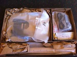

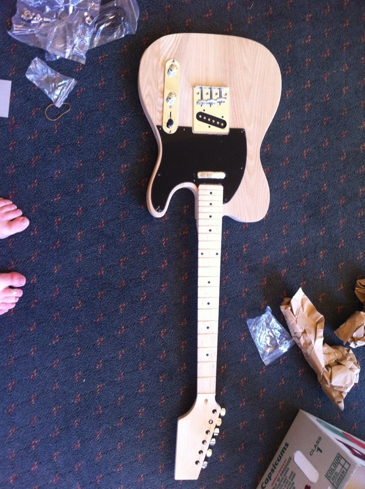

    With great excitement I found this underneath the Christmas tree yesterday morning. Very excited to get started on my first ever build.

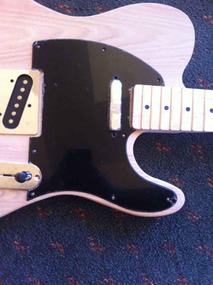

    Dry build done and all seems to be okay, just pickguard a bit small around neck as pictured (considering getting a tortoise-shell one anyway, so hopefully not an issue).
    Any early tips before I get onto sanding?

    No tips from me since I'm pretty new around here and getting a feel for it all, but welcome aboard. I'd be very excited to have found one of those under my tree too.
    Welcome Moo. Take your time, ask lots of questions, have a look at other TL build diaries, think about what finish you want before you start shaping and sanding, and have a look through the How to Build... thread (and that section of the forum). Good luck and enjoy.
    Awesome Moo, welcome aboard!
    First up, if you haven't done so already, check your scale length to the centre of the 12th fret, this will dictate where your bridge goes as it's twice that measured distance.
    Then use some temporary double sided tape and plonk your bridge in place, pop your tuners on in the two E strings positions. Plonk your neck in place and either clamp it in, or screw it it in and string up your 2 e strings to check the alignment of neck to bridge. You should have a consistent gap from each string to the edge of the board. Fit it's off either way then this will show it up and you can adjust accordingly.
    This is also the best time to see how your action sets up (strings height above fret board) and determine if you need to do any work on your neck angle.
    What are your finish plans etc?
