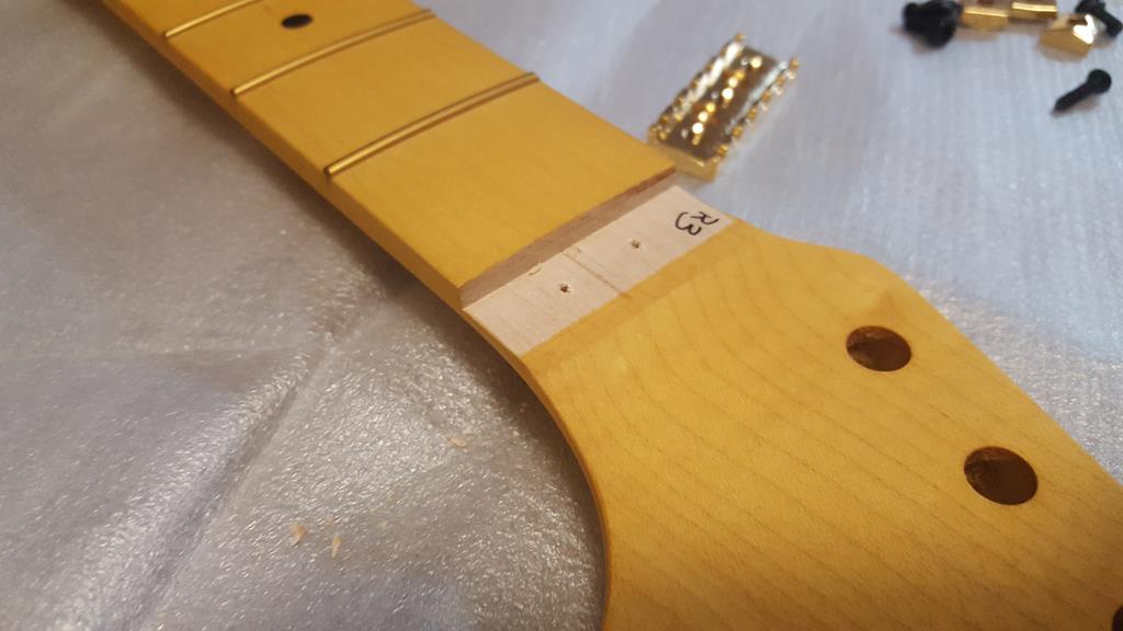

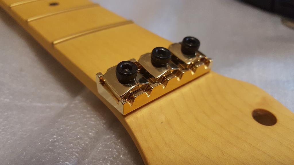

    I'll switch to the neck to answer the good Dr.'s question. After dealing with a crappy neck on my previous Les Paul kit build, I decided to order a Warmoth neck for this project. I found a good one in their in stock section that fit the bill: maple, Floyd Rose nut shelf, vintage tint nitro satin finish, gold fret wire to match the hardware.
    The gold Floyd Rose trem I bought came with the nut, so I was ready to go when the neck arrived. It was a top mount nut so I pre-drilled the mounting holes and fastened it on.

    Unless I decide to add a logo, the neck is ready to go. I just need to finish painting the body, which was rudely interrupted by winter. I need to find a good indoor painting location so I can do finishing year-round.

    sexy looking neck Cascadia, love the gold frets, locking nut and tuners. Never heard of staggered tuner post heights, I'll be interested to see if they don't need string trees
    Nice. I like the mock up and the relic plan seems a good one, that's a beautiful neck, look forward to seeing how this goes!
    I've got a set of six gold Sperzel Locking-tuners on the neck for my Gold Strat, they have staggered-height posts on them, and yes, they do eliminate the need for string trees, the heights of the posts are staggered so that the low E and A string tuners have the highest posts, the D and G string tuners have posts with heights lower than the low E and A tuners, and the tuners for the B and high E-strings have posts with the lowest heights, this ensures a proper break-angle over the nut without the need for string trees, this goes some way to eliminating tuning stability problems due to friction in the nut slots, and also helps the B and high E-strings to ring cleanly without sitar-buzzing.
