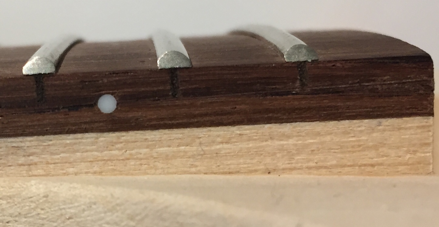

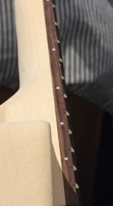

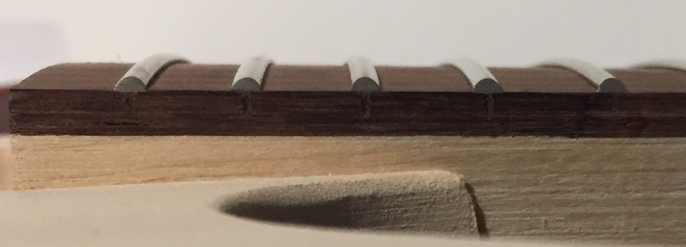

    I recently started an EXA-7 build and I decided to glue the neck to the body early on in the building process. However I believe that I overtightened the clamp, leading a dent in the back but mainly the neck is now slanting back away from the body.
    Will this cause any issues in playability or intonation? If so how can I remove the neck easily?
    Note I had to crop the pictures significantly
    Looks about right for a tunematic style bridge. Can you show us the 'dent' on the back of the neck?
    Jun 2017
    North East UK
    356
    I'm no expert by any means so wait for someone who know what they are talking about to reply, but the angle does look a bit excessive to me from those pics....... is the neck pocket completely flat?....
