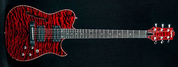

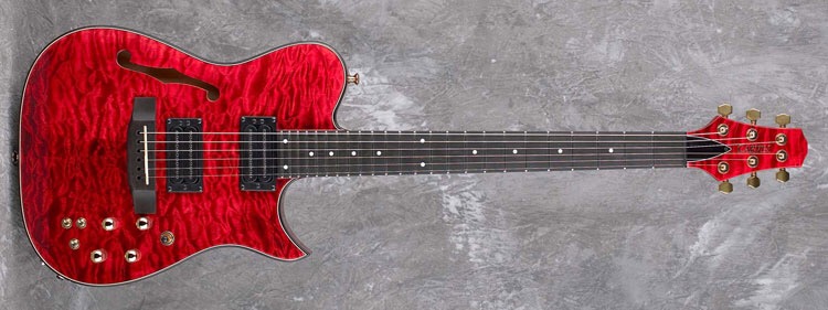

    Hi all,
    I’m looking at getting a ib1 kit very soon and am tossing up between the salted maple or flamed veneer options.
    As these both have a veneer, which I’ve read in the manual is less than 1mm thick I am wondering if I can achieve a finish using red and black water based stain. Kind of like the photos below. I am planning to use colortone stain and truoil over the top for a nice gloss finish.

    I’d love to know if either the spalted or flamed works best and if anyone has any recommendations on methods or products that will help achieve a similar look.
    Thanks

    I've stained all mine and the last one is currently in the finishing stages of tru oil so yes it can be done with no issues because i am not an expert and have managed it.....all my stains apart from one are water based

    Staining is a POC. A very light sanding is required is remove the raised grains that the water based stain will cause to rise up. Plenty of coats of Tru Oil, polishing and it will look a treat. Check out my TLQ-1 in the photo gallery. It was my first staining effort so not the greatest but it will give you some idea. There are plenty of posts here to show some ways to get the result you want. Good luck.
