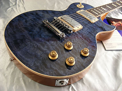

    Andy, I see that Timbermate seems to be a pretty popular option and I agree that it seems like a safer option when sanding back the delicate top but how dark can you get it? I'm aiming for something like this;

    I've been meaning to message Dingobass to see if that kind of blue is possible with Dingo Tone at the moment or if I'm better off using something else. Thoughts?

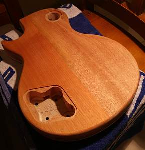

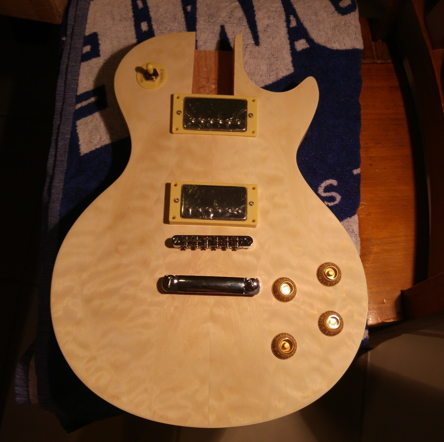

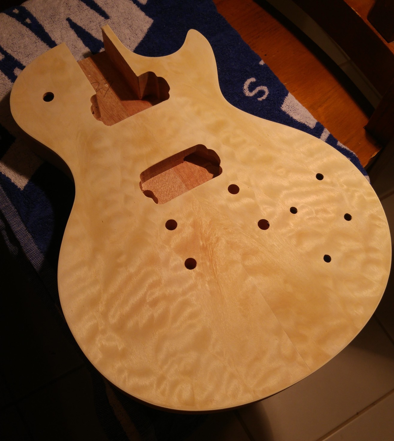

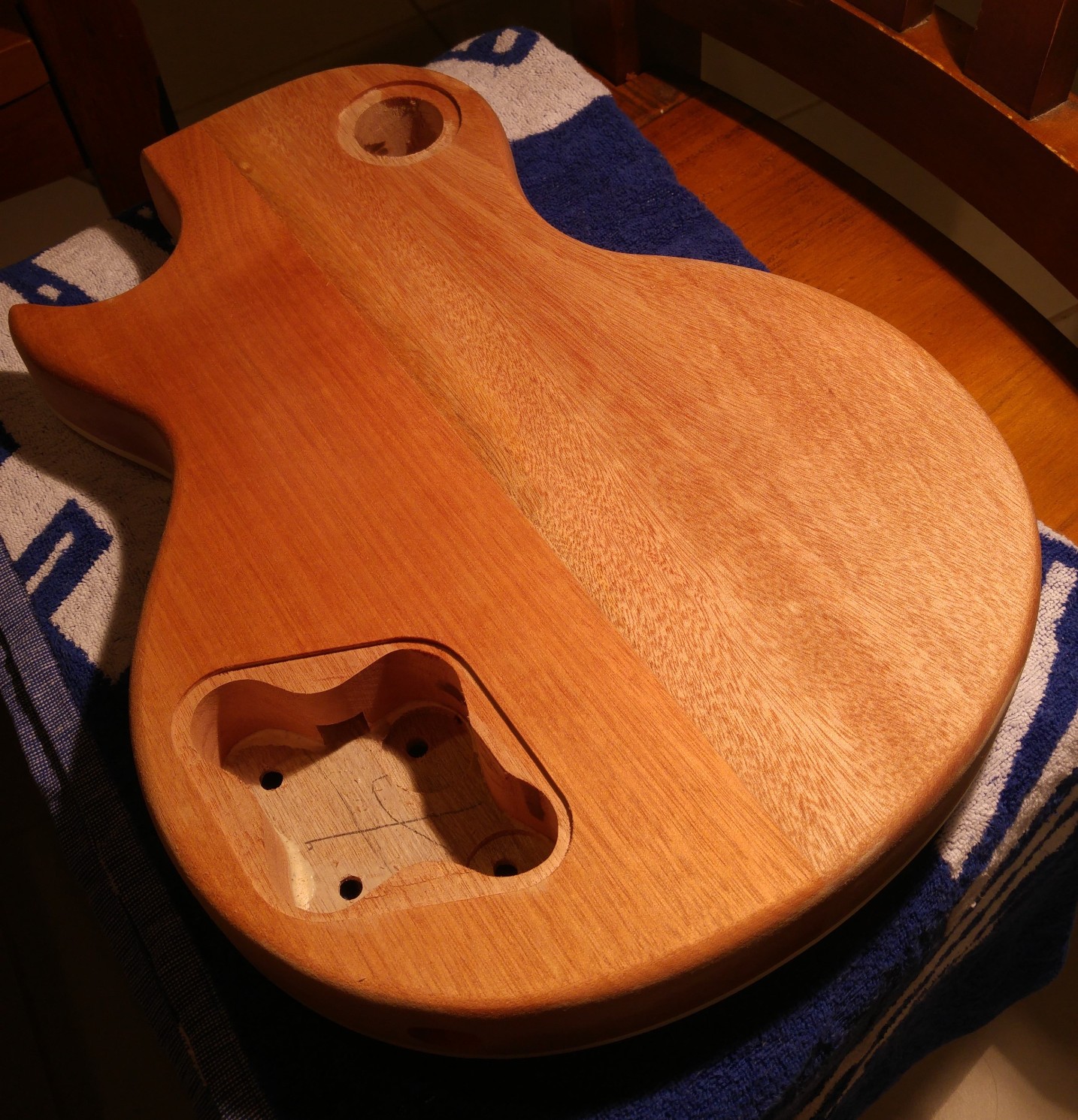

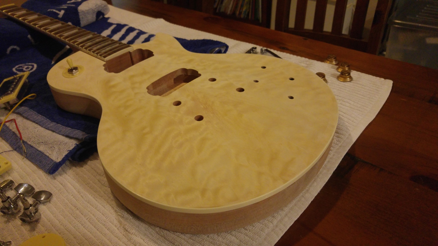

    Anyway, I thought I'd better get some actual work done on the guitar so I did a quick mock build and looked for glue spots over the weekend. Here's some pics of the grain when it was wet down;
    And the back;
    While doing this, I found that finding glue spots on mahogany is pretty easy due to the difference in colour but finding spots on maple was significantly harder. Then I had an idea...
    Tonic water glows blue under UV light. What if I wiped down the guitar with tonic water, shine a UV lamp on it and see if there are any glue stains that way (they shouldn't glow). It's clear so it shouldn't leave any perceptible trace once it's out of UV and I don't imagine it will react with glue, stain etc as it's just carbonated water with a small amount of added quinine. I'll give it a crack on some scrap pine and let you know how it goes.

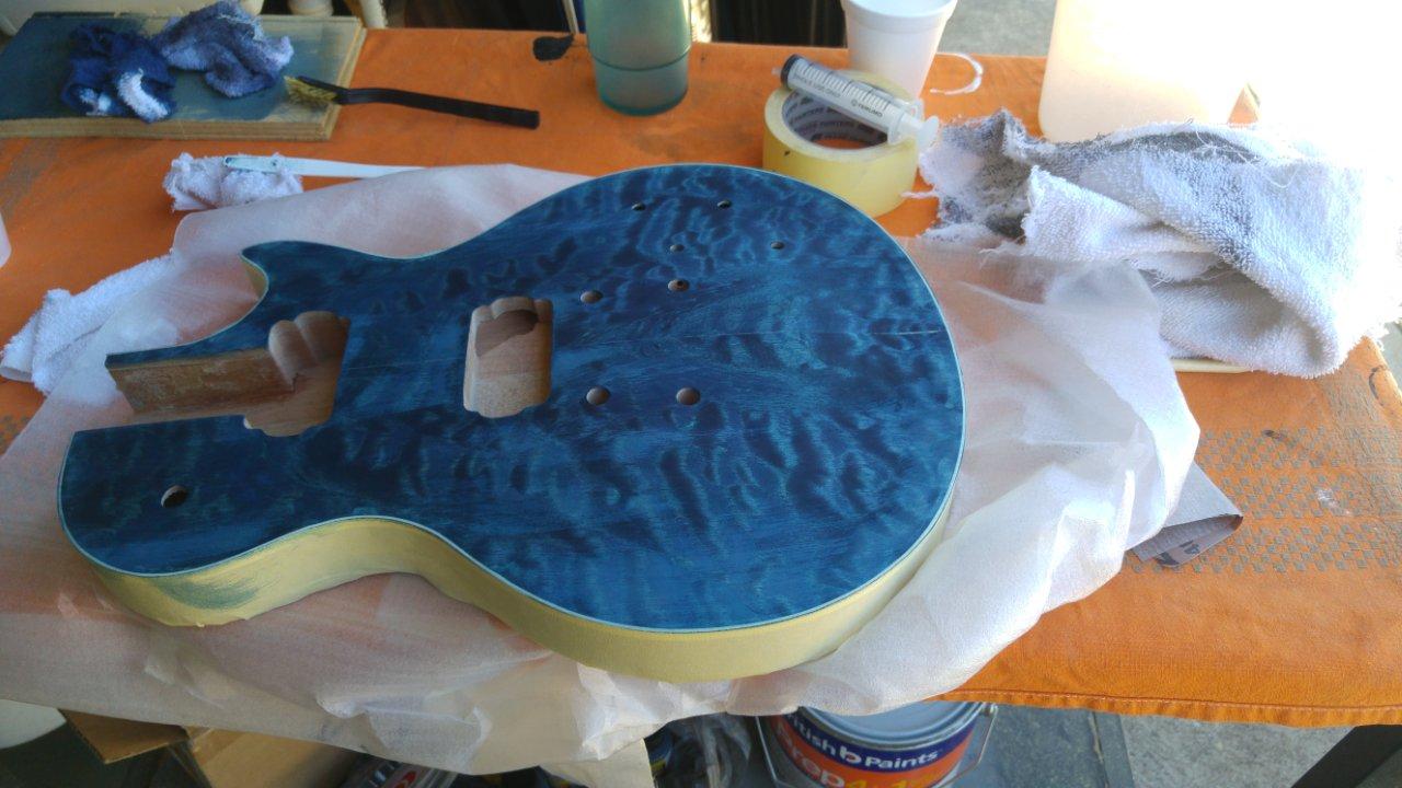

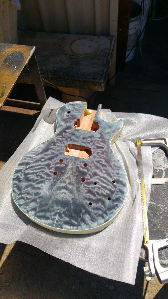

    Hi guys, long time, no post...
    After almost a year of the LP sitting under my bed, I decided to have a crack at staining it today...
    This is the first coat of black to pop the grain.
    Noticed quite a few glue spots around the binding and one in the middle that I had missed previously so I gave the whole body a sand with 400 grit, used a small amount of Goof Off and a brass wire brush and did what I could. Put down the blue coat and ended up with this;
    Still had that while glue line in between the 2 halves of the maple so attempted to colour it with a marker.

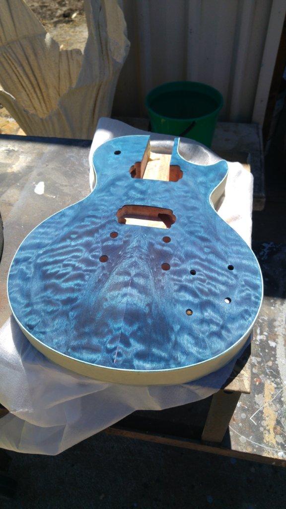

    After a few more coats it turned out like this;
    It's still drying here so it's a bit darker but it hopefully will end up looking something like this when it's clear coated.
    I used U-beaut dyes by the way, if anyone is interested.

    Sounds familiair; I had the some issues with my build and I only could mask the gluespots by using undiluted balck stampink on those spots. See my sig for the build.
    Nevertheless you are doing very well
    Another way would be to very carefully scrape the glue line and fill with a mix of natural timber mate and the stain colour. Too much filler equals too much sanding so only a small concentrated amount should do the trick.
