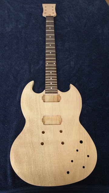

    Ok so I have a SGM-1 kit sat waiting for me to start, all mahogany
    I am thinking of doing the coil switching stuff on the humbuckers and using push / push pots, the attached diagram shows these on the volume pots and all pots being Alpha ones...
    Am I going the right way? .. the diagram right?... not even really sure why I am attempting this but putting it down to my learning curve.
    Edit, the damn work computer won't let me attach the diagram, will upload it when home...

    Views welcome on the wiring.... benefits and also negatives of doing it...
