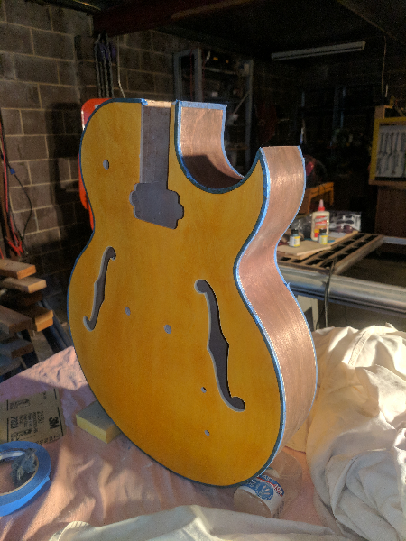

    Spent last weekend sanding & sanding. Turned out it still wasn't enough!
    This weekend I started adding some colour, the pics are early on, it's looking better now. I used UBeaut water based stain for the front & back & Feast Watson jarrah for the sides & neck. The water based dye is very forgiving but it does raise the grain a bit. I found it wasn't a good idea to follow the instructions to wet the surface first, it pulled the grain too much. It worked much better to add the dye to a dry surface in sparing amounts & really work it in.
    I was a bit disappointed when I first added some colour to the neck, the 2 different types of wood either side of the skarfe joint absorbed dye at wildly differing rates making the joint really obvious. I always intended going really dark so after a few more coats it doesn't look so bad now.
    I'll leave the dye to dry for a few days now before glueing the neck to the body. I'm thinking of using tung oil for the final finish, i've used it on some cigar box project & liked it. Has anyone else used it?

    Hi Johnny..that looks really good and oil finish will give the body a lovely silky look. I love the Jarrah on the sides, the colour is amazing like satin! Great job

    Hi Juanitasanch,
    It's true confession time! The colour was meant to be jarrah, I went to the big green shed and picked a bottle from the jarrah shelf, took it home & slapped on the guitar & after a couple of days noticed that I had actually bought a colour called Brown Japan. Probably a fortuitous mistake as jarrah would have been too red & I wouldn't have got the same contrast. Thanks for the kind remarks.

    Great contrast. Nice looking all over.
    Yeah I have also found it difficult to keep things even doing a stain. Putting a clear on really does change things though and it ends up looking fine.
