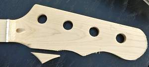

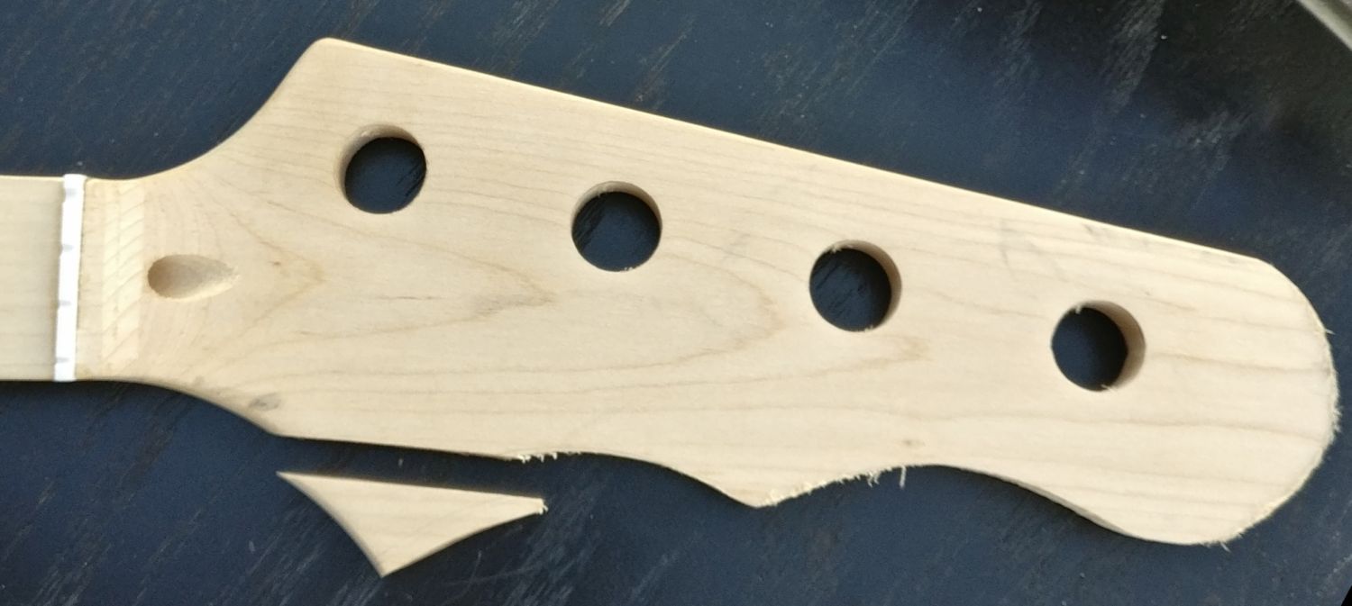

    I have the single bearing version that I was using with on a router table when this happened:
    I did an initial cut with a jigsaw and was cutting away the excess with the template stuck to the bottom of the headstock. I was almost done when the bit seems to have caught on the grain and broke off a piece.
    I knew this was a risk, but I might have avoided with a long, dual bearing bit so that I could flip the headstock upside down and go the right direction for the grain of the wood.
    I might also have avoided this by sanding off any rough bits from the jigsaw before trying to use the router, but even doing that, breaks along the grain can happen when routing.

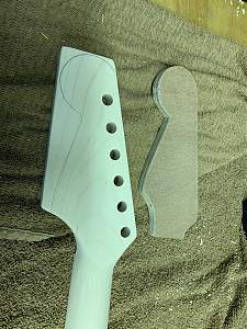

    Actually, I made a template this evening out of ply using a jig saw and about 30 mins of hand sanding. My plan was to use this with the new router.
    It didn't take too long and I was quite happy with the result - so given your advice I might just follow the same process on the headstock.

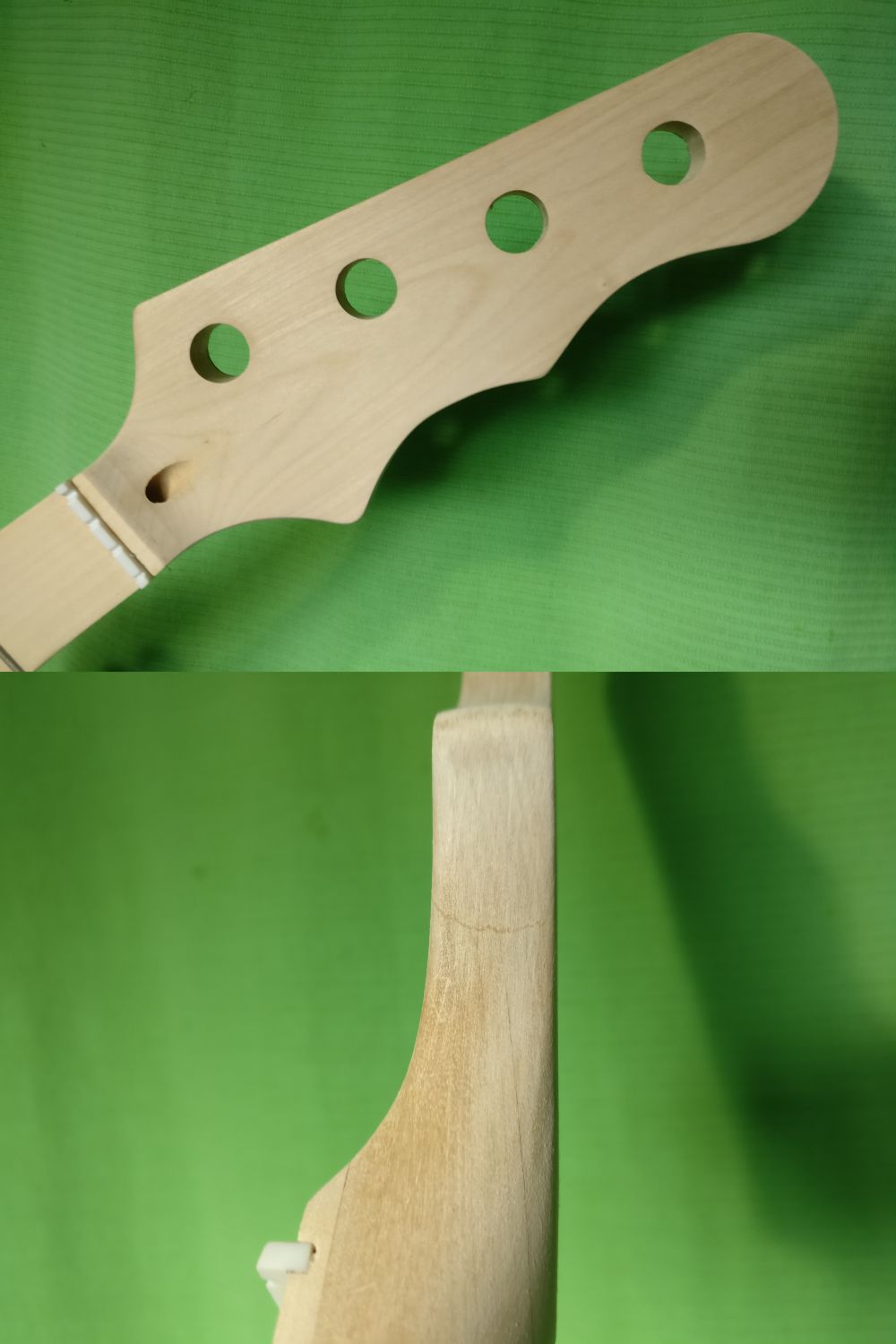

    In my case, it was not too bad to fix. The piece came off clean. It's not in a place that bears any sort of load, and I was able to glue it back without too much fuss.
    From the front or the back you can't see where the two pieces come together without knowing what you are looking for. It's easier to see on the side. Still, it will bear the mark of my sins.
