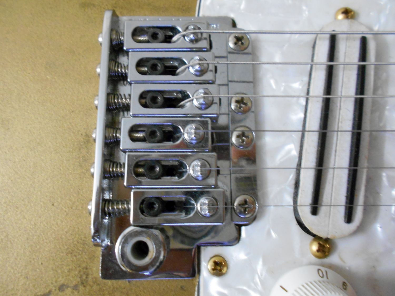

    On the base of the bridge, next to the low E-String saddle it just says Full Contact System TM, I'll see if I can post a pic of it for you.
    Here we go:
Name:	Full Contact System_resized.jpg
    Notice how there's a short piece of metal with four screws in it on the edge of the bridge that's closest to the bridge pickup?, well that is what the front edge of the bridge pivots against, that small piece of metal is fixed to the body of the guitar via the four screws, and it has a V-grove cut into it on the side facing the bridge.
    Apart from that, it appears to function just like a standard Strat bridge.

    On the Full Contact Bridge installed on my Gold Strat, there's a set of six threaded screws on each string saddle with a small V-notch that the strings sit in, to adjust the individual string height, you simply rotate the small threaded screws one way or the other, each string saddle also has a small grub screw used to lock the string-height adjustments in place, not only that, there are another set of 6 grub screws to lock the string saddles in place after the individual string-intonation has been set as well as six screws for adjusting the intonation, pretty involved, but actually not that hard to set up, about the same as a traditional Strat bridge.
