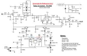

    As far as I can determine, the circuitry on the TS-808's PCB that's responsible for turning on/off the two Fets (Field Effect Transistor) that do the footswitching, appears to be working okay, I verified this by using my signal-generator set to put out a square-wave at about 10Hz, when I applied the signal to one side of the two terminals of the mechanical footswitch, the indicator led blinked on and off, so, my conclusion is that either the mechanical footswitch has dirty intermittent contacts, or, something related to it is causing the pedal to footswitch intermittently.
    Here's a schematic for the TS-808 that I found on the internet:

    In the schematic there are two resistors (a 62k and a 22k) connected in series going from V+ to circuit-ground, there's also another resistor (a 1M) connected to the junction between the 62k resistor and the 22k resistor, the 1M resistor is connected via a 22 Ohm resistor to one of the contacts on the mechanical footswitch, I think the cause of the intermittent footswitching has to be somewhere around this part of the circuitry.
    Note: The two Fets in the schematic are the components marked 2SK30A.
    The two 2SK30A Fets are being used as electronically controlled switches, and these route the input signal either straight-through to the output, or through the two Op-Amps (the two triangular shapes), when the mechanical footswitch is stomped-on, one of the 2SK30A Fets turns on and the other turns off.
    Update:
    I was just doing some more work on my Ibanez TS808 pedal and I think I have finally cracked it this time round, in the schematic I posted, there is a small value capacitor (1000pf) going from one end of a 22 Ohm resistor to circuit ground, in my pedal it is a 10,000pF (10nF) ceramic capacitor, which appears to be the cause of the footswitching issue I've been experiencing, what I believe is going on with the capacitor is that it has gone leaky, but to detect it I had to set my digital multimeter to it's highest resistance range, I compared it with another known good 10nF cap (a yellow polypropylene type) and got very different results, so I tried using the yellow 10nF cap as a replacement, and now the pedal seems to reliably footswitching again like it's supposed to, I'll give it some soak-testing for some time just to be sure that I have finally fixed it for good now.

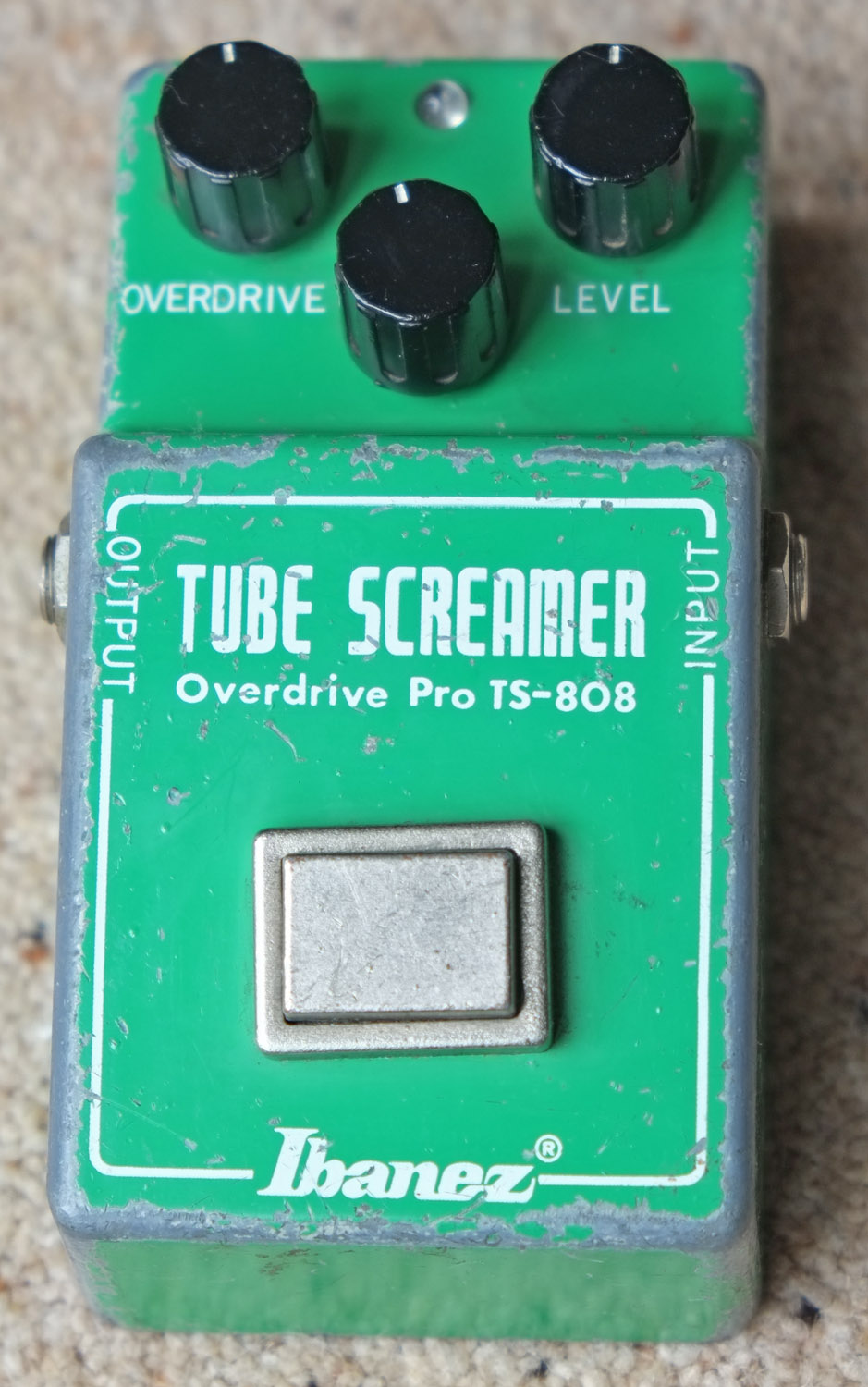

    Is yours an original model or a re-issue? I've had mine since I bought it in 1980 and it's still working fine, though the pots are a bit scratchy and needs fairly regular doses of cleaner.

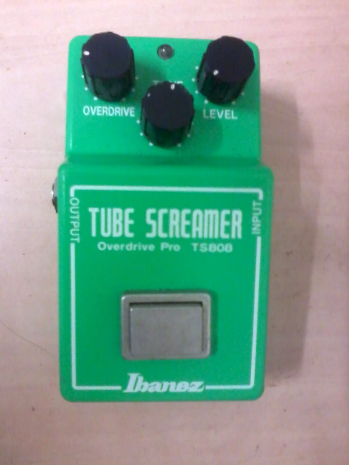

    Mine's actually a later re-issue, probably circa 2015 or so, I bought it last year from the Top End Sounds pro music shop, I have another pedal that needs some servicing work done on it to get it working again, it's my Boss Compressor/Sustainer, for some reason it doesn't seem to work at all, I'll need to find a schematic diagram for it and then do some tests on it.
    Now that I think I've finally got my TS-808 working properly, I'm going to do one mod to it, which is to swap out the stock red indicator led for a blue one, the red one is a bit too dim for my tastes, should be a fairly straightforward mod to do.
    Here's a pic of my TS-808 pedal:
