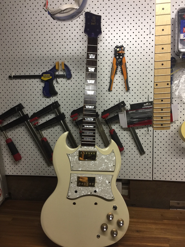

    This is Lilou, named for my eldest Lillian.
    I've actually been really enjoying this one so much I'm feeling guilty for neglecting the TL-1 even though I'm doing them together.
    I've secretly always wanted a SG since I played with one in a shop with one of my band mates when I was a uni student and had no hope of affording it. I've never come across a guitar with such a smooth action since and regret not spending every last cent I had to buy at the time.
    As you can see, I've been a bit slack with the pick guard, I found a full guard in pearlesent white but it was for a Gibson rather than Epihone so it was too short. Rather than try to cut my own from a blank, I've cut it in half. It probably looks a bit sacrilegious to the hard core Gibson fans, but I'm building it to be played, not sold.
    I've ordered Gotoh machine heads and a Babicz bridge, as I've been battling with the concept of this ending out being a bit of a silk purse out of a sow's ear seeing as it's my first build. I figure if it's not so brilliant finished, I can always swap them onto my Maton.
    The pickups are Tonerider AC4s in gold.
    Oh, gluing the neck on was very stressful, how I wish I'd gone for a bolt on kit, but thankfully it seems straight for now.

    The pickgiard seems a bit off indeed... And gluing the neck in is always stressful! Good that it worked out perfect!
    Quote Originally Posted by Kick View Post
    I have to agree there...except for the 'a bit'.
    As a lifelong 'bodge' aficionado, that's just a step too far.
    Better to extend the bridge pickup rout to bring them closer or just get a correctly fitting scratch-plate.
    cheers, Mark.
    Make a cardboard template and send it off to Pablo Pepper here on the forum, he makes great pick guards.

    Cheers guys. advice noted. I've ordered some blank pick guard sheet and I'll make a template on my next day off.
