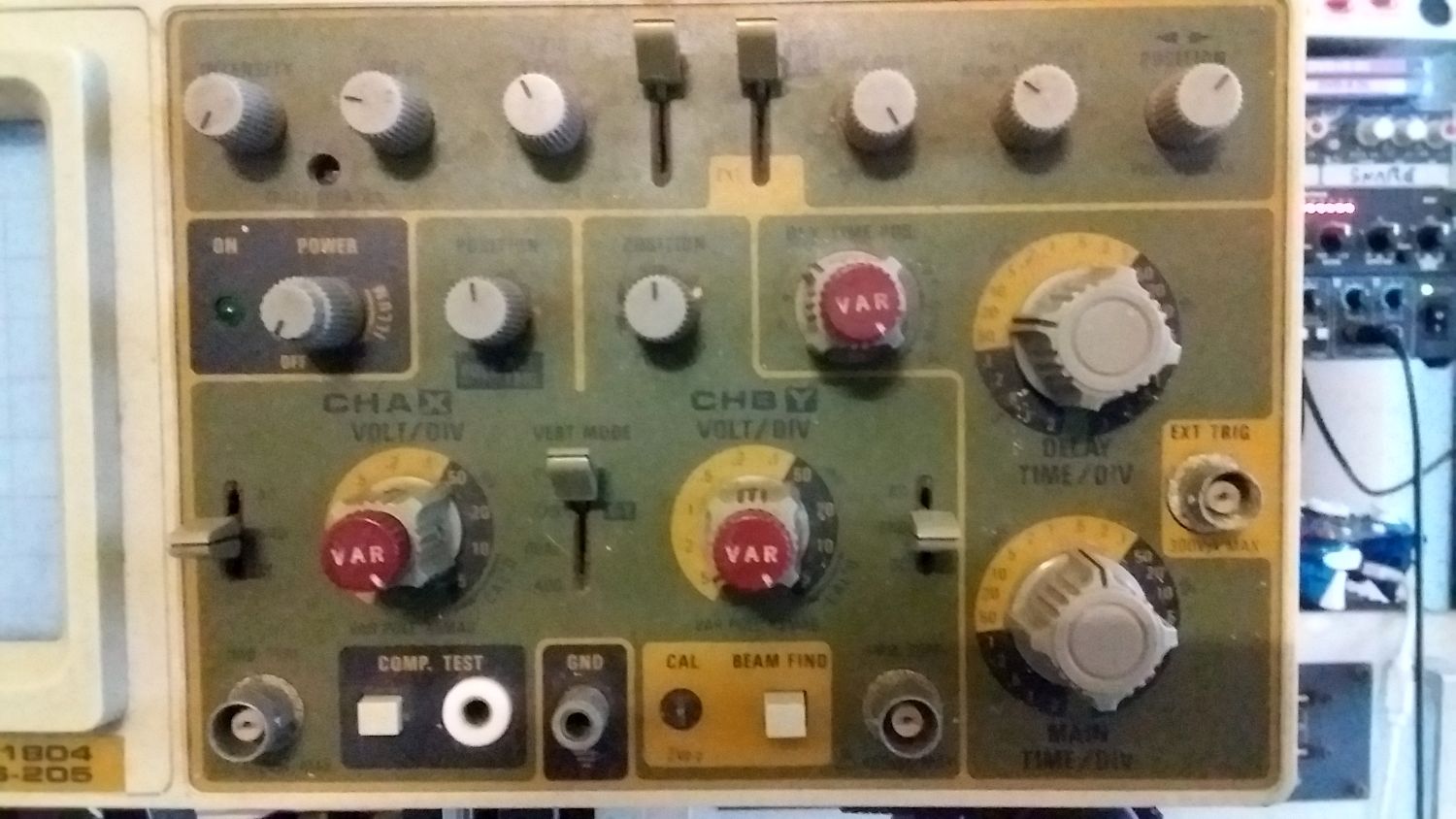

    To start with, here's a pic I took of the front-panel of my old DSE Q-1804 20Mhz Dual-Trace Oscilloscope, I have had this Oscilloscope since about 1998, or so:
Name:	DSE Scope 1_resized.jpg

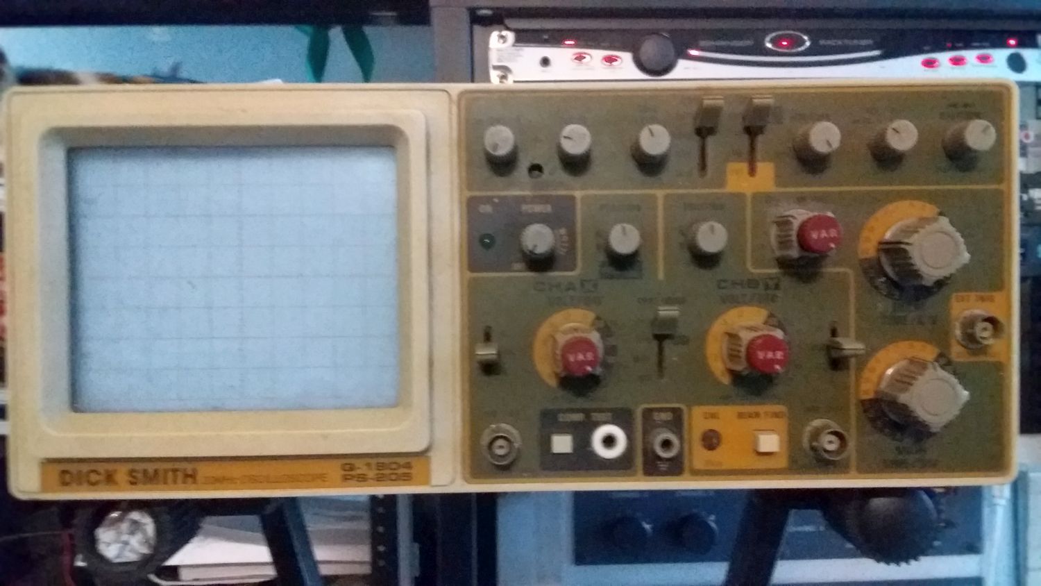

    Here's a close-up pic of the Oscilloscope's controls:
Name:	DSE Scope 2_resized.jpg
    It's actually not as intimidating as it looks....
    Starting at the top row, and going from left to right....
    Intensity.....This controls how bright the display is.
    Focus...This is used to focus the trace to a thin line across the cathode-ray screen.
    Trigger Level....This control is used to adjust the triggering-level so that you can get a stable display on the screen.
    Coupling....This controls the trigger coupling, most of the time I usually have it set to either Normal, or Auto.
    Source....This controls where the Oscilloscope gets it's trigger signal from...Ch-A, Ch-B, Line, or External.
    Holdoff....This control is used to help stabilize the display.
    Mode....This control is used to put the Oscilloscope into different modes....Main, Mix, Delay, and X/Y.
    Position.....This control is used to position the display horizontally left or right, if you pull the knob, that puts it into X10 magnification mode.
    Next row of controls.....
    Power On and Illumination...This is pretty self-explanatory, turns the Scope on or off, there's also an illumination function that illuminates the grid markings (called graticules) on the screen, very handy in low lighting.
    Ch-A Position....This control shifts the Ch-A Trace vertically up and down, it also engages an alternate trigger function when the knob is pulled.
    Ch-B Position.....Same as for Ch-A except that it controls the positioning of the Ch-B trace, does not have the alternate trigger function.
    Delay Time Position....Controls the position of the delayed Trace.
    Delay Time/Div.....Controls the delay time per division sensitivity.
    Ch-A Coupling....This controls the Ch-A coupling....AC, Gnd (Ground), DC.
    Ch-A Volts/Div......This controls the sensitivity of Ch-A.
    Vertical Mode....This controls the vertical mode of the Scope.....Ch-A, Ch-B/X-Y, Dual, and Add.
    Ch-B Volts/Div....Same as for Ch-A, but for Ch-B.
    Ch-B coupling....Same as for Ch-A.
    Ext. Trigger.....This is an external input for a trigger signal, useful for when doing frequency response tests of a circuit.
    Bottom row.....
    Ch-A Input....Self-explanatory.
    Component Test....This can be used to test some electronic components, like resistors, caps, diodes, and transistors.
    Gnd.....This is a simple grounding-point.
    Cal/Beam Find.....The Cal terminal puts-out a 2Vpp Square Wave signal that is used to calibrate Oscilloscope probes that are switched to X10......Beam Find is used to find where the trace is if it is off-screen.
    Ch-B Input....Self-explanatory.
    Main Time/Div.....This sets the main Timebase for the onscreen display, each horizontal cm graticule corresponds to the Main Time/Div. setting.

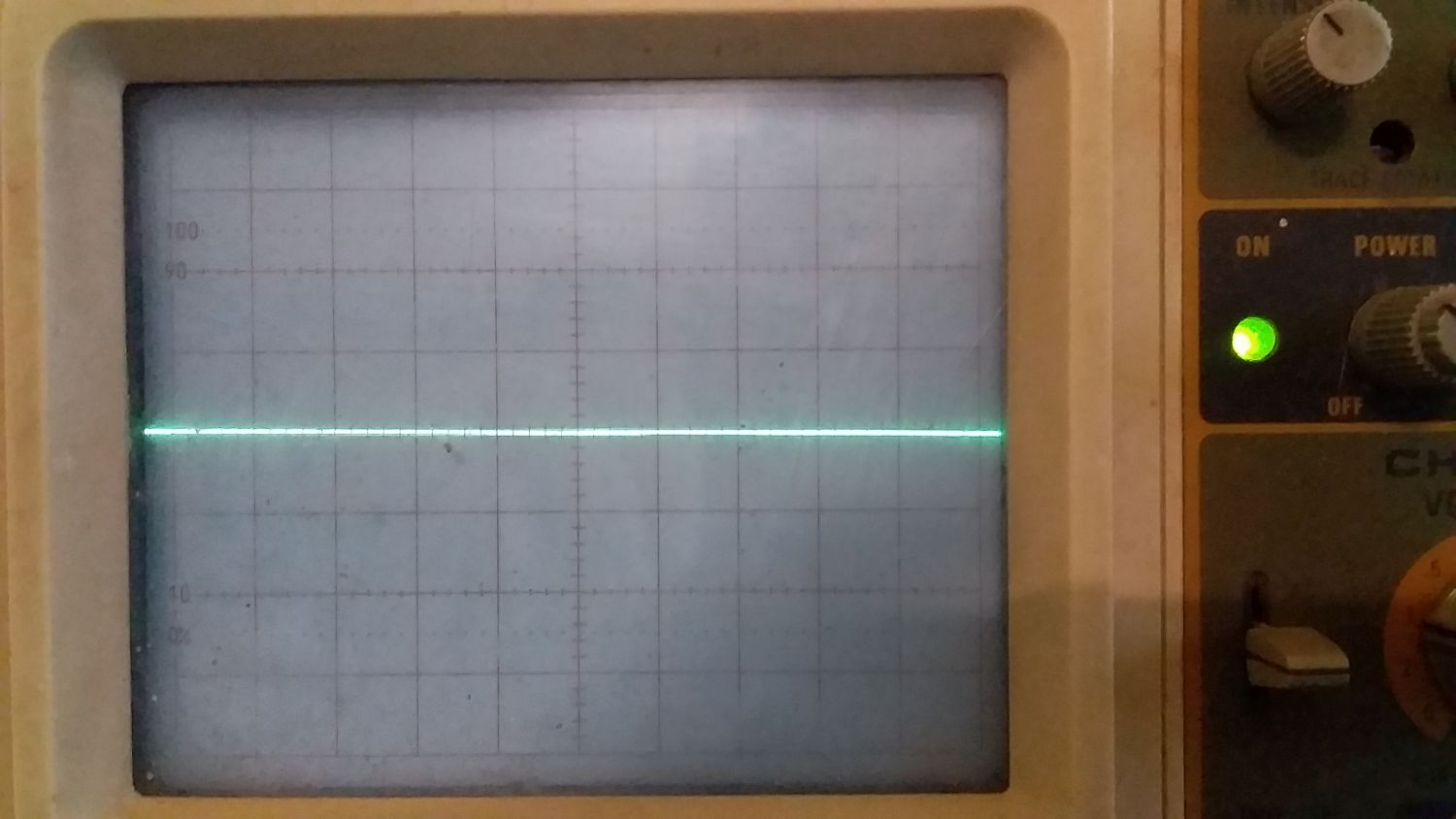

    After letting the Scope warm-up for maybe 5 minutes, adjust the Intensity, Focus, Trace Horizontal Position, and Trace Vertical Position controls till you see a thin horizontal line going across the Scope's screen roughly about midway, as shown in this screenshot:
Name:	Scope_Focused Trace_resized.jpg
    You might need to set the main Time/Div. control on your Scope to something like 2ms or 1ms/Div to get the thin line if you see a small bright dot moving from left to right.
    Note: Make sure that the input coupling switch is set to Gnd while you're adjusting the trace so you see a thin line.

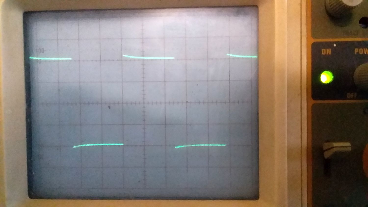

    To adjust the X10 mode compensation for the probe, connect the tip of the probe to the Cal terminal, and the probe's grounding lead to the ground point, then switch the X1/X10 switch on the probe to X10, and the Input coupling switch to either AC, or DC, then find the little adjustment tool that came with your Scope probe, next, find the little adjustment hole on your Scope probe, it'll either be on the probe itself, as in my case, or it'll be on the plug that connects to the Scope's input, then you use the adjustment tool to adjust the probe's compensation till you get a nicely-shaped square-wave displayed on the Scope's screen, you might see the following on the Screen:
Name:	Probe Under Compensated_resized.jpg
    Although it looks like we are seeing a square wave signal being displayed, notice how the top and bottom of the signal aren't quite straight?, this indicates that the probe is under-compensated, we need to adjust the compensation so that the top and bottom are straight and the corners are sharp 90 degree angles.

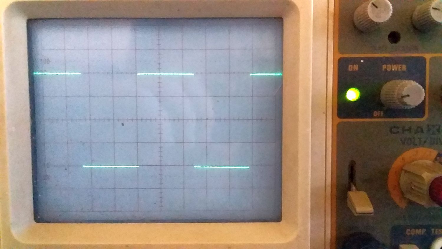

    This is what you should be seeing once the X10 compensation on the probe has been properly set:
Name:	Probe Properly Compensated_resized.jpg
    Once you have the X10 compensation for one probe properly set, do the same for the other probe, if you're using one probe with a single-trace Oscilloscope, you're finished with setting the compensation and your Scope is ready for use.

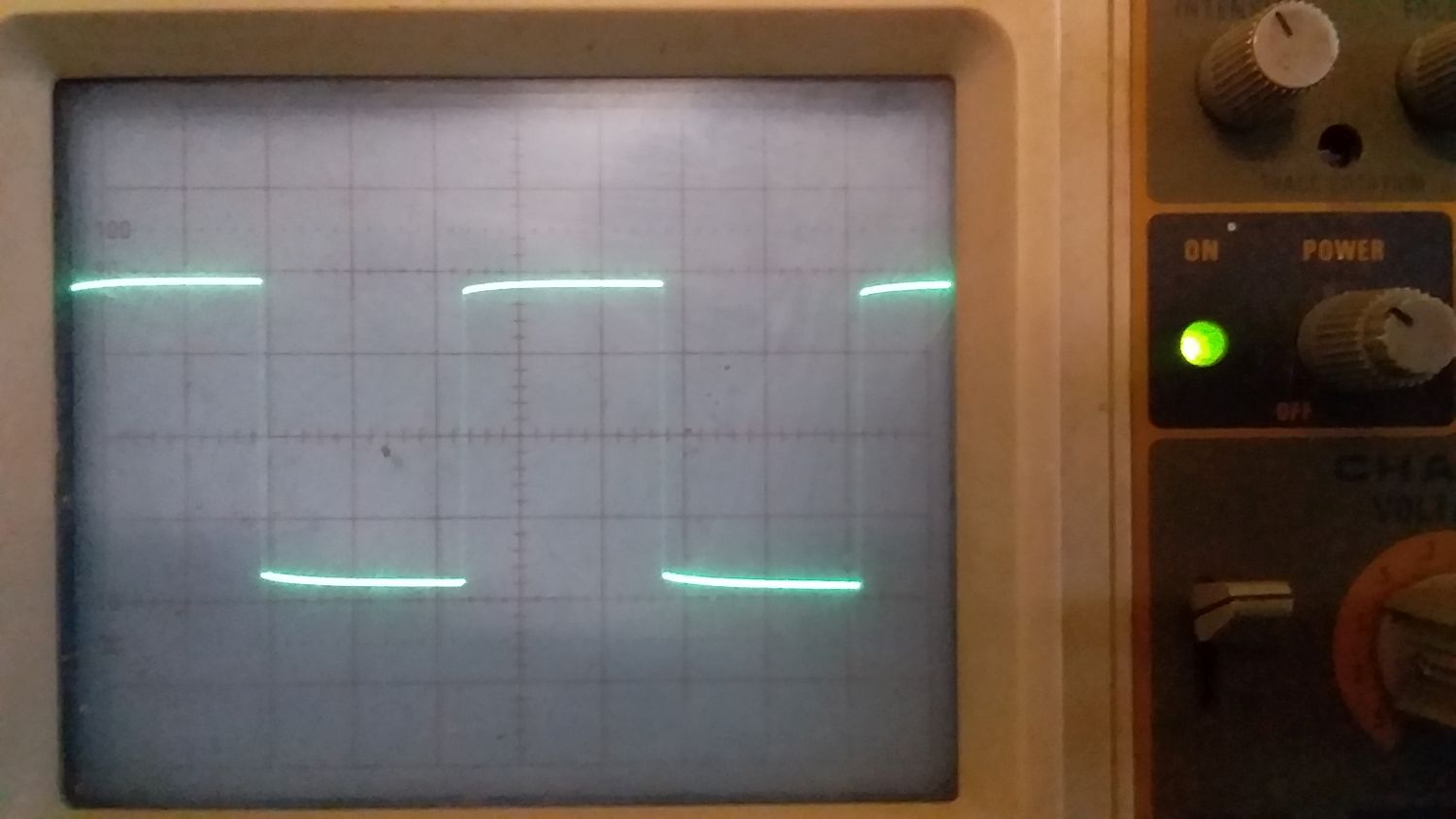

    You might also see this on your Oscilloscope's screen:
Name:	Probe Over Compensated_resized.jpg
    Notice how the top and bottom of the square wave signal are bent inwards?, this indicates that the probe is over-compensated and it needs to be adjusted so that the top and bottom are straight.
