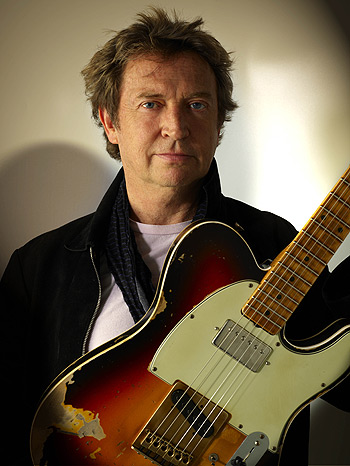

    Out of all of this it looks like the closest example is Andy Summer's Signature Deluxe, apart from the semi hollow body and bigby.
