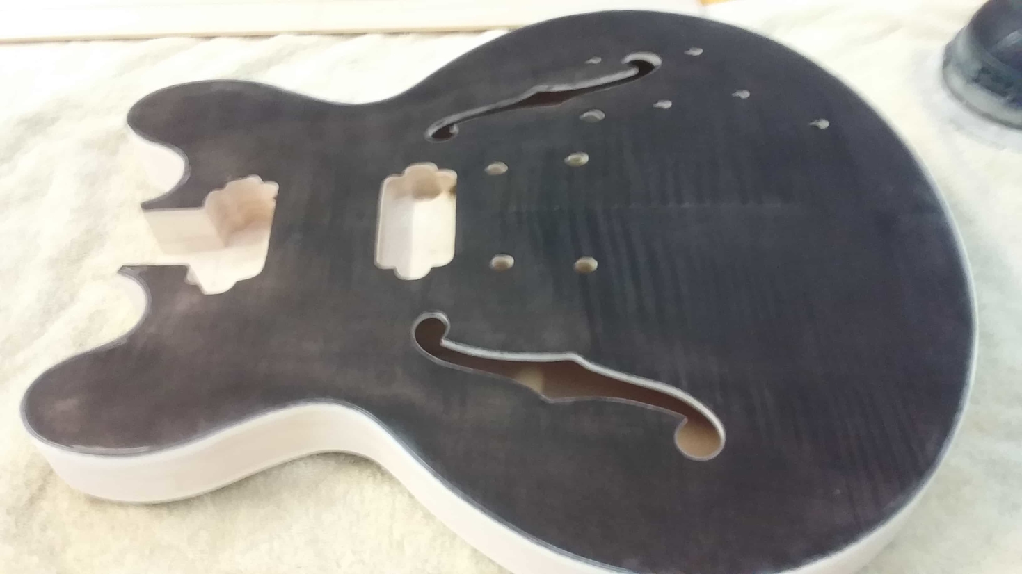

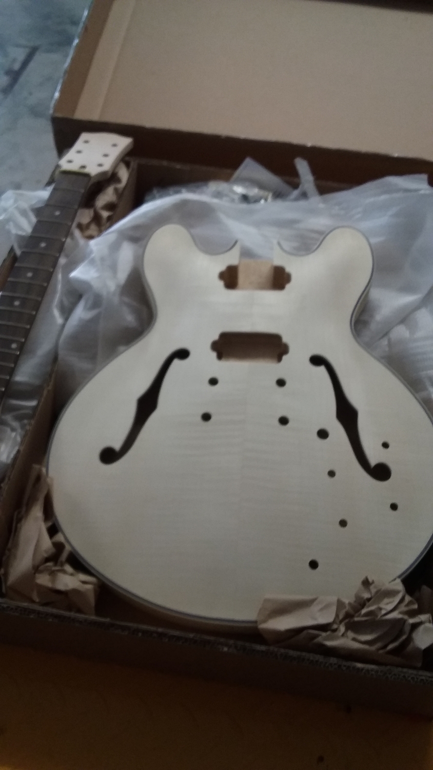

    Hi everyone. Got my first kit that I have started , so I thought I might break the ice by showing a few pics. Not actually my first build as such though. I purchased a 2nd hand guitar some months ago and stripped it, replaced most of the components, got it painted and reassembled it. Cheers.Click image for larger version.
ID:	23391the unboxingClick image for larger version.

ID:	23392colouring/dying the frontClick image for larger version.

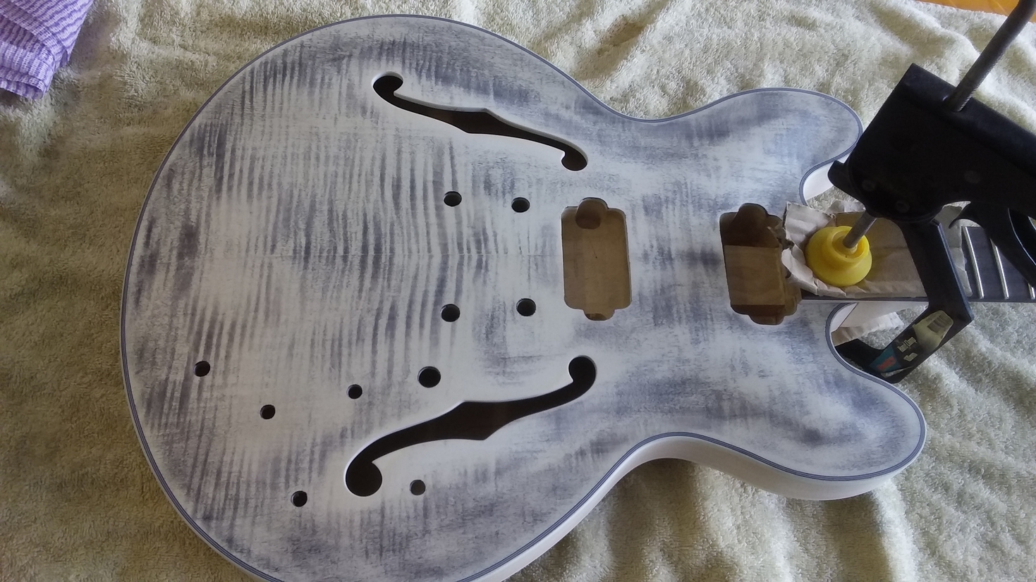

ID:	23393after sanding and setting the neck

    Nice grain showing through. What colour is the stain, looks to have a purple tinge to it, nice.

    Yeah Nitro it does have a purple look too. I used Rit black clothing dye.

    Hi Ozo, looking good. Looks like you have oversanded some of the dye so you will lose a bit of the lovely flame. Looks like you used an orbital sander. If you have the patience I would rub more black dye over to pop more of the flame, then carefully sand back with a sanding block, then apply your stain colour.
    You can see the areas around the F holes and some patches are back to bare timber

    Yeah that's correct Wokka, decided to have some highlights here and there. Cheers Steve
