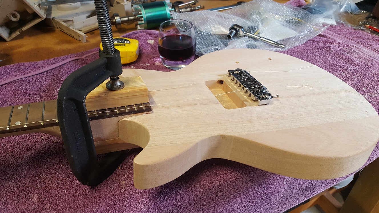

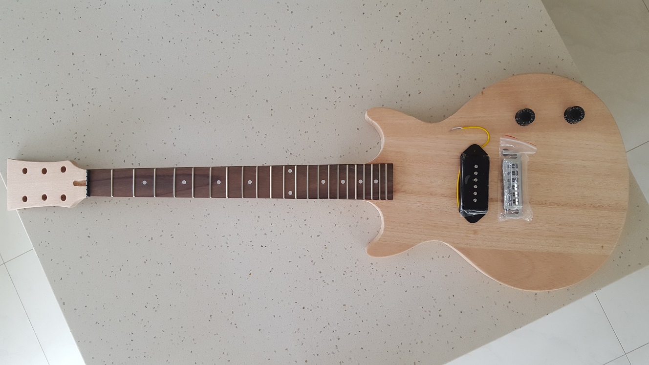

    Simple but interesting JRM-1DC kit arrived this week, found time to start today. Unlike some others I like to set the neck first and this being my 3rd set neck am now comfortable with what previously was a stressful job. Today I spiced the job up by having two glasses of red BEFORE I started, possible contribution to my comfortable approach :-) Not a lot more to say now as she sits waiting for the glue to dry.

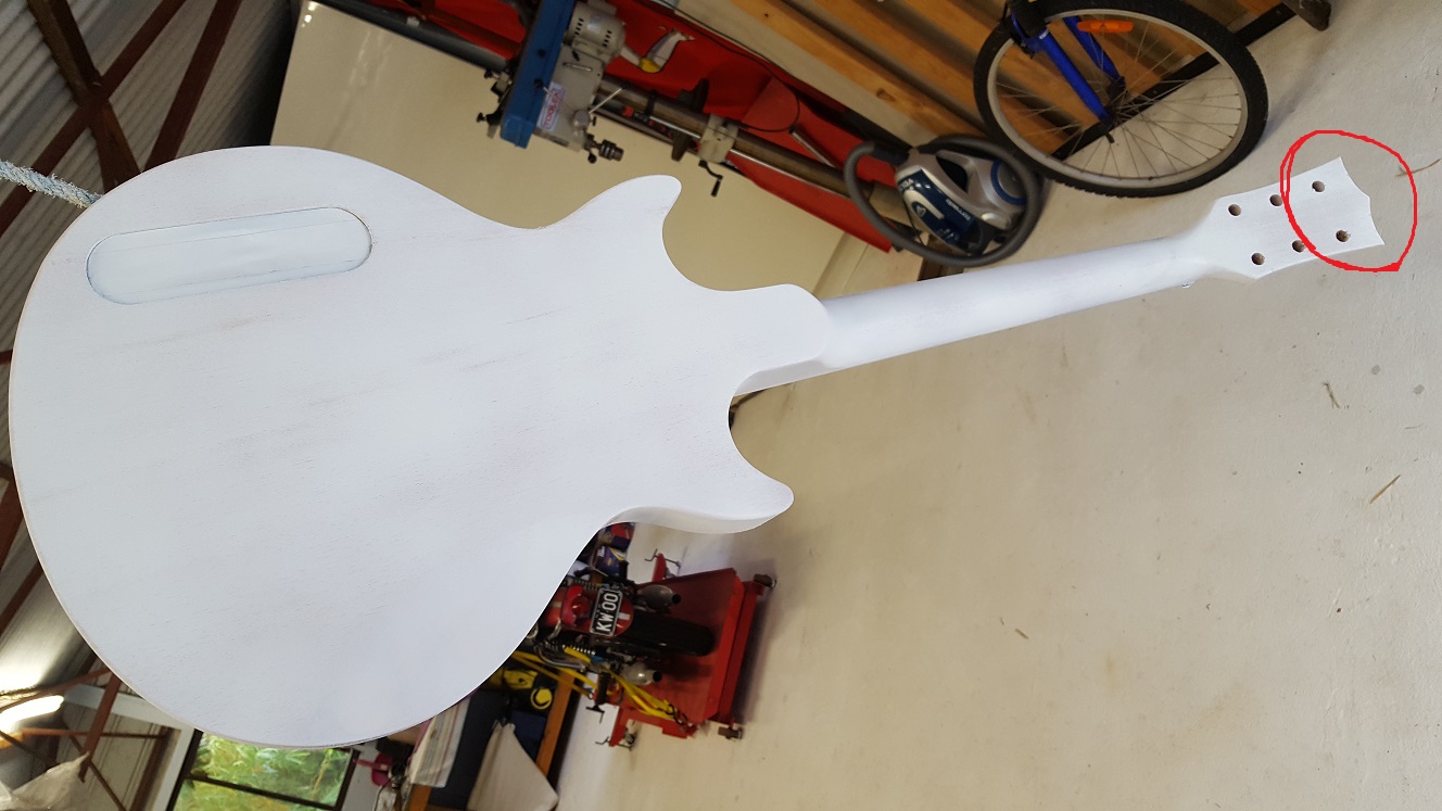

    At it again today, cut the headstock shape, ATT intend doing the same as recent resonator project (second photo).

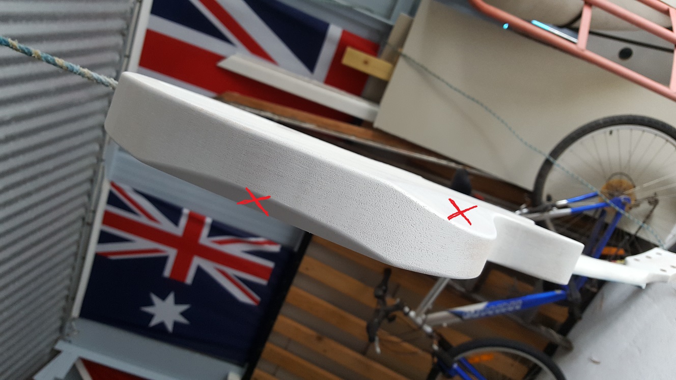

    Created relief for right arm and spreading middle bit :-(

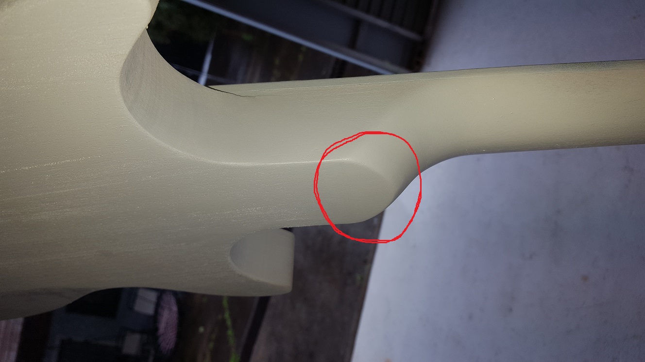

    Yesterday filled the step at neck to body joint.
    Finally put a light coat of seal / primer onto the "fluffy" timber.
    Going to do most of the before paint finish prep after it's primed, the grain just keeps standing up, I'll fix that :-)

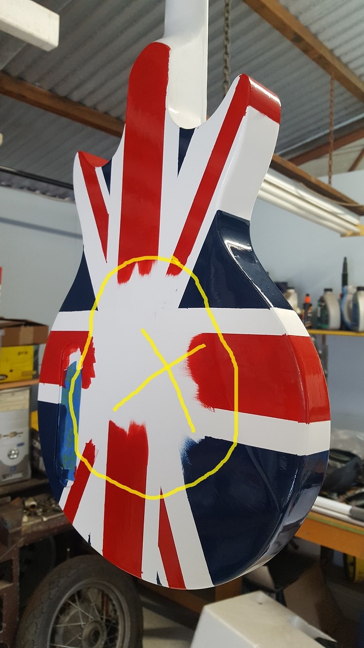

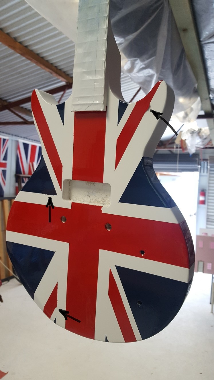

    Got it smooth after 5 coats of white.
    Some colour today.
    In about a week I'll use a blade to clean the mess up, lots of wet and dry and 8 or 10 coats of poly.
    After sanding and before the poly I'll do something with the headstock.
    Will sand a lot of colour off the back and fade into the white centre then put a feature of some kind in the middle.
