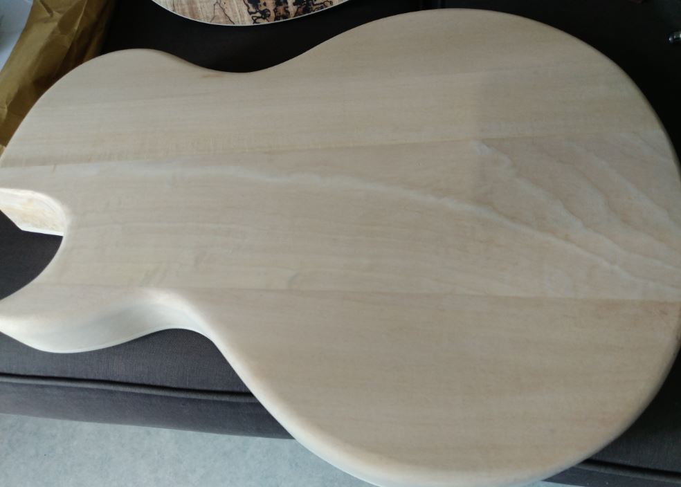

    My ES-2V arrived today and thus it's time to stop lurking and post some pics!

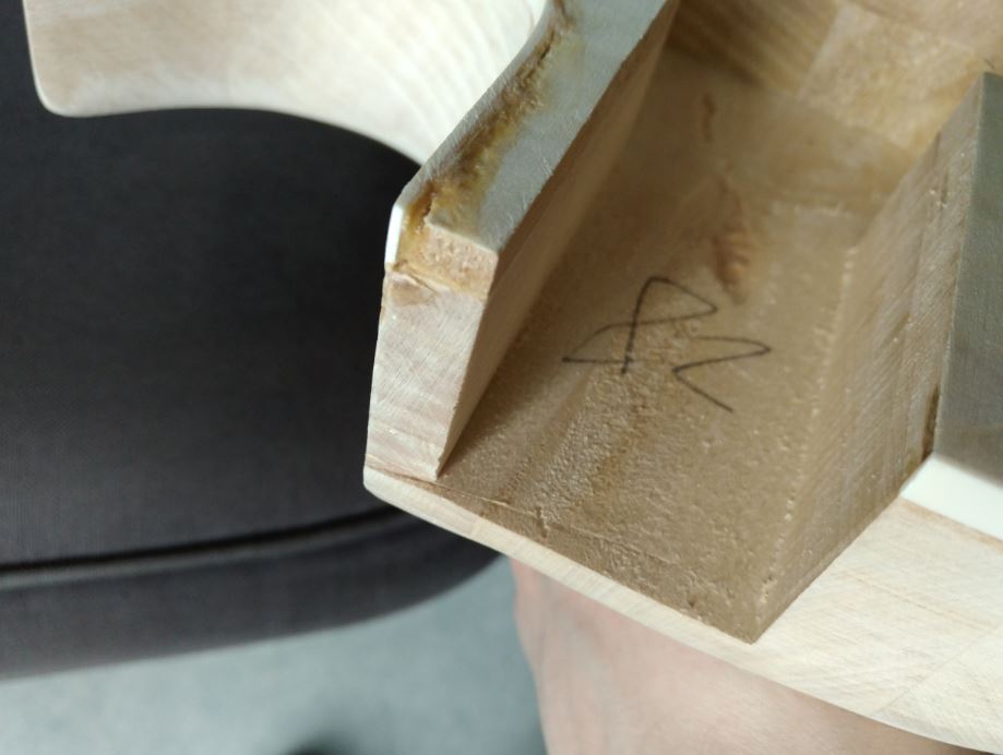

    The figure is great and thank god there isn't too many glue stains on the veneer. There is this big problem with the binding next to the neck joint. I'm thinking that maybe I'll use some wood filler. Any ideas?
    I'm quite inexperinced with woodworking so bear with me

    More pics and thoughts:
    The good thing is that most of the glue thing disappears under the fretboard.

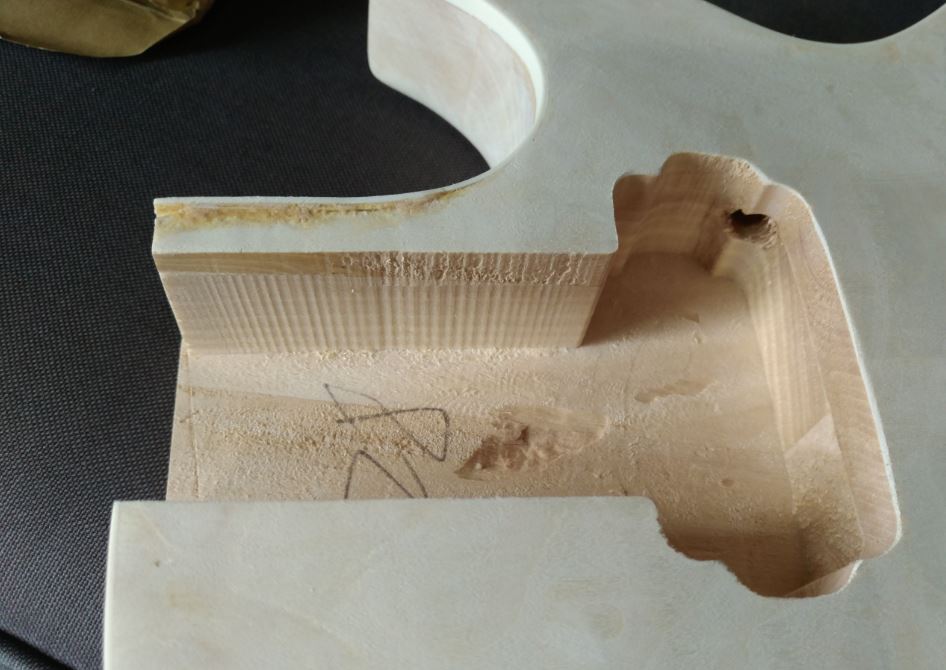

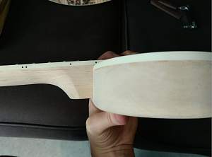

    The angle of the neck is wrong so some sanding there...

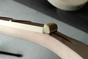

    The nut is horrible but that's to be expected

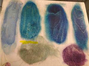

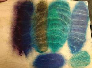

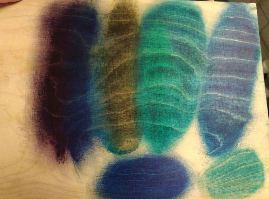

    I played with some colors and the goal is to get this ocean like blue. I didn't manage to get quite the color I had in mind. Either the blue was too deep or it had too much green in it. I'm using oil based stuff so that the grain of the wood won't rise up and thus need sanding (which I thought could be problematic with a veneer). Here are some of my experiments:

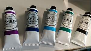

    The underlined color is probably closest to my vision. I guess it was about 1 part phthalo blue and 7 parts of manganese blue hue. I used Gamblin's artist grade stuff, linseed oil for diluting and some terebine driers to help it dry and seal the color.

    Hi and welcome to the forum!
    That neck are gap will be covered up by the neck once it's glued on, so I wouldn't worry too much about it. Fill it and sand it flat, but don't worry too much about it. My ES-3 kit is a bit like that.
    I wouldn't assume the neck angle is wrong as the bridge is quite tall. I'd clamp the neck in place (if you haven't got any suitable clamps, then you need to buy or borrow at least one to allow you to glue the neck in place), then run a straight edge along the neck and out over the body so you can see what height the bridge has to be to hit the straight edge. The actual bridge height will need to be about 3mm higher than this. If the bridge is going to have to be set really high, then yes you'll need to adjust the neck angle, but they don't often get the neck angles wrong.
    Yes, that's a very badly glued nut. But that's easy to remove and re-glue in the correct place, though an upgrade to a bone nut is well worth it.

    I investigated the neck angle more thoroughly and my judgement was premature.

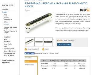

    About the bridge situation in general I'm planning to use a tailpece tune-o-matic combo. Maybe something like this https://www.allparts.uk.com/products...-1-2-inch-long and
    https://www.allparts.uk.com/products...-6mm-post-hole. The specs are quite sparse and the adjustable height is unknown. On the other hand I have never encountered a guitar where the bridge's height adjustment would be a problem so I quess I don't have to worry too much about that as long as I buy a model which is used on hollow bodies.
